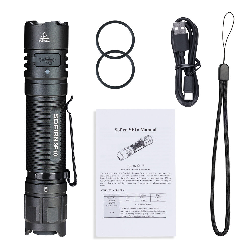

I found Sofirn SF16-UV on Lazada (Thai/Chinese Amazon of sorts, but without duties) for 1000 THB with a battery included.

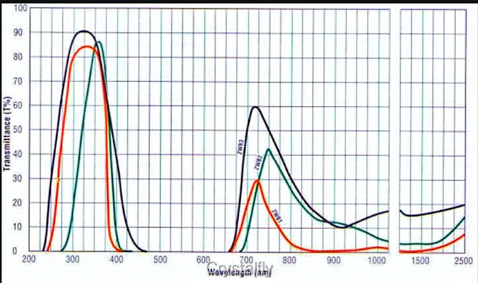

“Note that if you’re trying to reproduce the effect in a laboratory, the normal UV-A light source used in labs is 365 nm – this wavelength is insufficient because PPIX has almost no absorption around this wavelength. So it’s important to use the ‘cheap’ UV sources (395 to 405 nm) to reproduce the results!”
Which makes me wonder if any of the ZWB filters could work well with 395 nm UV LED. Even ZWB3 would absorb most of the output it seems.
Have anybody ever seen or used or made a filtered light with a non 365 nm LED?
