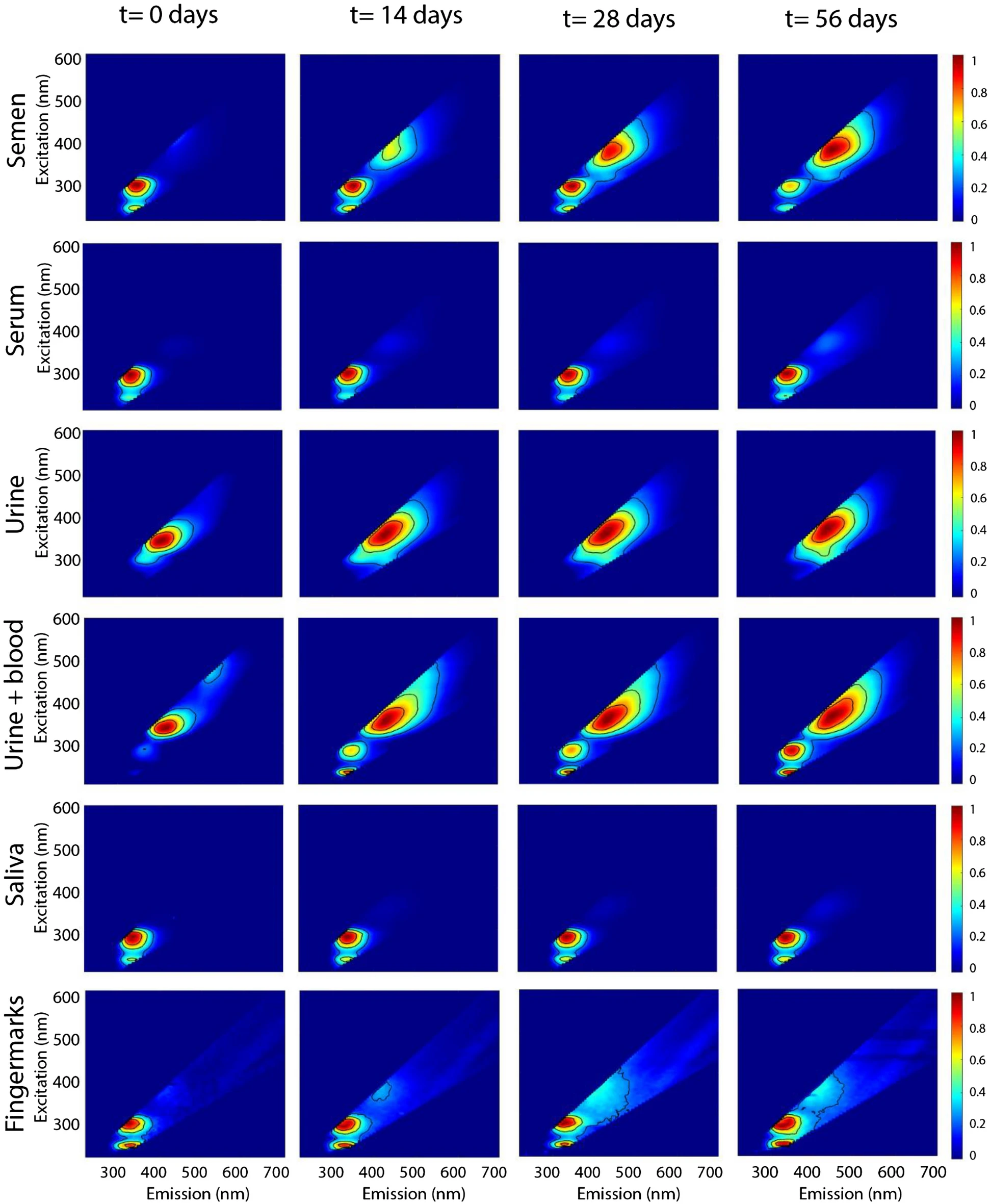

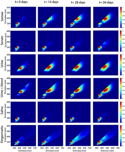

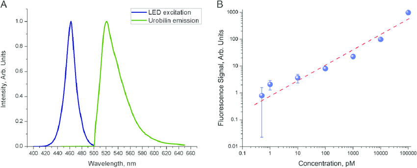

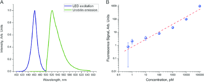

Looks like 365 nm may work:
https://www.researchgate.net/figure/A-Excitation-and-emission-spectrums-for-the-LED-and-urobilin-fluorescence-The-blue_fig2_262076300

Actually, I may be wrong: I just looked at the graph and it seems that the excitation wavelength is longer than that - so I don’t know anymore. From experience, 365 nm does make pee glow, so I don’t know anymore what the story is.
