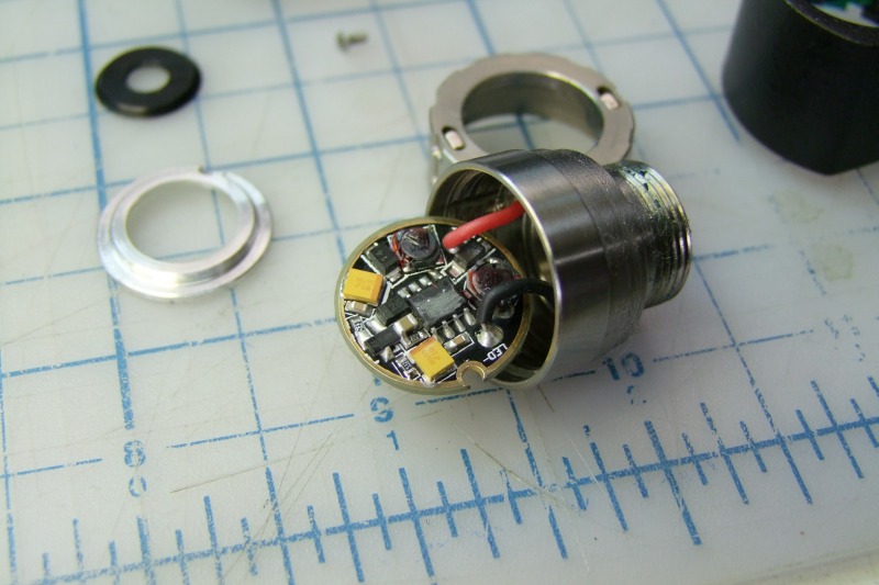

5) Remove the Driver from the head. Unscrew the single retaining screw, and with the parts out, unsolder the led wires from the driver.

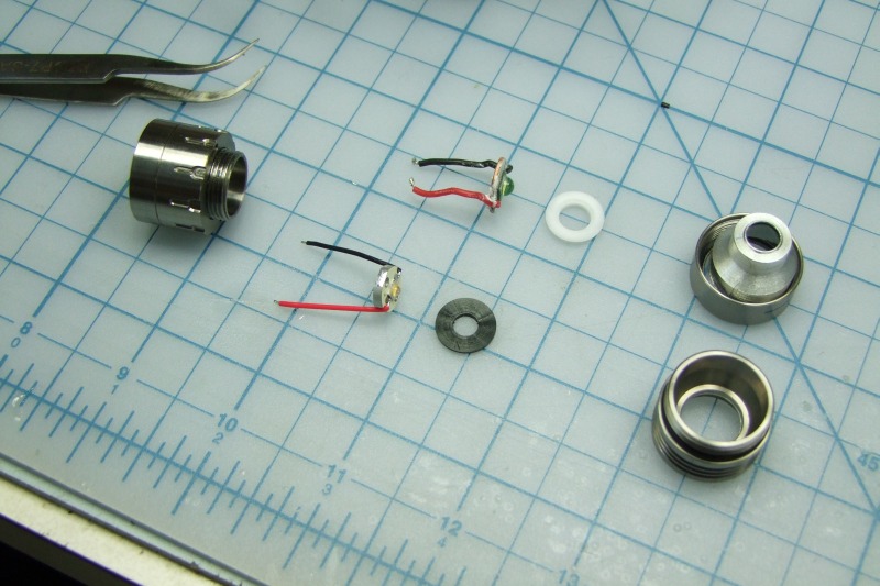

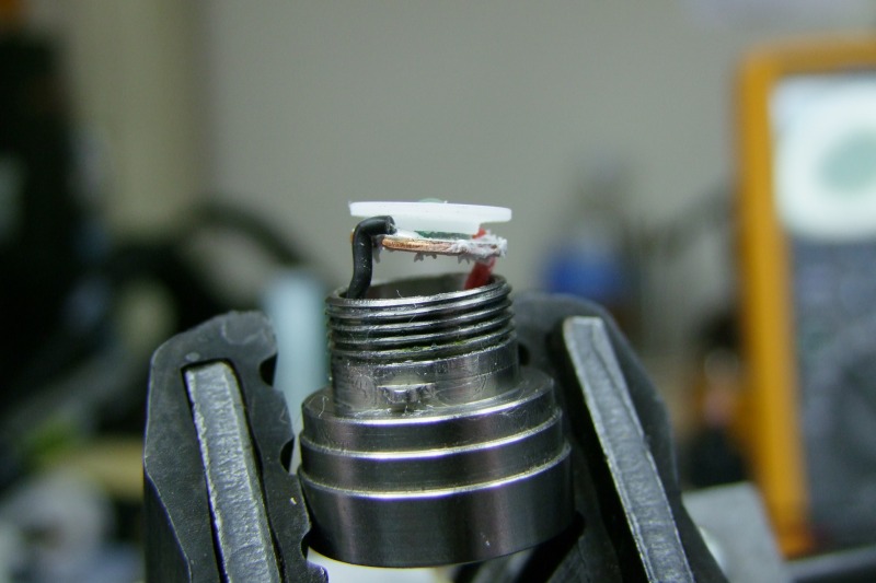

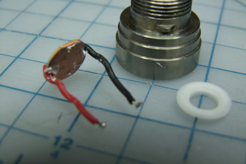

Unsolder this driver to provide more depth, and to allow you to apply heat to the inside if you want to try to soften up the locktite first. Be aware though that more than 60-80 degrees Centigrade will demagnetise your magnets, and make your light susceptible to external magnetic fields changing brightness. (imagine walking around on minimum, putting the light near your magnetic clipped wallet and it goes to max brightness)

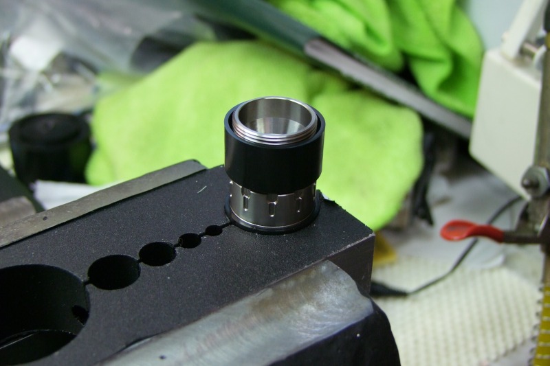

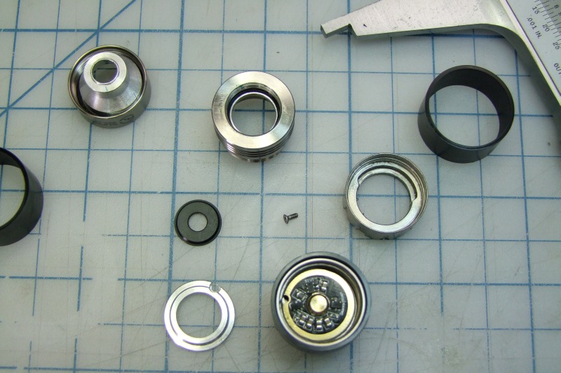

Head is now clamped, with the block. Rubber band is around the heatsink section only. Ring at this stage is still able to turn freely, a good sign of a well balanced and accurately positioned blocks/rubber band. Other thing is to try to have the rubber band centred to the block - it helps to keep the blocks more stable when trying to clamp together.
Clamping the back end of the head. Notice the block isn't quite split down the middle, which allows the larger one to sort of 'clip' onto the head of the torch by itself, which is quite convenient.
Ready for some torquing...

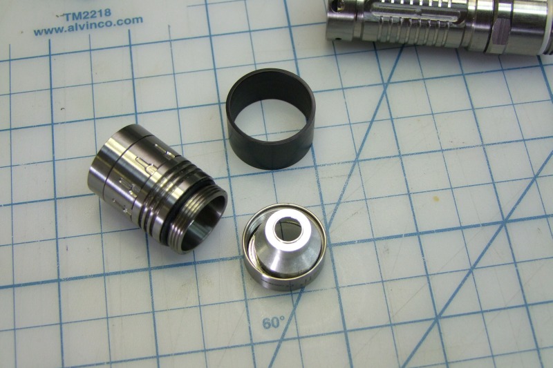

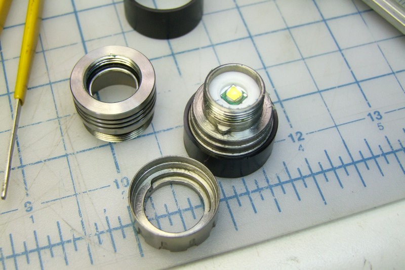

Parts Apart! - notice the wear against the aluminium.. Wouldn't recommend anything softer than aluminium after seeing that.
Lots of locktite crumbs! Try to leave the magnetic ring on the bottom half. This is to preserve the grease. I cannot find any grease of sufficiently high enough viscosity to restore that same feeling. Even the super thick stuff I have feels too light on the control ring, so best thing is to leave it alone.
Also, don't lose those magnets... Polarity is important too. If one comes out, try to re-install it with a non-magnetic tweezer. Polarity is the same direction for both.
