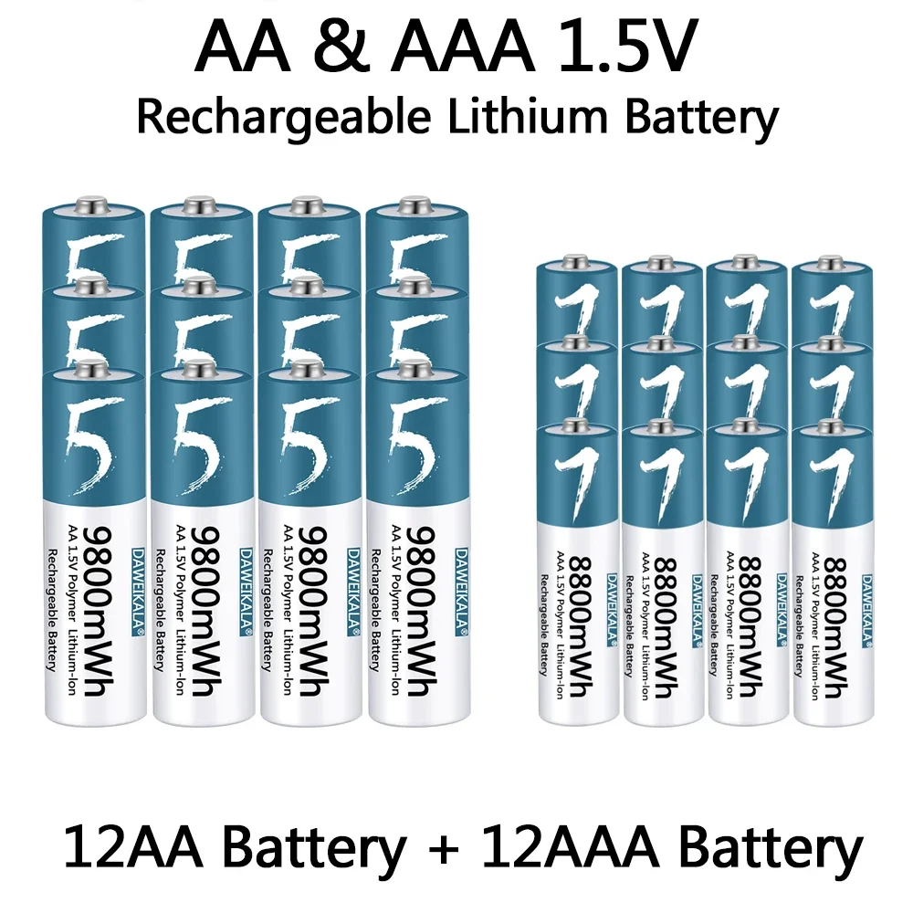

example batteries Li-Ion 1.5v
Xtar VX4 support Li-Ion 1.5v but the current adjustment apply to all slots and can’t adjust the current individually.
Do understand that this have downsides too. Mostly - significant parasitic drain/“self-discharge” from constantly running dc-dc converter and noise said converter generates. Try them first before buying a lot - they are only suitable for a limited number of applications and might not work for yours…
Also nearly 10Wh in AA/14500 (14430) is 100% fake. Do not buy. Maximum you can get before losses in dc-dc converter is ~3-4Wh, after losses - much less. In AAA/10440 it is even worse - ~1Wh at most is realistic.
Yup, high quality LSD NiMH cells, like Eneloops, are still king for most AA/AAA 1.2V uses. :+1:

yes they are various quality and also had to search for them asi the AA/AAA with USB they are some here in EU available , but expensive like 5-6e / pc
Those from Ali i’ve ordered are somehow working, let’s see for how long.
Actually the “stronger” 12800mWh ones are lighter vs weaker ones 8800mWh :smiley:
