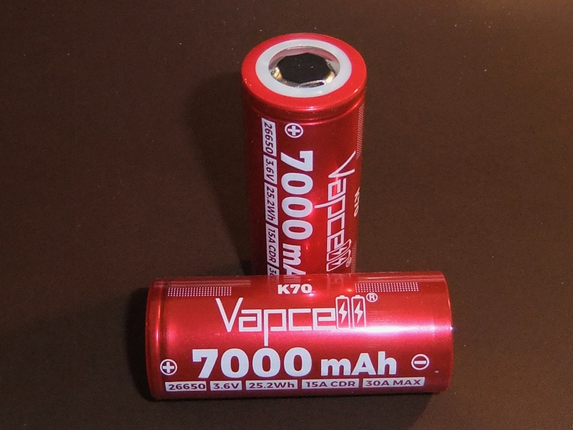

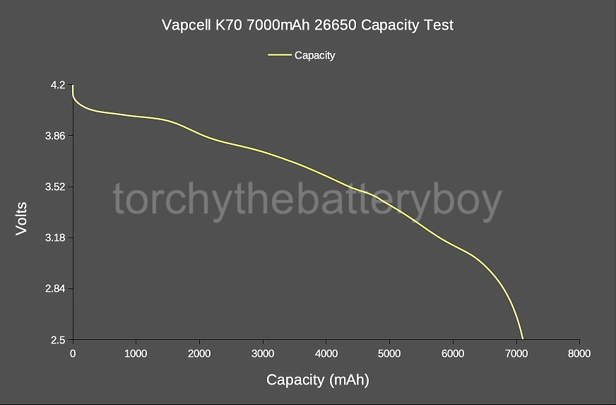

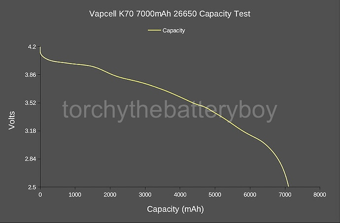

Vapcell K70 26650. Measured capacity 7104mAh. Pretty much spot on as you would expect from Vapcell.

Is the 15A CDR Accurate? Was that tested? Thanks.
What analyzer did you use to measure the capacity?
I haven’t got around to testing the current rating. Tested on a BK Precision 8601.
It is very expensive device!
Unfortunately. But if you want to do accurate testing, you need equipment that’s fit for purpose.
Thst beats the 26800!
