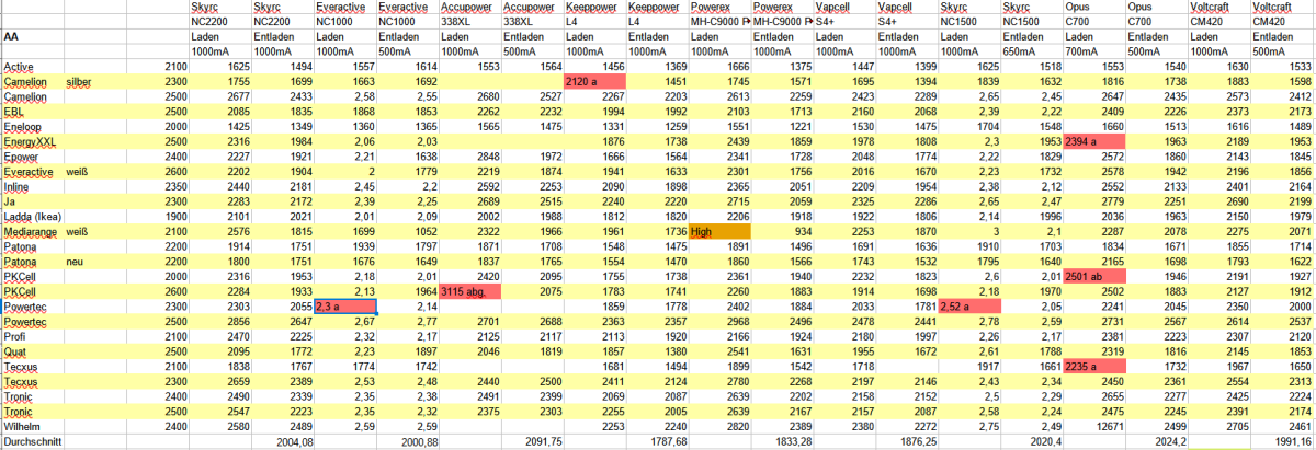

Here is a NiMH-comparision from me
comparision
Lowest results are from the Keeppower L4, then the Powerex MH-C9000 Pro and then the Vapcell

What means the red fields with the very high values?

The red fields are for manually stopped chargings because of to high capacity and to hot cells.

I have no lab conditions and maybe the capacity of some cells decreases from the 1st to the last charger, but I can´t do much more :wink:
Maybe there are many cells which aren´t not available in some countries, but I hope you also find cells which are available in your countries.
