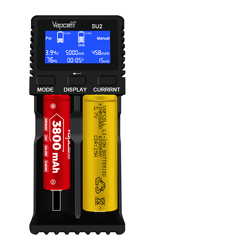

However, this new SU2 is expected to be released next month,
Many chargers are expected to use USB-C in the future
Looks nice, but 5000mA charge current?
Did it have similar features like the S4+?
Interesting, is there a similar 4-slot-charger planned?
I realize this may be an artist rendering but current is misspelled. One may want to correct this before shipping.
This is the first draft. I didn’t pay attention and casually asked the artist for a photo. I’m sorry, but will correct it later
The final product shall prevail
Damn, two slots, usb-c, 5A charging would be the dream. Almost like you designed this just to fit my use case! I want to charge 2x21700 in 1h, not sure why people are scared of 1C charging rate. I need this to charge diving flashlights between dives.
@vapcell_Dennis I’d be very happy to test these for you whenever the first versions are available
This looks great! Compact, long enough for 26800, high current, USB-C, manual current mode, IR measurement. Everything we could dream of. :smiling_face: Please contact me if you’re looking for reviewers.
I agree. It looks like something I could be interested in. It would be nice to have at least 3 amp (or more) per slot charging (with the correct supply) for those big cells … as in 26800 cells.
