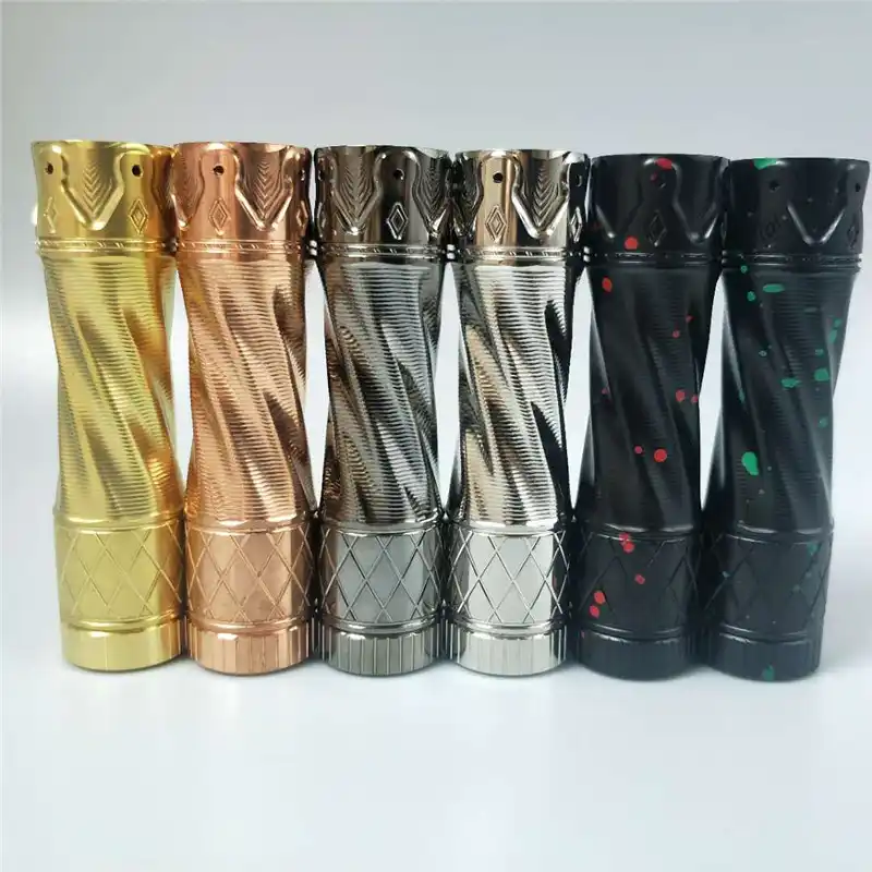

I didn’t get any before shots or mod shots so this’ll be short.
The tail/switch section became the head of the light. All ingredients are stuffed in from the front, meaning the bezel retains everything in the head.
I cut a recess in for the switch. I wish it was neater but I needed space at the ends to connect the wires.
The base of the tube had a recess already manufactured into it. I bent up a spring to the right size and pressed it in.
All the holes at the end got fill with epoxy and glow powder.
