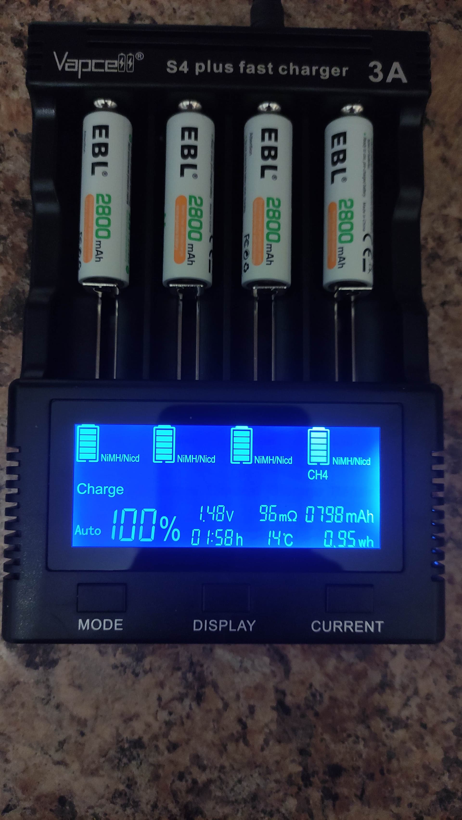

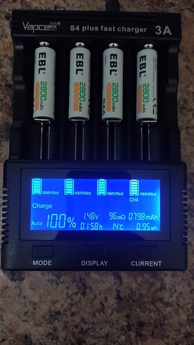

I just bought a vapecell S4 after using cheapo plug in chargers for many years.
I don’t understand some of the numbers. Does this sound right? Brand new EBL 2800mAh AA batteries. We’re 22% before charge. Fully charged mAh is really low, less than half?
Also I’ve never had discharge, capacity test or repair function before. When would I use these modes?

The charger shows the amount of energy it managed to put in a battery. Some of that energy where converted into heat so actual usefull stored energy is even less.
I haven’t dealt with NiMH yet so don’t know how accurately chargers can read state of charge of this type of batteries. Maybe actual battery’s remaining capacity were higher than 22% therefore the charger was able to put only 790 mAhs into it. Or these batteries are fake and have much lower capacity.
Well, excactly in situations like this one.
You can run capacity test to check the actual capacity of the battery.
Capacity test fully charges battery, then runs discharge test, then again charges the battery.
Discharge test only discharges the battery. It is usefull if you want to dispose your batteries.
Repair - brings your batteries back to life after deep discharge (Li-Ion), in case of NiMH gravelmonkey provided a better explanation.
Capacity test would be useful if you want to know the capacity of the cell. It takes a while.
Repair charges and discharges cell a few times, I personally wouldn’t bother with it as it’s a waste of time and energy.
Note I talk about time, general consensus is it is best practice to monitor cells while charging, I get bored waiting for cells to charge for more than 2hr, capacity tests can be loooong.
the percentage shown initially when putting in NiMH batteries in principle is very inaccurate … it’s just a very rough first estimation of the remaining energy in the battery based on its resting voltage, which is significantly lower than at the end of the last charging …
during the further charging the charger then can adjust the percentage score …
the EBL 2800 reached different capacities in tests, whereas in a test elsewhere they reached a very good capacity, someone in our german forum measured just 2000 mAh …
may be sometime they changed the cell under the wrapper …
the loaded mAh are not an exact indicator of the capacity that fitted into the battery, as it was said before, there are losses during charging in form of heat, that the chargers try to compensate by correction factors … a more exact measurement of the principle capacity of a battery can only be done by discharge, which is applied in the capacity test function …
