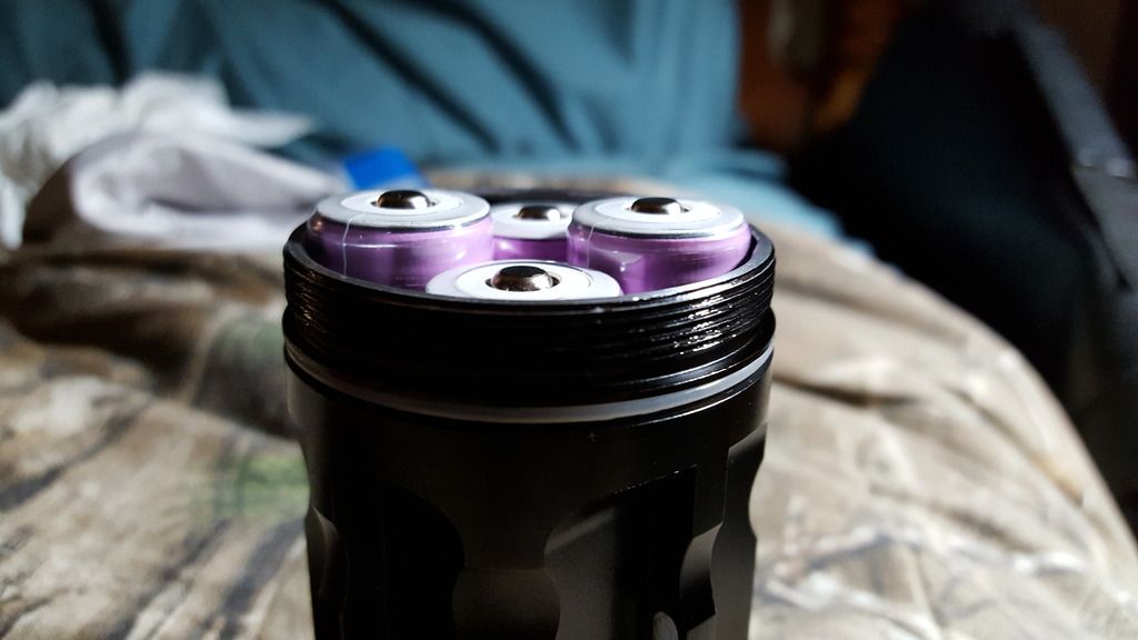

I received a light today as a sample ( I did have to pay a portion). For now I am not going to mention the brand as I am trying to allow them to explain and/or correct the problem.
As soon as you see the picture below you will see the problem...
As you can see the tube takes 4*18650 cells and as you can also see 2 of those are set way too low to ever make contact with anything.
I have already checked and the tops of the cells do not touch the bottom of the board at all. The other 2 cells work just as they should. The light level is even a bit above what is claimed using only 2 cells.

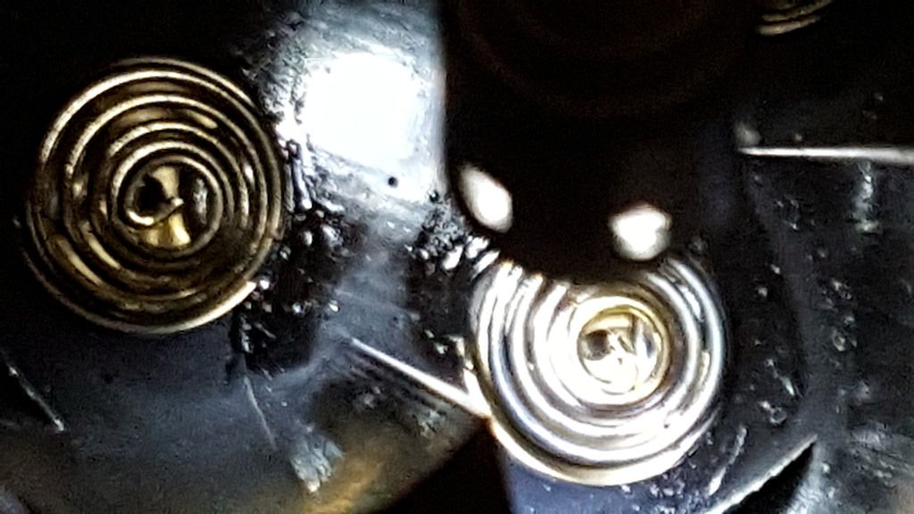

This next picture is where I got lost. You will see all of the solder and by the way these springs are the 2 that sit too low.
Possible legitimate reasons?
Or just poor quality control?
Thanks for any help....
Terry
maybe they tested on 2 cells, lots of current, sagging springs, like the Q8 troubles we encountered, but far worse (or longer used and tested)
That's a very good thought that I did not think of. It would also explain the excess solder. You can't see it in that picture but there is actually tiny balls of solder in the bottom of the tube. Enough current could do that.

Yea it looks like it shorted out and melted the springs.

Amongst others, UF sells these models with 3 to 7 led’s. Could be that someone tried to force in batteries that were too long. So the springs were compressed byond their elastic range. Other thought is that the short springs were never hardened or were overheated and lost their “springyness”. BTW that’s one messy soldering job. Should look like this:

When there is too much current around (a short?), the soldering is usually the weakest link in the chain.
I got it..... The bottom did not seem like it would come off but it does. I pulled out the bottom and just removed the springs then re-attached them. It looked like they just let it get way too hot. Might have been teaching someone to solder.

the springs look to be gold plated,
to get those oxidated you need temperatures over 500°C
of course the base metal gets soft and sags permanently
How it happened to only 2 springs
someone inserted 2 batteries one in reverse
so they get a guranteed short
30-50A depending on which high drain cell you got are at least present
like 50-70% of that heat is generated in the springs

I have never melted a spring by overheating it. Even the small spring on a nanjg driver. I think it would have to be a short. High currents cause over heating to wires and springs causing them to melt.
Just replace the springs they look to be a standard size. You probably can still use them but they will have a higher resistance.
After a few emails I found that the tail cap does come off even though it is very tight and does not look like it would. Once I got it off it was pretty easy to see that someone must have been training with the soldering iron, 2 springs are very nice, the two in the picture you can easily see that it is from someone that either did not care, did not know what they were doing, or just wanted to screw up some stuff.
I de-soldered both the springs and cleaned them as best they could be leaned. Wicked up all the excess solder and got a ton off of the springs. Stretched them slow over about 2 hours and soldered them back into place correctly.
