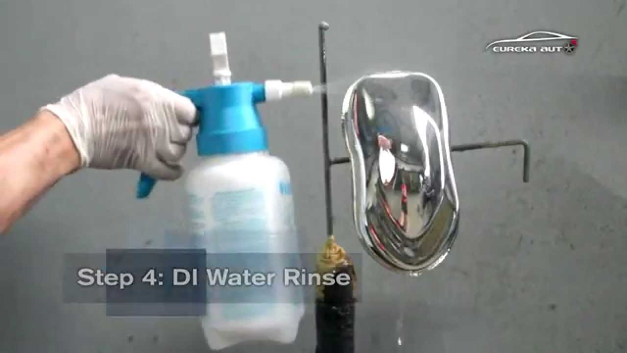

Time to make some, fitter i work with wants one for spotting poachers on a reef in Fiji so he is going to have a go at machining them. It will be a called a Inverted Swann Reflector. Polished Aluminum or Nickle or silver plated brass?
Well if you can make something that works im sure there is a que of people waiting to buy…
Bright nickle plating is not to difficult to achieve , silver nitrate could be worth a look too
Home Chrome , similar to the Aikka Nano system
I am not sure about the longevity of these surfaces, oxidisation or tarnishing over time is something to research i guess
