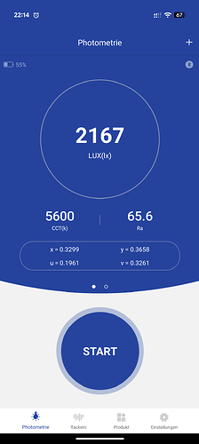

I was on the hunt for any information regarding the CCT of the LEDs - and on my way I found something weird:

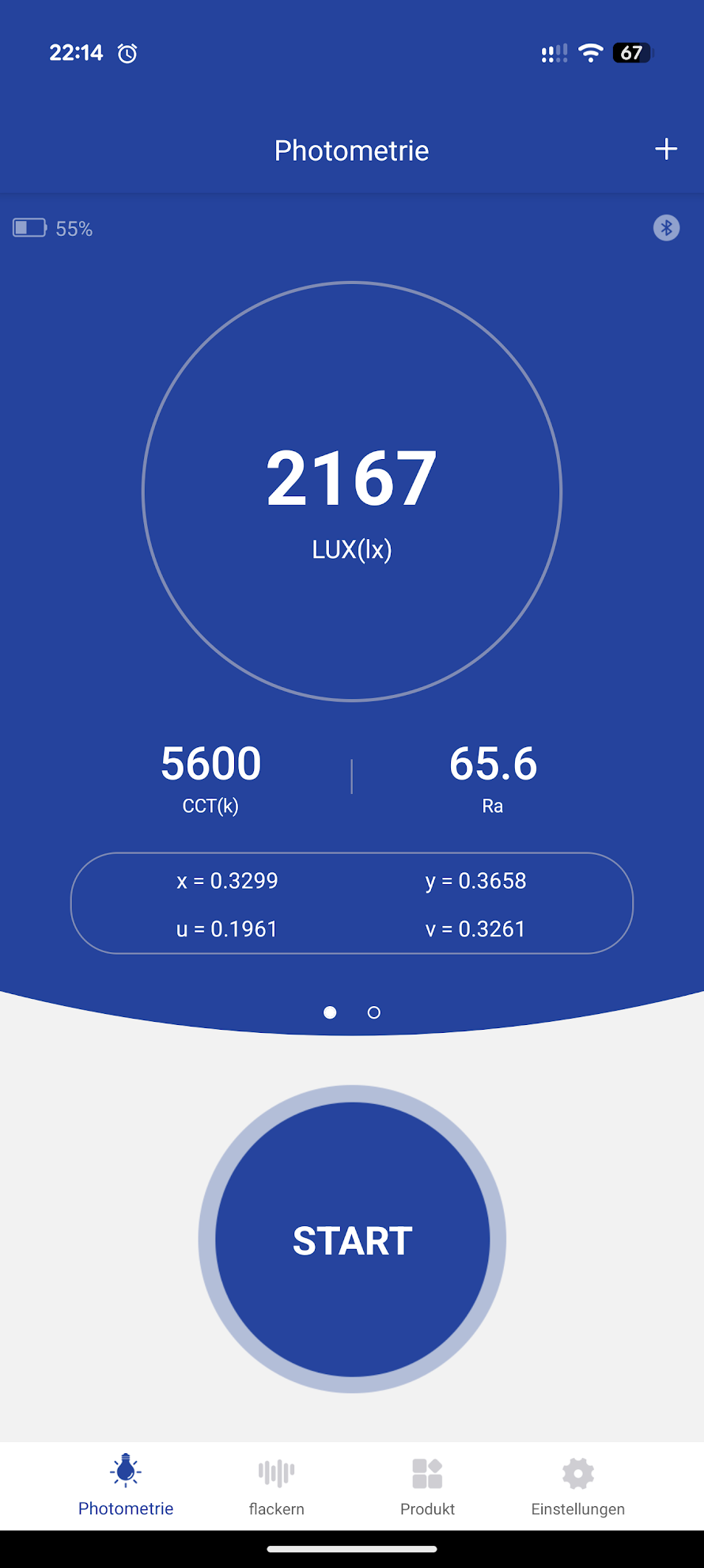

I hadn’t noticed before that there is/was a 90 CRI version (no CCT mentioned though), which is somewhat unusual for Lumintop. That makes it a bit more interesting to me, since the V2 version with (probably) CW and low CRI LEDs might make me ending up swapping the LEDs. (And I have already more than enough flashlight projects on my hands!)

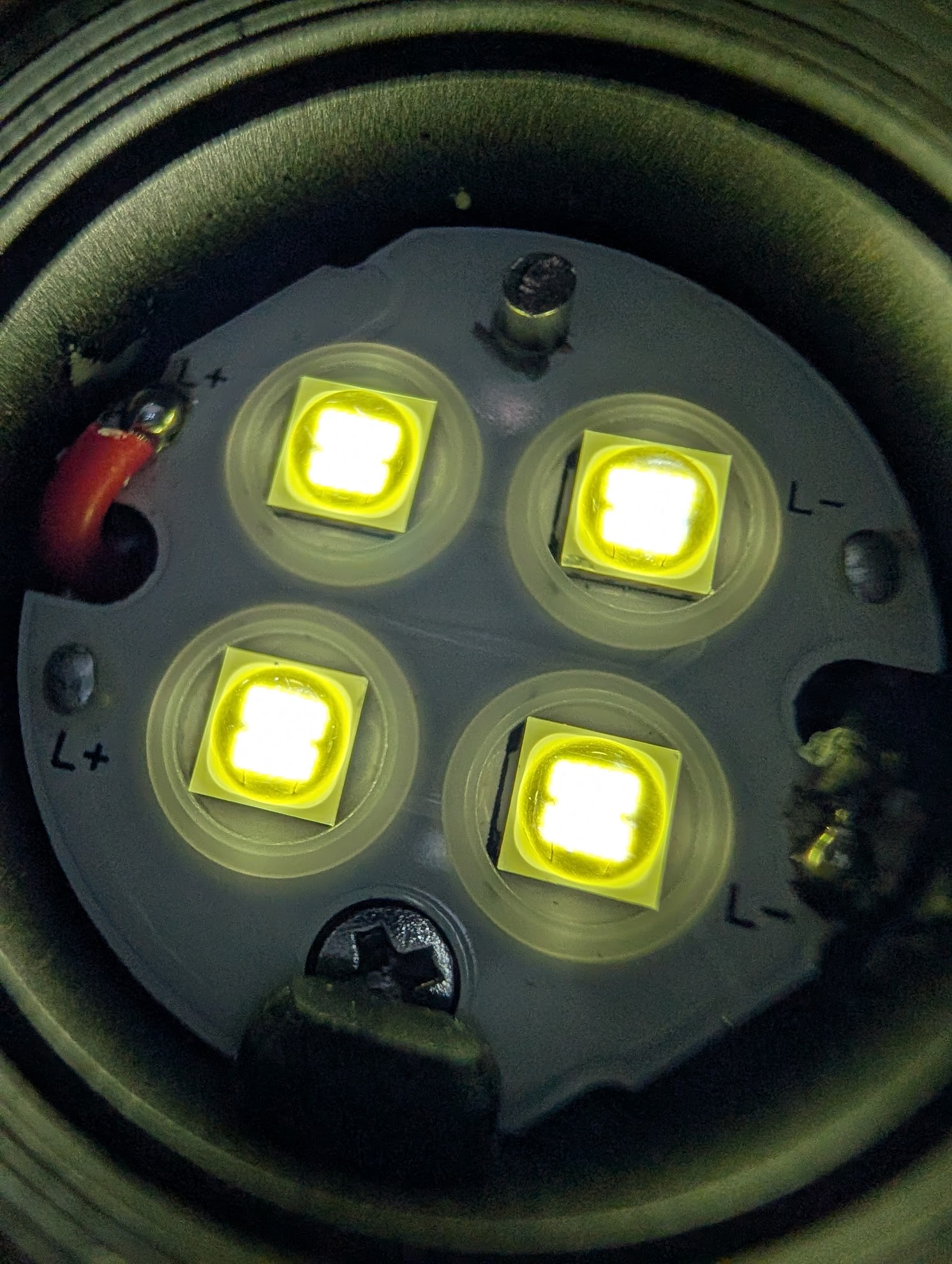

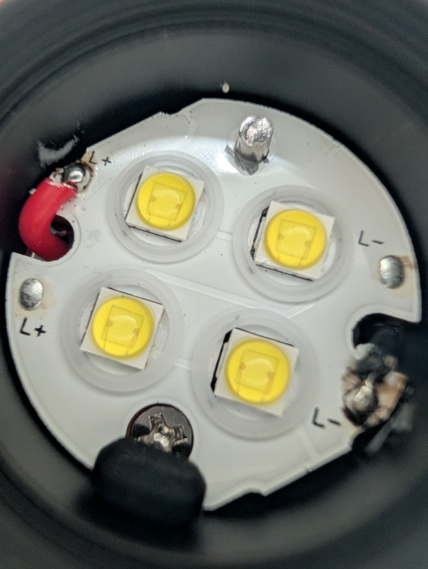

So, I got the light and already changed the LEDs.
Quite a nice light, but not very bright. You would expect more from 4 LEDs - but yes, it clearly says it’s 1300Lm, so no big surprises here.
But because of that even on turbo the light doesn’t get too hot.
The original LEDs are 3737, so my 3535 519A 5700K don’t fit perfectly. The holes of the reflector are 6mm and I don’t have a fitting gasket for that.
But because the beam isn’t super focussed, it really doesn’t matter.

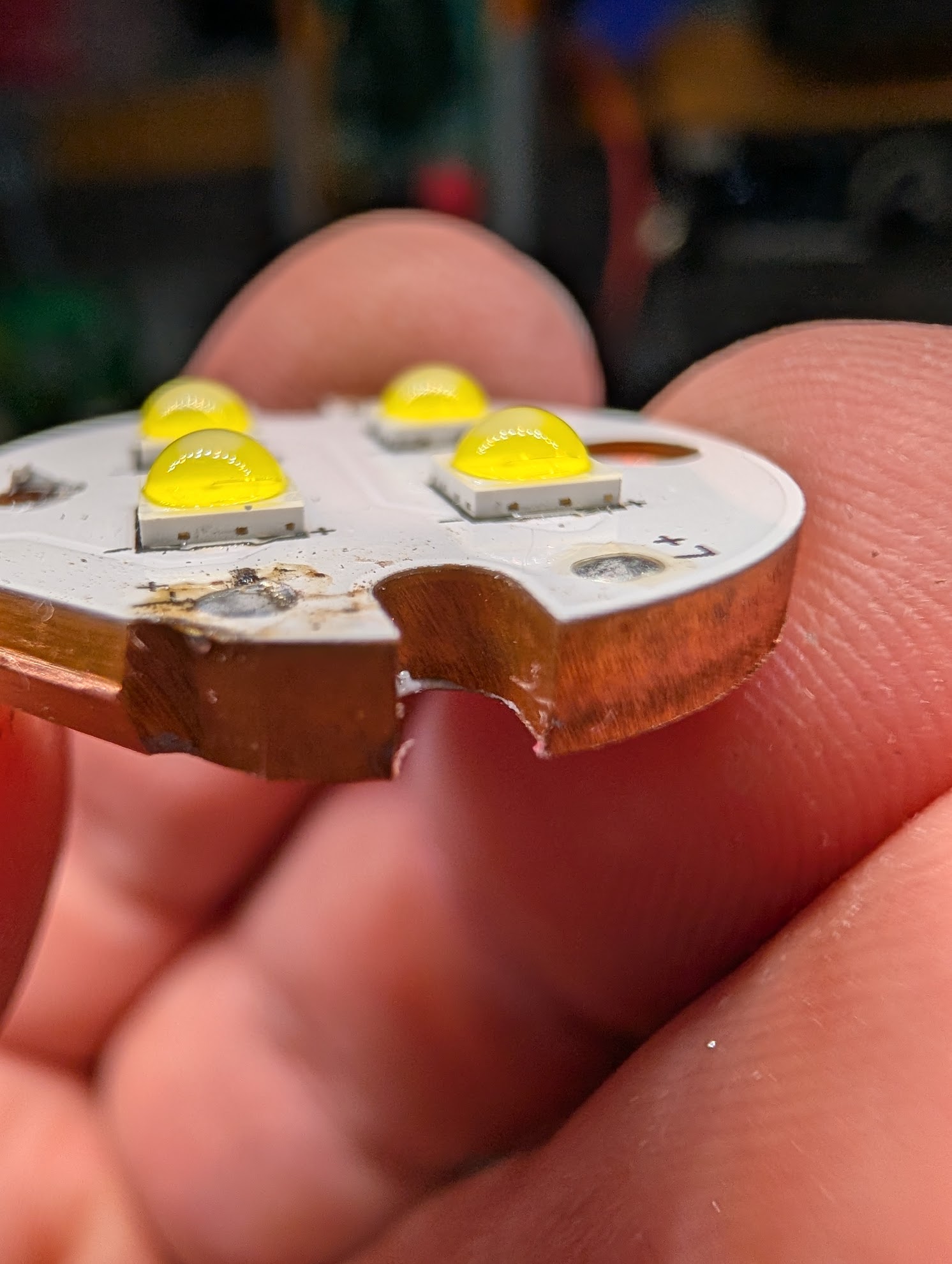

Original LEDs:
I was surprised by the very thick MCPCB!

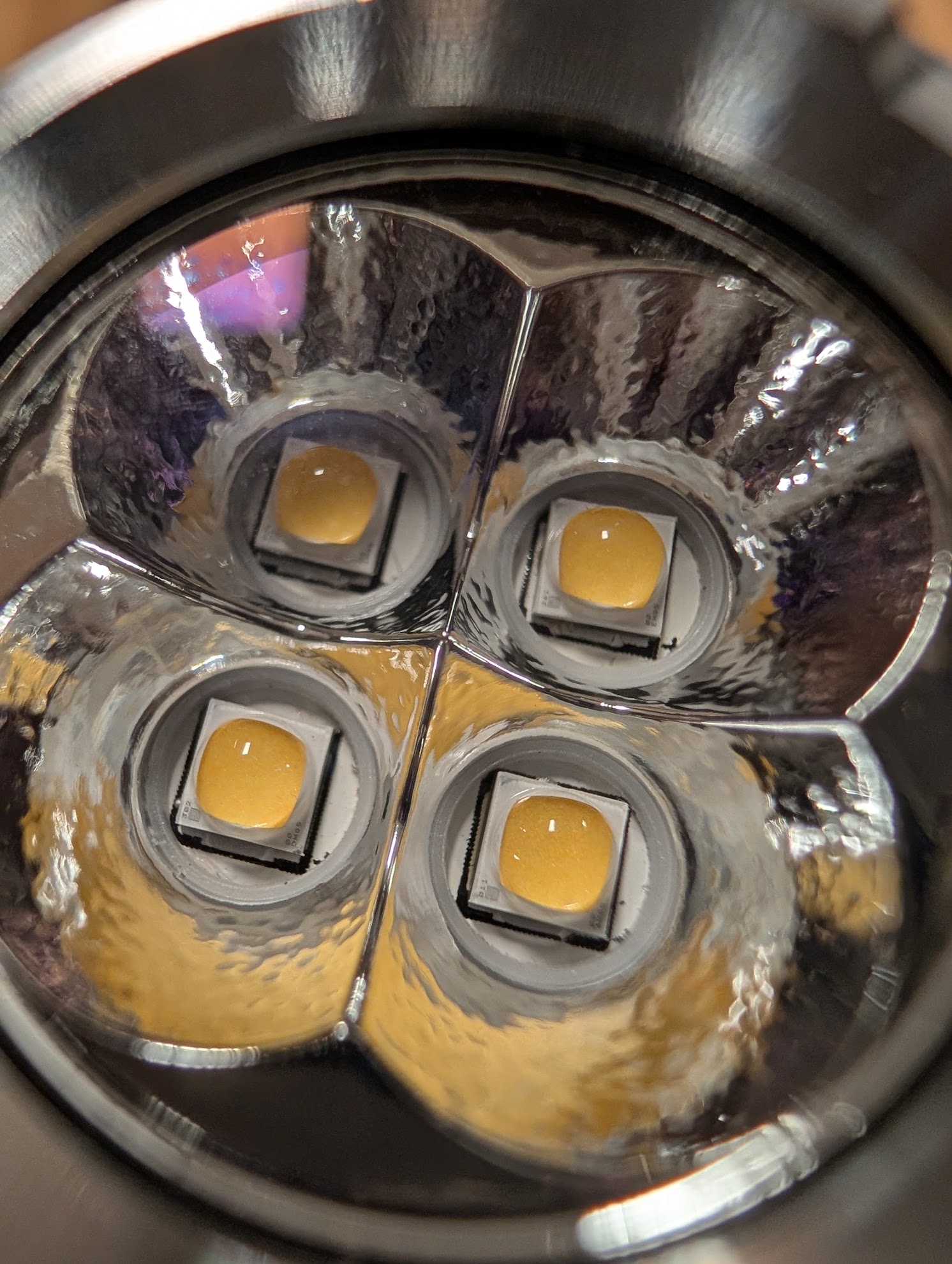

Now with 519A
It’s a very nice EDC, even with the original LEDs.
