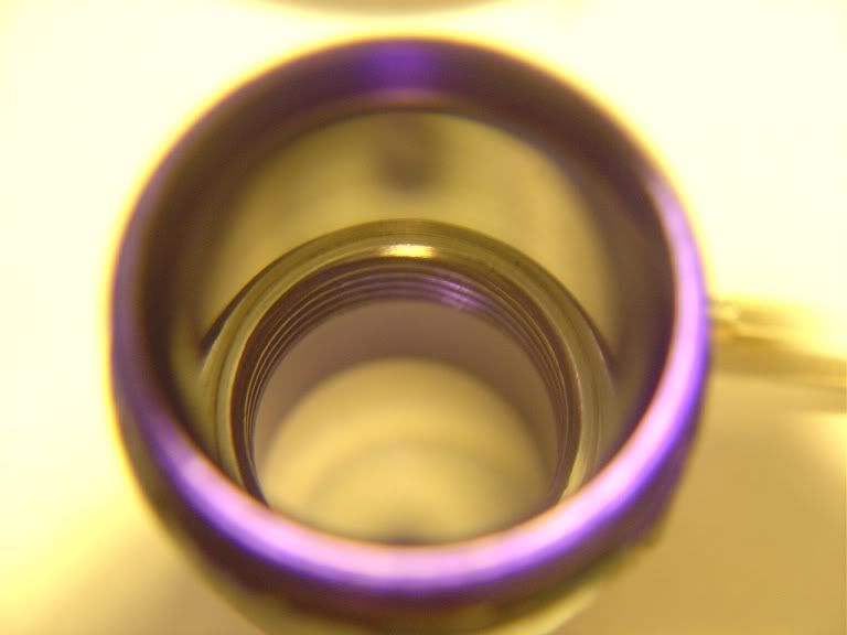

Here’s a few pics of a custom shorty 1AA mini mag I done a while back. This is the finish you can achieve with the mothers mag wheel polish.
And the light it all went in.
