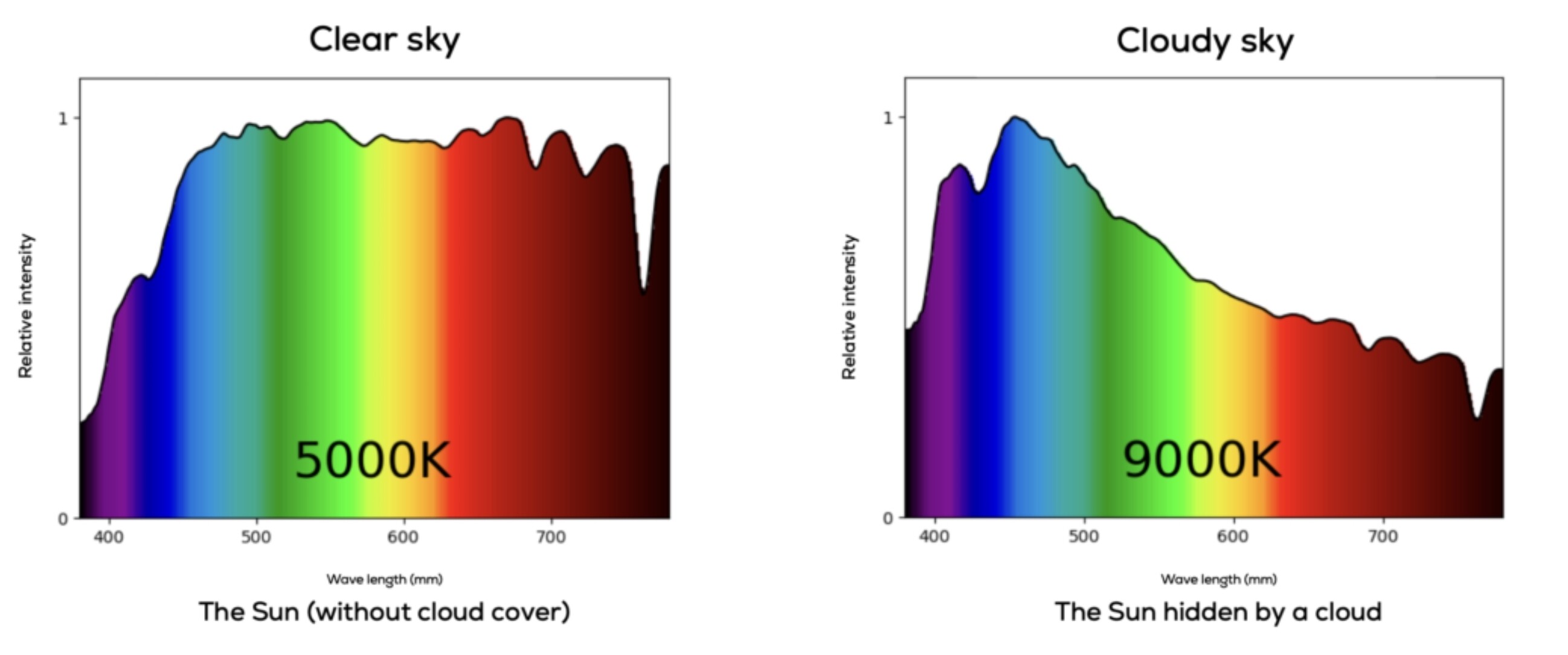

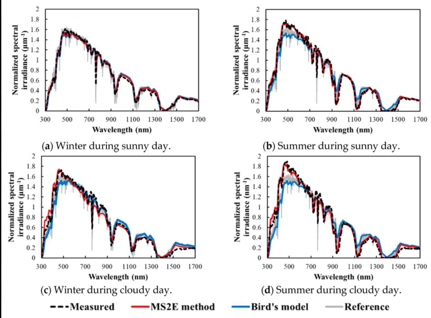

On to if yellow (or longer wavelengths) is more effective than other wavelengths.
What is interesting is comparing the spectrum on a sunny day vs the spectrum on a cloudy day.
There is more to discuss here, but frankly i need to look at these charts more.
Still, if someone wants to test, take a full spectrometer out in the sunlight, and then out when its cloudy. See if you get more power in the yellow (or longer wavelength) spectrums under the clouds.
One could also measure a flashlight on a clear night, then measure the same flashlight on a foggy night, again comparing the spectrum and where it drops most, and where it drops least.
Note, this is not quite comparing cct. Yellow is a wavelength, not a cct.
You could conduct a similar test with two flashlights and a light meter. Take two lights, say one with a 519a and a high cct, then the same light with a 519a and a low cct. Measure output of each at a set distance on a clear night, then measure the output of each at the SAME distance on a foggy night. The one with the lower output drop is “better”.
