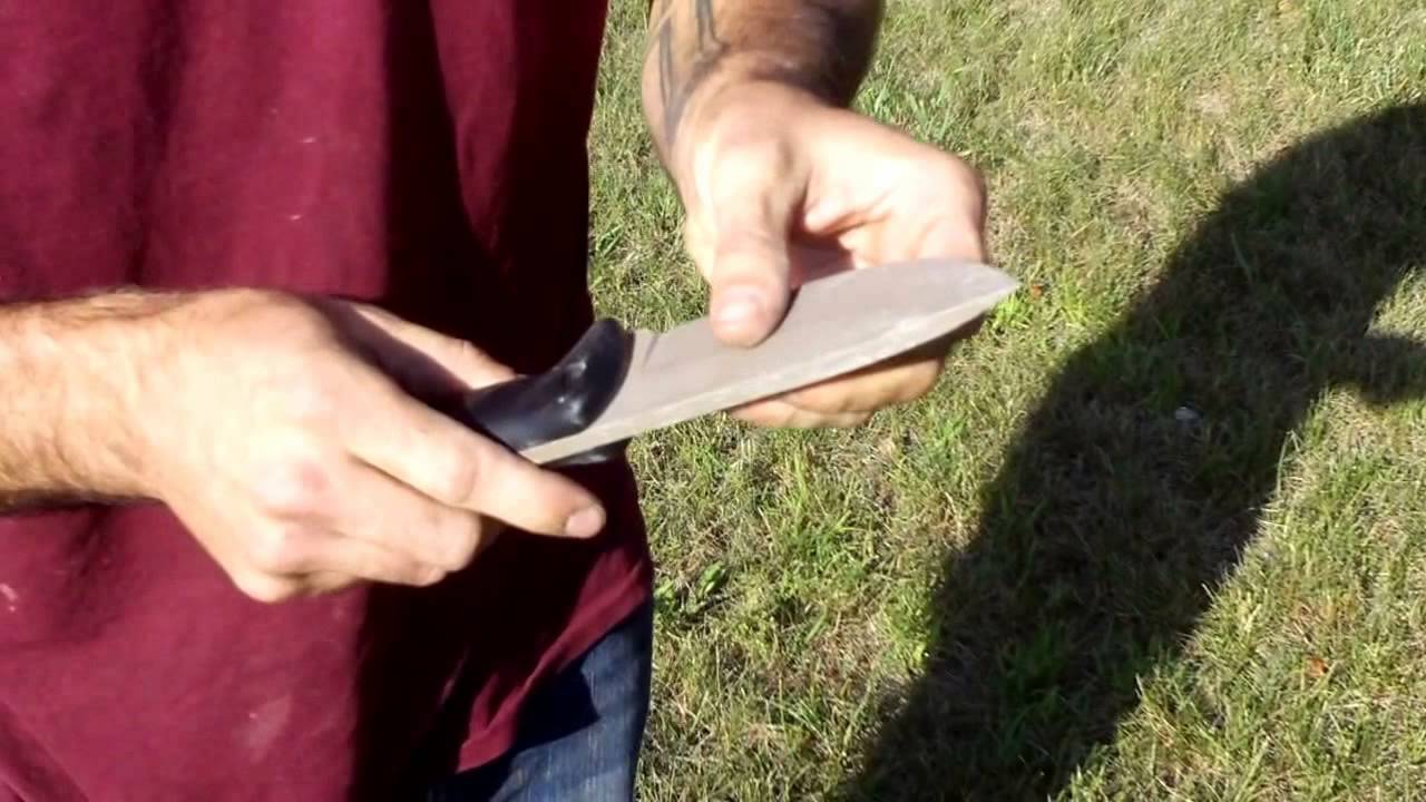

It’s a bake on ceramic firearm finish. It’s a pain to apply. Takes a while. But is pretty durable for regular use. If you drop it on cement it will chip or scratch, but less than cheaper anodizing. No finish is bullet proof. I love colored anodizing, it can be incredible. It just won’t last in the woods! If you get mud on that pretty colored anodizing and wipe it off with your hand or pants, it will scratch. Not so with cerakote.
Cerakote torture test on youtube
