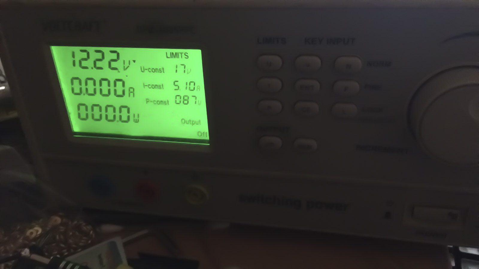

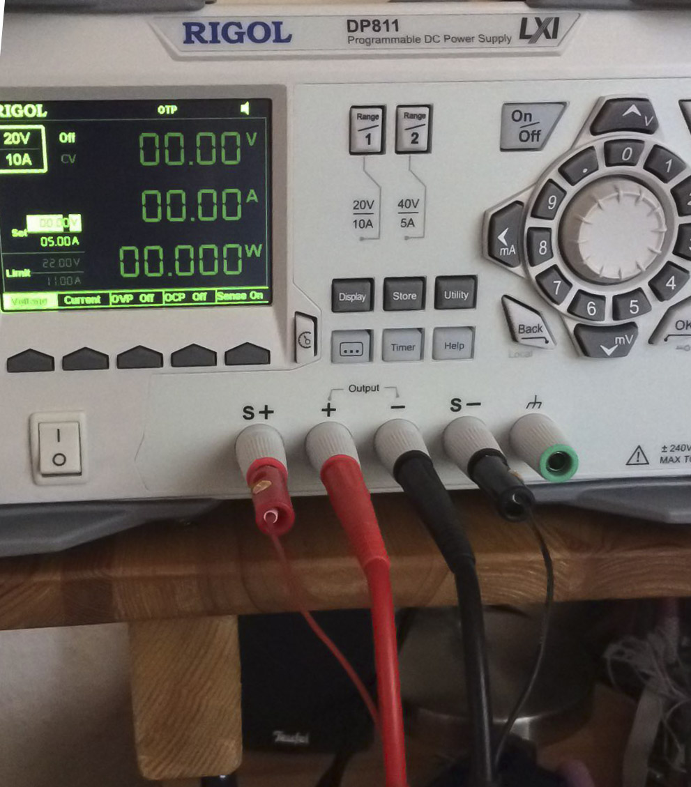

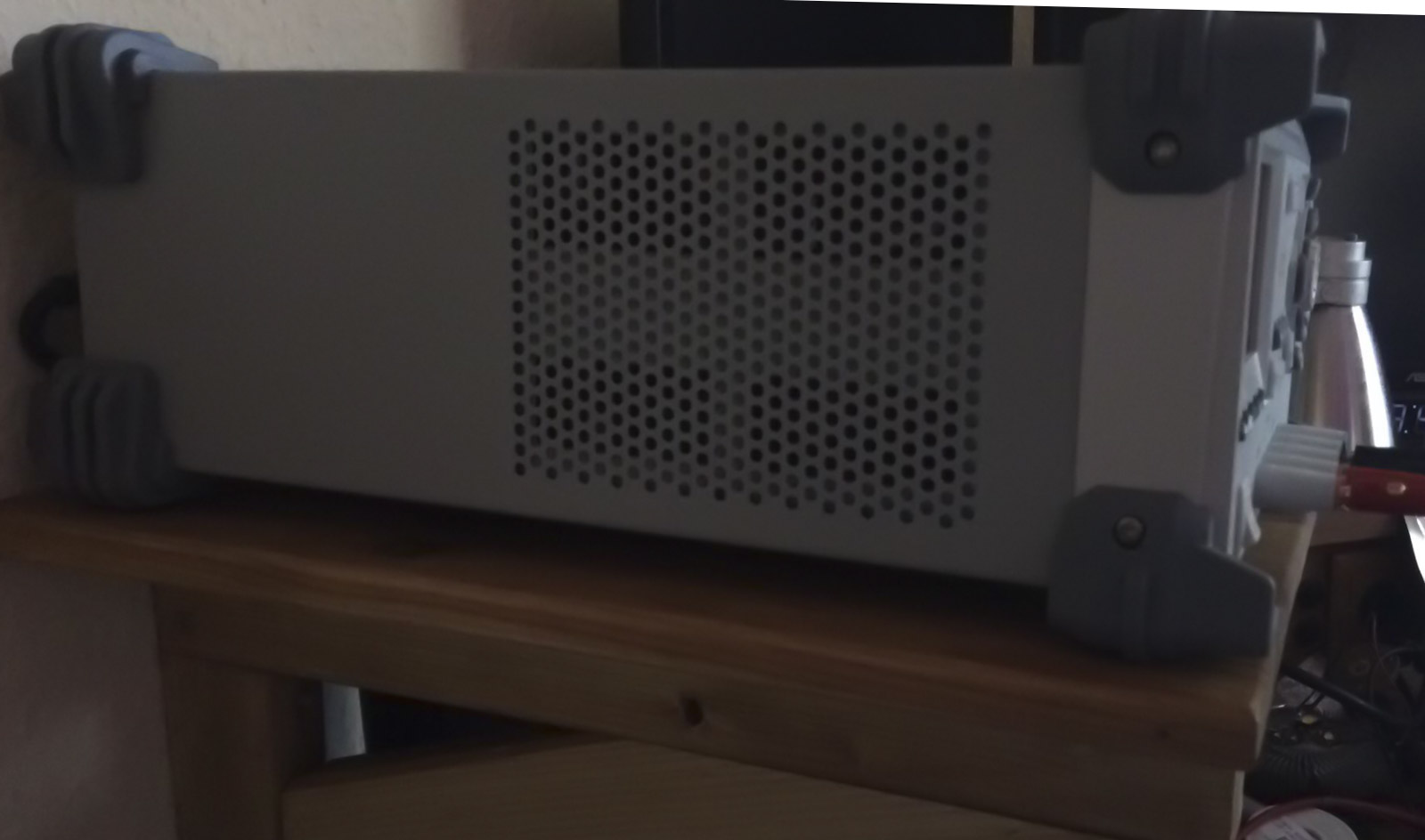

Build a wall mount for my new lab power supply
replacing the old 40V 5A
new features for driver testing

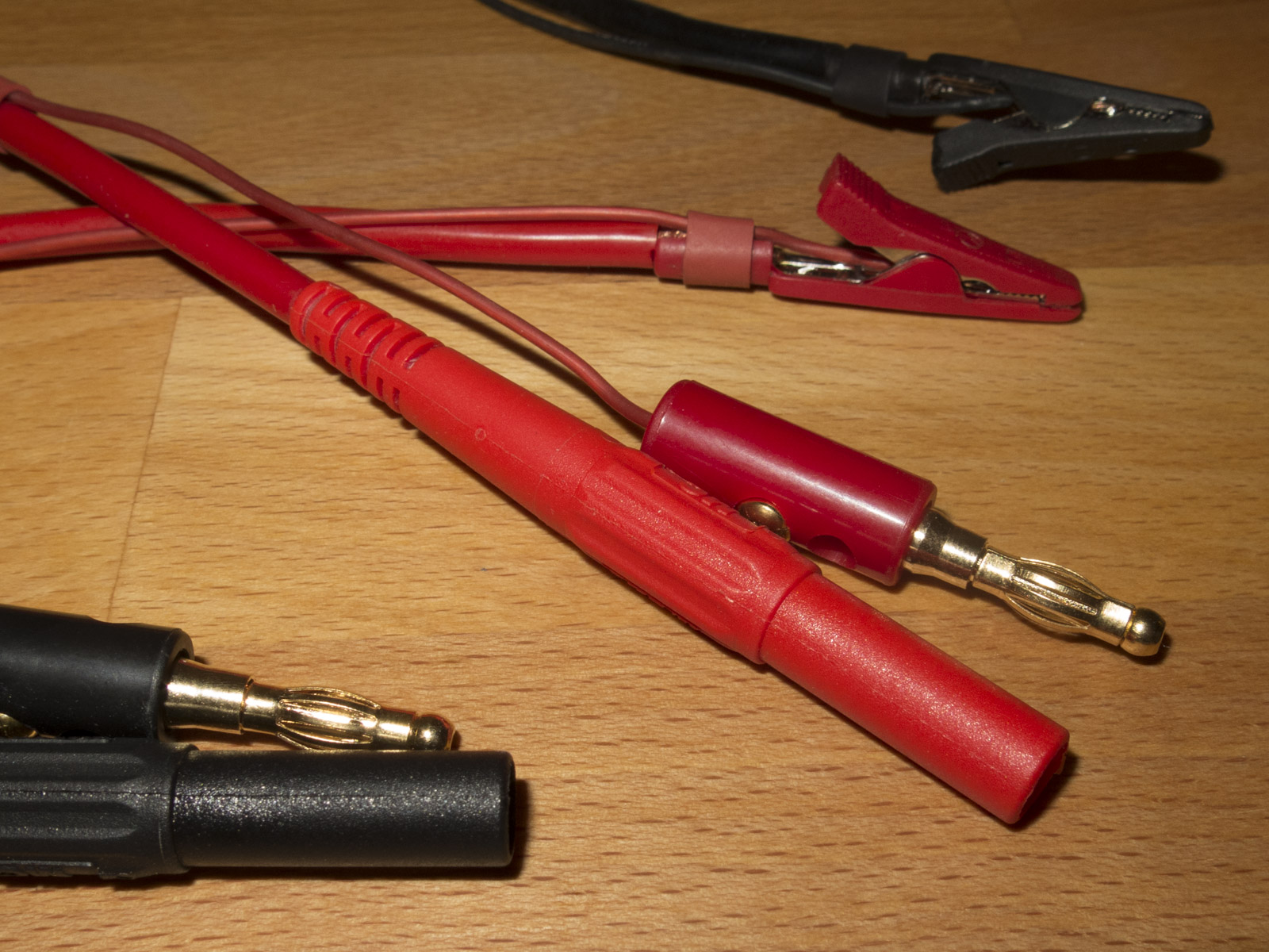

also it can measure the voltage on the crocodile clamp build like a Kelvin clamp not on the voltage output therminals
Build them myself from a 2.5mm² wire soldered to the clamp and 0.35mm² wire for voltage detection
