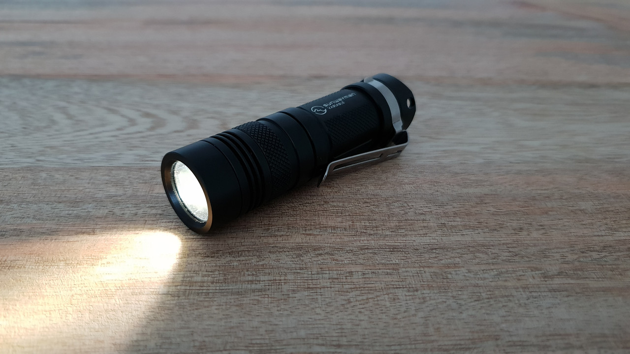

I bought it at fasttech with some points I had it was around 25bucks.
It indeed uses a small mcpcb. I reflowed the led on the original board. Should be fine at the max 2 amps of the light.

Is the driver stock or something high power pocket rocket what I’m seeing?
I kept the stock driver :
1/ It has to be reliable and not burn pockets, so no high power FET based driver
2/ I wanted to keep the rechargeable function
3/ It’s powerful enough for my use
