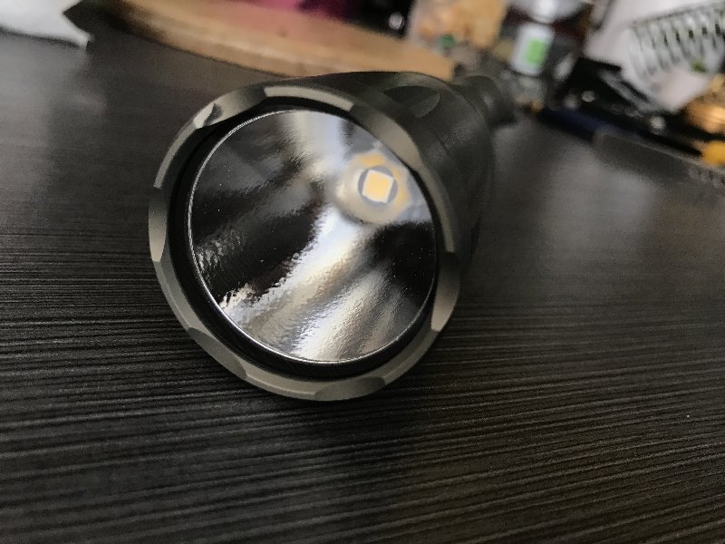

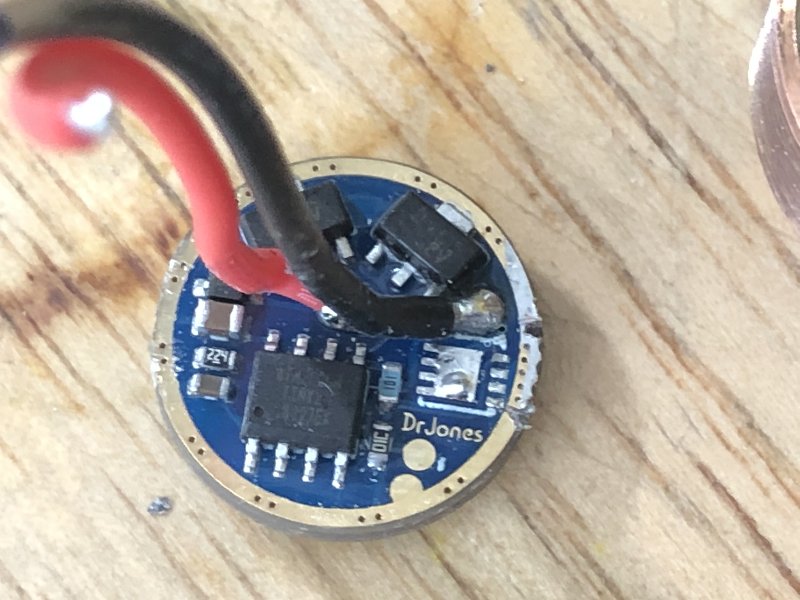

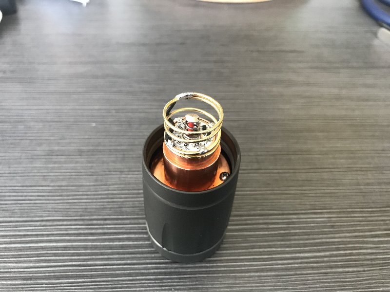

Modded my new Tool AA V2.0 Ti:
  • Reflowed a Luxeon V2 5000K
  • Added a bleeder resistor (stock tailcap works ok without one, but not my custom tailcap - it needs a dependable current path). Used a 0603 footprint 750 Ohm resistor stacked across the main capacitor (see the yellow circle in the picture).
  • Swapped the black tailcap for a very light green GITD one (link). The only problem with these is that they don’t have a “nub” inside, so you really need to press in order to activate the switch. To address this, I put a dab of clear silicone caulk in it and let it cure. Works great now. This lets a TON more light through than the stock black tailcap.
  • Stripped the stock illuminated switch board, which is a similar set up to the Convoy add-on illuminated tailcap that utilizes a clear plastic washer to let the light get to the tailcap (albeit, somewhat inefficiently).
  • Installed a battery-monitoring tailcap. It has 4 LEDs that extinguish one by one as the battery drains down.
  • Attempted to strip the gold clip, but failed. After a 30 minute bath in a strong lye solution, the coating didn’t budge at all. It probably is real gold plating. It’ll stay for now. I’ll probably either just remove the clip or grab a stainless one from another light.
Nice upgrade gchart. Is it 10440 or 14500?
Oops, it’s AA / 14500. I just updated the post.
Nice and skillful mod, gchart. :sunglasses:
That battery-monitoring tailcap is incredibly genious. :open_mouth: I will try to build one. I need this on my flashlights. :partying_face:
