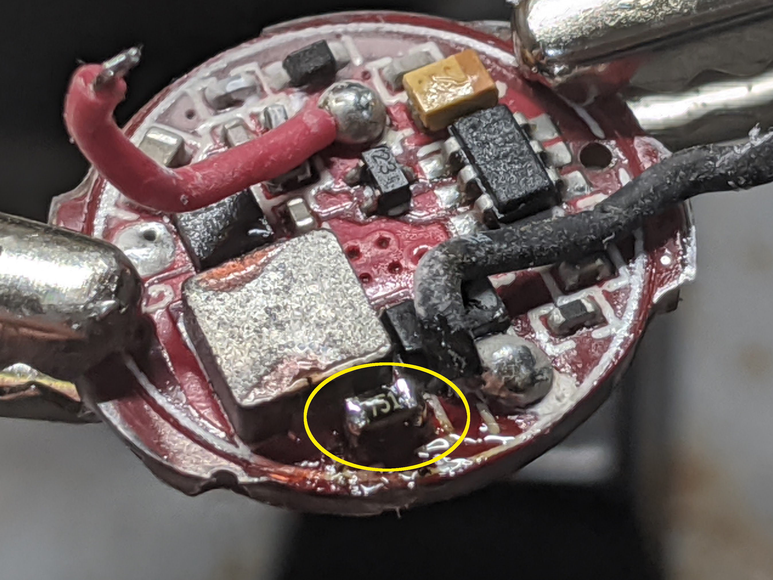

Oh, I didn’t use the stock driver as they didn’t actually comply and use quality components, so I built a new driver and used the high power mod with an R100 between the diode and C1. :wink: 18ga Teflon leads to the emitter, 18ga Turnigy spring bypasses in the Blue Sword springs.

The factory driver will probably do ok, it will most likely need the R100/Diode/C1 mod though in order to be able to really do the high current. Without it modes 6 and 7 probably won’t function, it’ll glitch back to mode 1.
I have had them function fine in a triple, so it may be well worth finding out. But if it glitches back to 1 then you know where the problem is…. :wink:
Can you direct me to some info about it?
if you already posted somewhere...
djozz posted about it HERE
I don’t usually try to lean the components against each other like he shows there, especially in a light like the X6 where there’s plenty of room in the driver bay. I simply stand the components straight up and bridge them with solder. :wink:
Edit: To simplify, stand the C1 on the outer pad, stand an R100 resistor on the outer pad intended for the diode, stand the diode (in proper orientation, in my case this had it pointing down onto the pad) on the inside pad intended for D1. Then bridge the tops of the three components.
Edit II: For simplicity and clarification, here’s the pic from djozz…
Edit III: The diode needs to be placed in the right direction or the driver will not function. The markings are very small and difficult to read, usually the 1 where it says 41 is in the direction of the MCU, or my Diodes have a small line on the proper end. And yes, as many of these as I have built, I got it wrong yesterday and had to take the driver out of the light and reverse the position of D1. It is what it is…

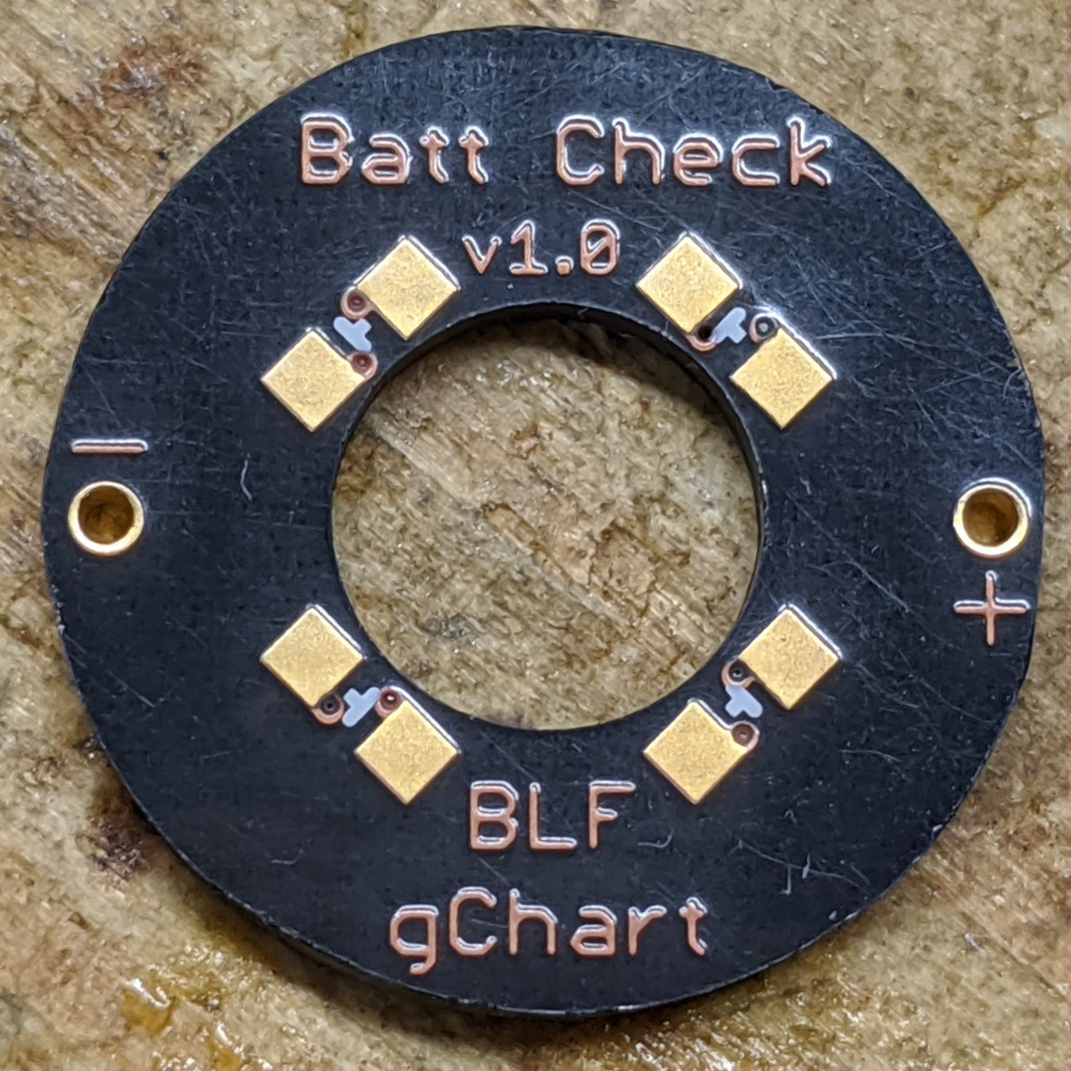

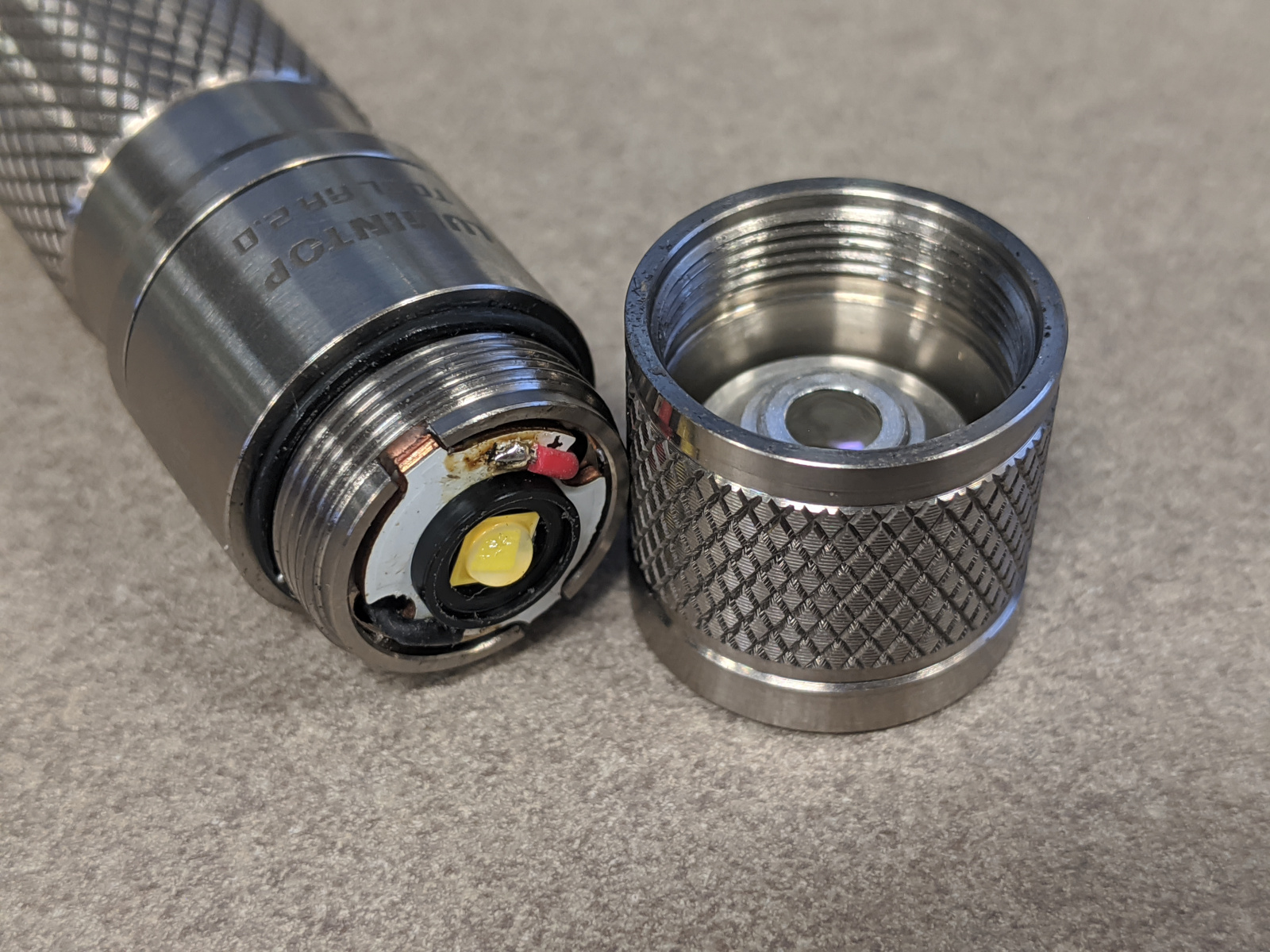

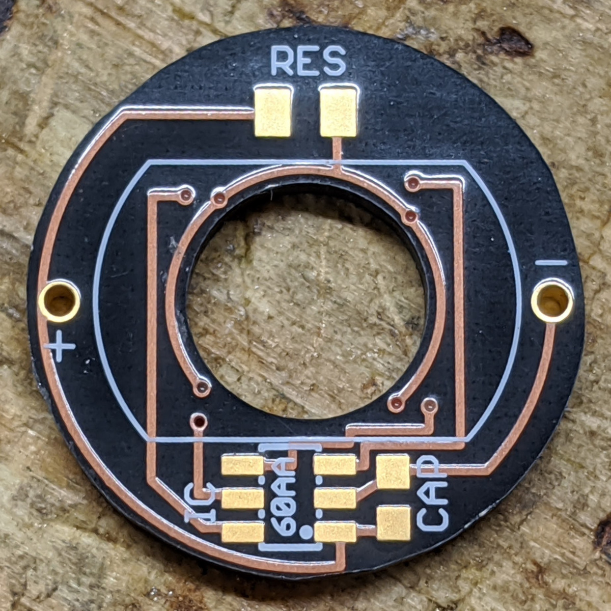

That’s really impressive! Adding an LED battery level indicator in tail cap is so cool. Is it always on, or activates momentarily when light is turned on, the way Skilhunt does on the H03RC?
Thanks! It’s on whenever the flashlight is off.

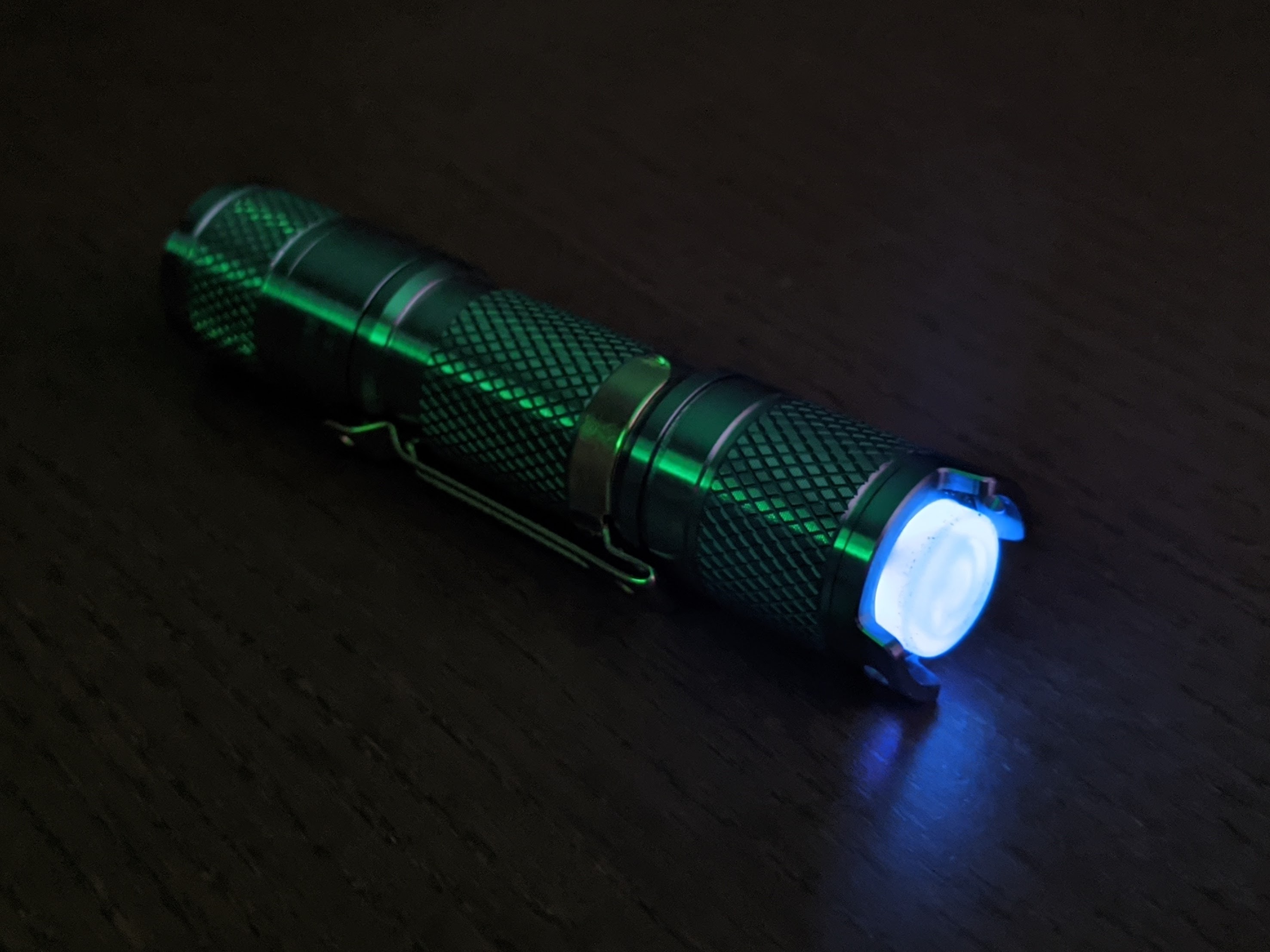

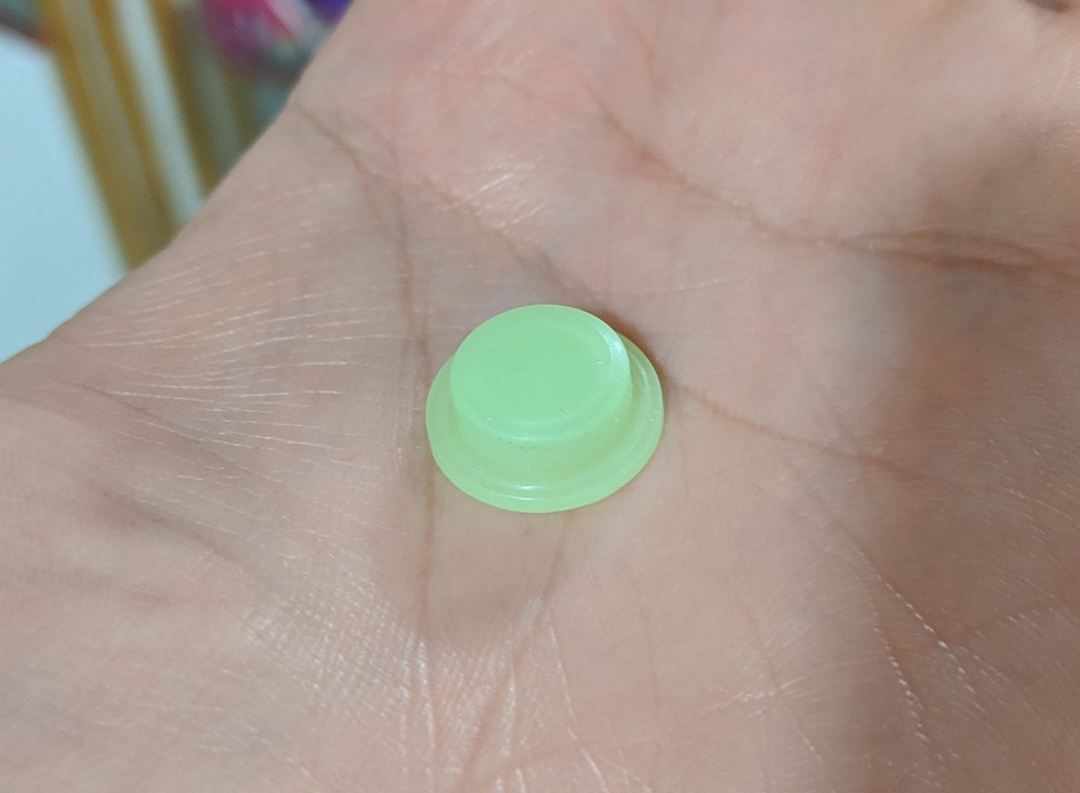

Not today, but I replaced the leds for luxeon v2 4000k and added an orange turboglow. It matches the button color.
The photo shows an exposed turboglow after a few seconds on high…
