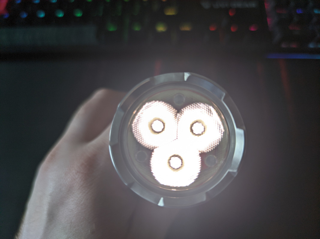

I “stole” GetKongs T3 triple idea and did it too
FWAA TIR lens and MCPCB together with the 17mm 5A Convoy driver and a spacer built from multiple 16mm 3535 copper MCPCBs I had laying around
But I couldnt leave my FWAA in my spare parts bin so I made it into an XHP50.2 mule:
