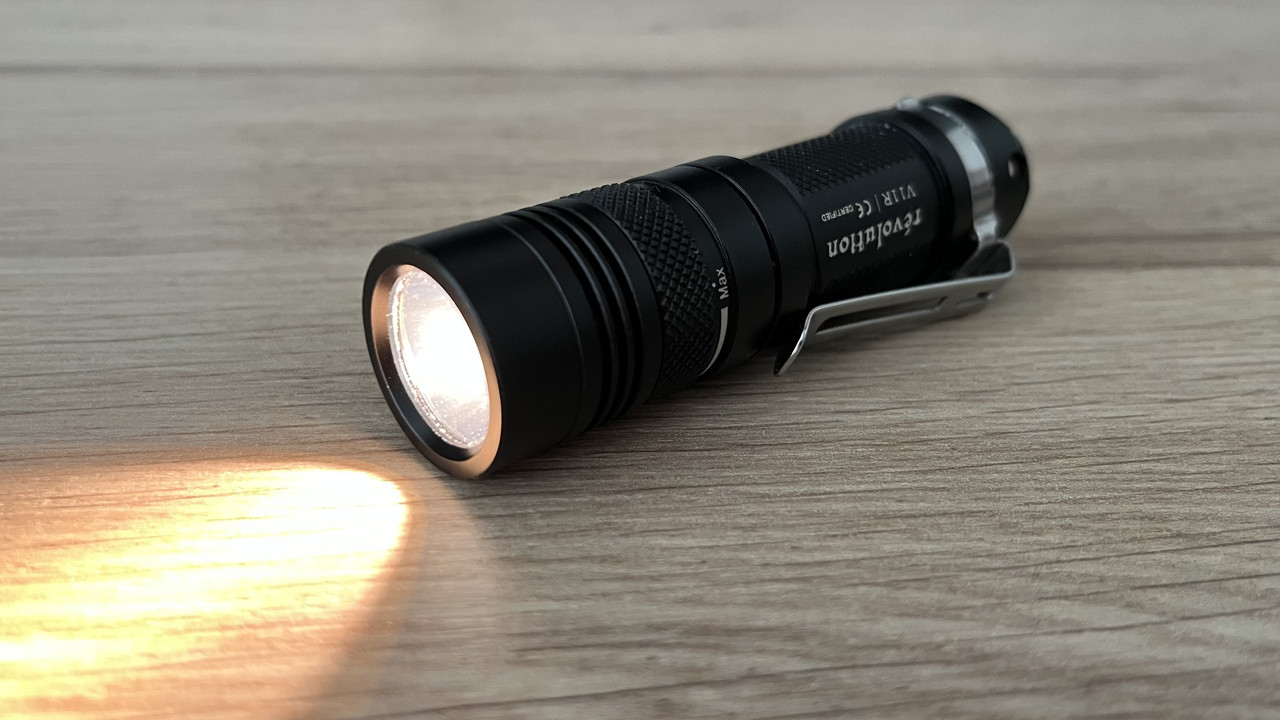

V11r with 3000k 519a and lighted switch. Might be my new favourite emitter.

Domed or dedomed?
I will be reflowing a triple with 519A 3000Ks shortly and was planning on immediately dedoming, but maybe I should keep them intact?

11240
On mine the deep reflector and domed LH351D is a perfect beam. I would suspect a dedomed LED on what was originally a big XML led would not be as nice but i’m no expert on this light.

Good insight contactcr!
I was thinking tint and CCT, but beam is very important too especially with a single reflector flashlight.
Mine will be with a triple 10511 Carclo lens so I think I’ll go with my original plan and behead them!
