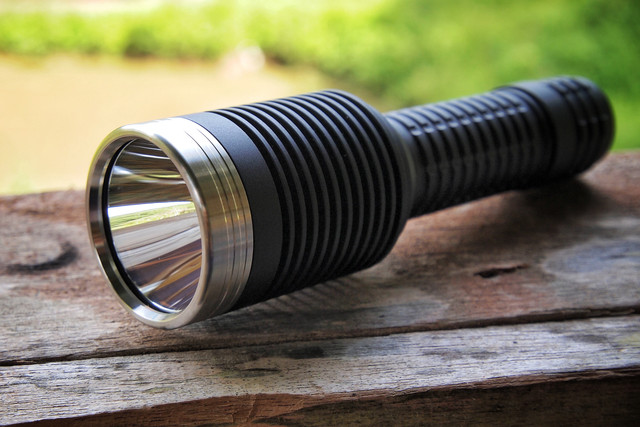

New build - 219b sw45k in a “DDH-D2G” host (DongDongHai) from China. Nothing fancy but I really like the host. Beefy as hell and looks a bit like kiriba-ru’s C8TT head. It was supposed to be an SFT40 in there but the one I ordered was DOA :person_facepalming: and I only ordered one unit :person_facepalming: . 219b was all I had left so I guess I’m rocking a CRI thrower now.
I am Not going to say I like your DongDongHai… I just will Not.
I had to check out the DongDongHai. :blush: They have some nice lights that I do not think I can get here in USA. I need to check the Flashlight Host and Uncommon Budget Flashlights thread.
Hope you can revive the SfT40. Reverse polarity? try to re-melt it? I have even found one emitter mounted 90* out.
I saw it in Weerapat Kiatdumrong channel first. Due to the head size it’s a bit front-heavy, but other than that it is a wonderful host. I like browsing that thread too :smiley:
I tried all I could think of. Based on photos I’ve seen on the internet it may be seller flowed the LED the wrong orientation. when I received it I tested with DMM diode test and it didn’t light up. I reflowed to the other orientation and still no light. I don’t know what the problem is. The seller already apologized and issued refund.
This morning I realized the emitter was missing from my parts box. I was looking for it to test some more. I think I must have dropped it when I was packing up my soldering area the other day :person_facepalming: . I can’t seem to find it now lol.
