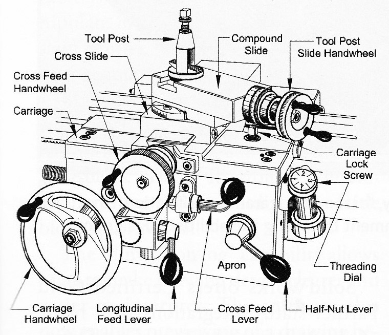

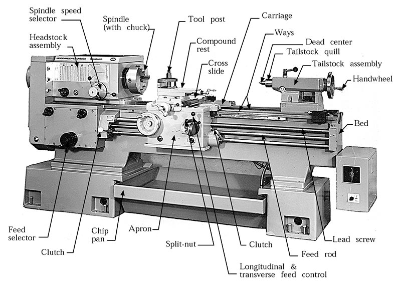

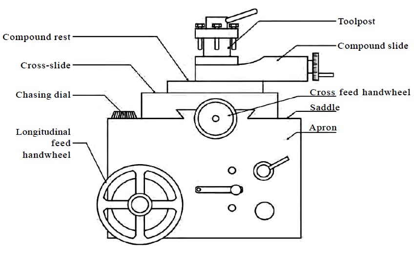

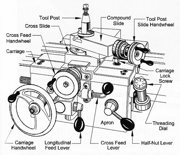

Usually the compound rest / compound slide is a weak point on the small lathes. Many people only use this for threading operations and leave it removed for other turning and especially for parting operations. A toolpost can be mounted directly to the cross slide. Here is a thread about this.
The cross slide gibs can be cleaned up / flattened and tightened and you shouldn’t have much issues here.
A ā€œcarriage lockā€ should be added if not already present to prevent movement of the carriage during part off operations.
With those changes, you should have no problems performing part off operations, assuming proper machining practice is being employed.
Could very well be that having no practical training there are things I simply do not know to do.
I researched exhaustively early on but of course the past few years there have been obstacles.
Never thought about removing the compound slide, much quicker to simply turn to a hack saw then clean up the part. Cheating, and more dangerous most likely.
