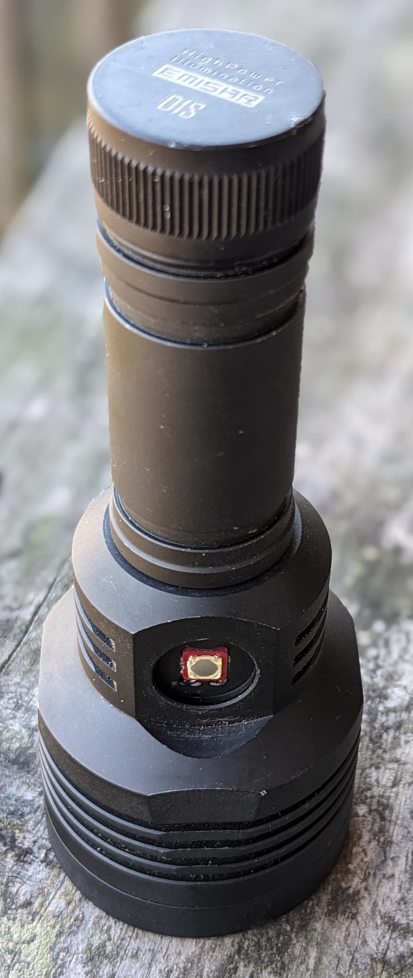

I am planning some mods for my old Emisar D1S:
  • raised switch ring (I already removed the old, flat, one, to make sure I would be able to)
  • new driver, with Anduril 2
  • aux emitters (I don’t know if I will actually be able to assemble those, but I have aquired a hotplate in order to try it :sweat_smile:)
  • new emitter, SFT-40 3000k (if they ever come back in stock)
I have a few questions, though:
  • Does anyone know if a lighted or RGB switch will fit into this host? I suspect maybe it wouldn’t, since the “1st gen D4” switch is listed separately, but I’m not sure.
  • Any advice on alternatives to the SFT-40 3000k? Obviously this is a subjective thing, but I just wondered if there are some other options I should consider. I do like warmer tints — not sure what other warm/high-CRI throw-ey emitters are out there.
That sounds like a fun project, I really like the D1S host but they’re so hard to get.
It works, though you will need to modify the switch hole with a dremel to fit the new switch. I have one that was upgraded by ArtieT59 with an SFT40 and an amber switch.
There’s a new customized emitter being sold by Fireflylite, it is 3500k, 95cri, and very rosy. 5050 footprint just like the SFT40, but a round die. It should be fine up to 5-6A, so make sure to get the right driver.
Another option is the Cree XP-P, it is available in 3000k 90cri and supposedly has decent tint, though the beam will be much narrower than SFT40, it’s not very bright but the die is very intense. You’ll also want the 5A driver for it, but if Hank has a 4A driver it’d be better.
Also, remember that Hank will sell nearly all parts to you if you ask, and then you don’t need to worry about being out of stock.
Thanks for the reply!
I see. I’ll probably wait and see if I can succeed in building the flex aux PCB that was mentioned — if I do, I will probably skip the lighted switch, but if not, perhaps I will go that route.
That may be interesting; thanks for the link. Would I be correct in thinking that if I were to use that LED, I should flash “nofet” firmware to a 5A driver? Or just be careful which battery I use, I suppose.
A related sanity check: if I do get an SFT-40, it would handle the 9A driver w/FET firmware, correct?
Yes, though Hank usually does that as well.
IIRC Hank ships SFT40 with the “8A” (actually 7.5A) driver, I would get that one, or just ask for the right driver for using an SFT40.
Very interesting! I’ve stopped tint-gambling on these mystery round die emitters but if these are actually supposed to be rosy I might just try them.
Edit: I just ordered five to try. I figure I had better order now before the r/flashlight users buy them all.
I’ve ordered 10, but they haven’t shipped yet. I don’t think they will run out instantly, since presumably the MOQ is a few reels they’ll have at least a few thousand emitters and reddit is still kind of wary of FFlite.
