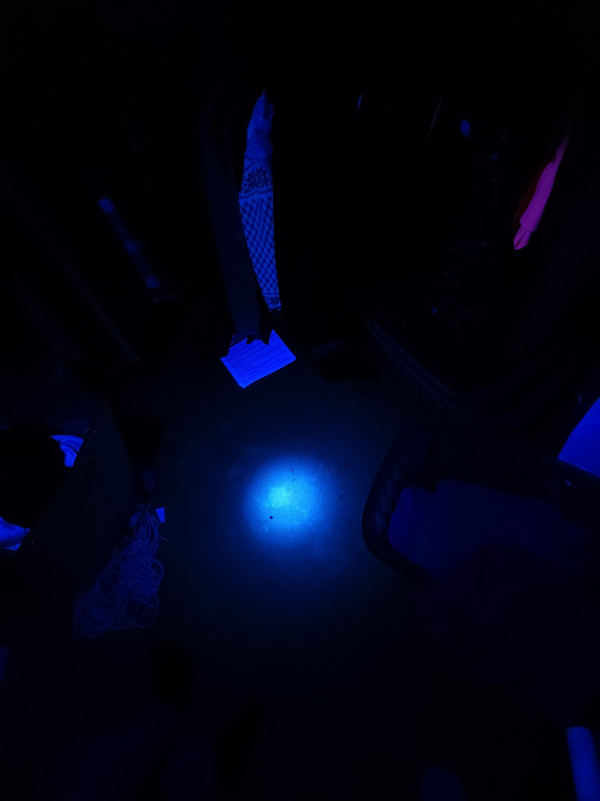

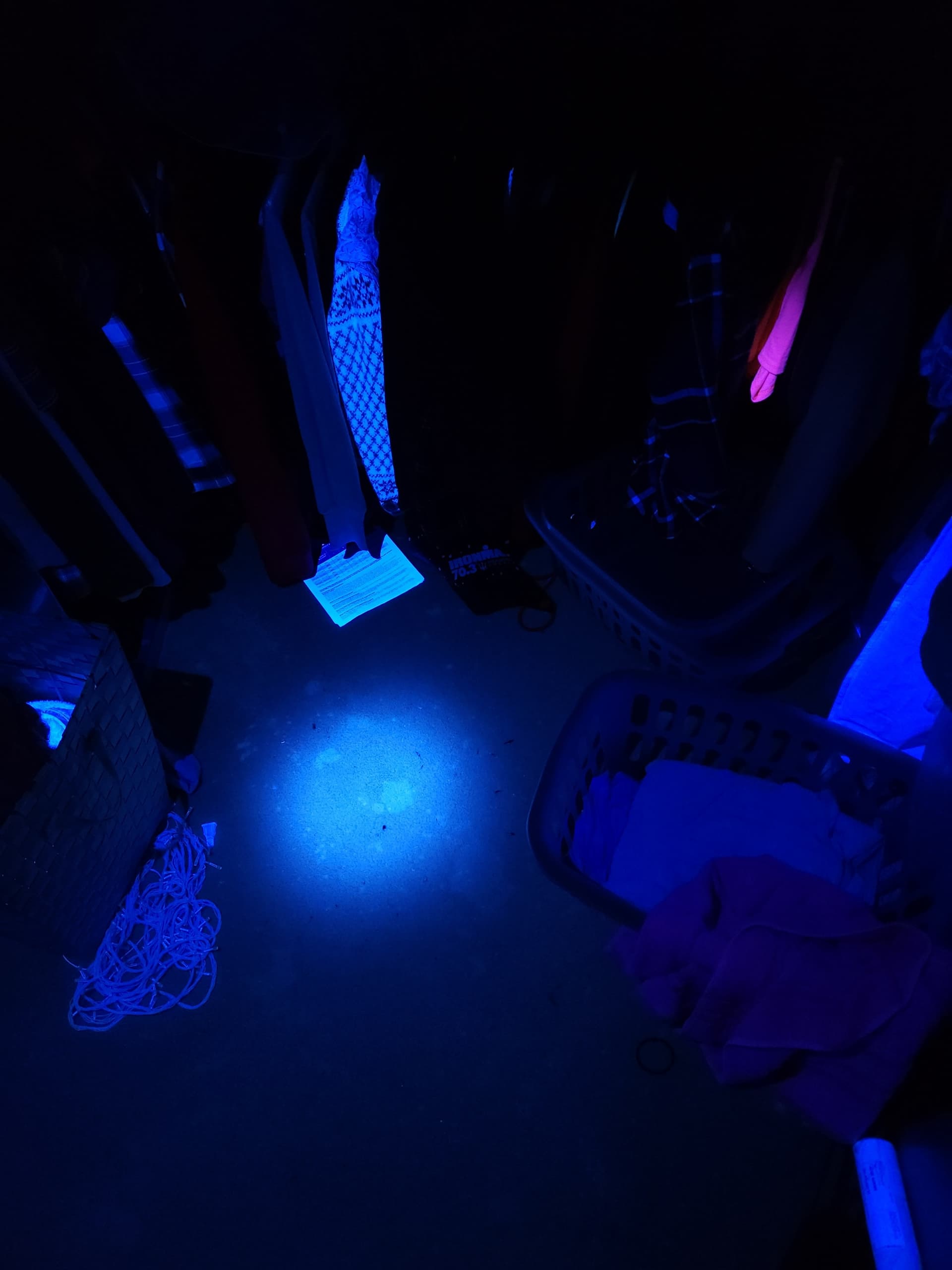

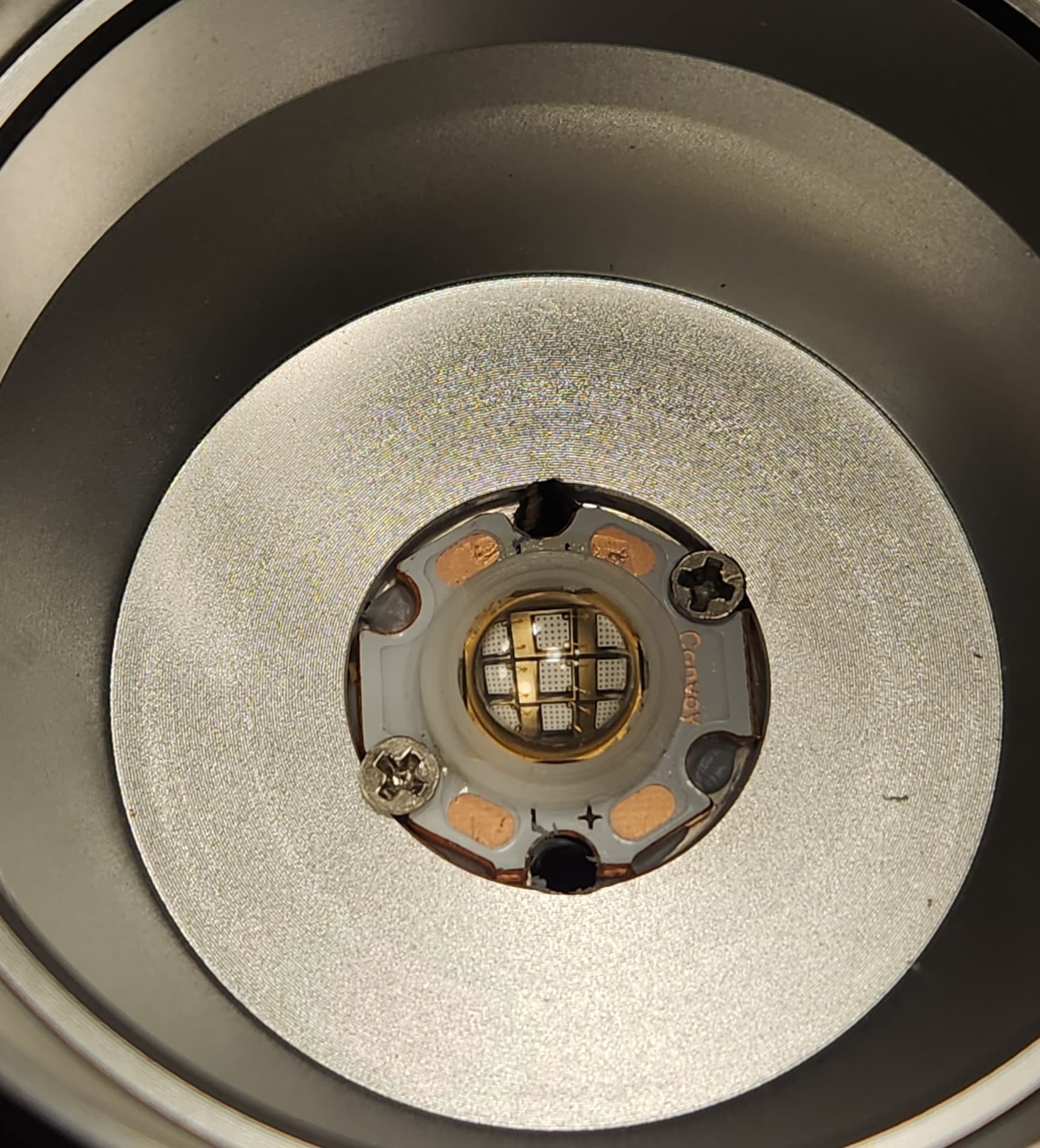

Turned a Convoy L6 gt-fc into a UV monster based on a build from Sakowuf from reddit. Start with Convoys 12v gtfc driver, replacing a sense resistor from r020 to r040. Sakowuf found some supplier that makes a 9die 9090 size 365nm emitter. You have to dremel out the 7070 gasket to sit lower around the 9090 emitter. The zwb2 lens was cut by Sakowuf to fit the L6. Has an OP reflector to even out the beam. Beam shot vs an emisar D1k 5w UV

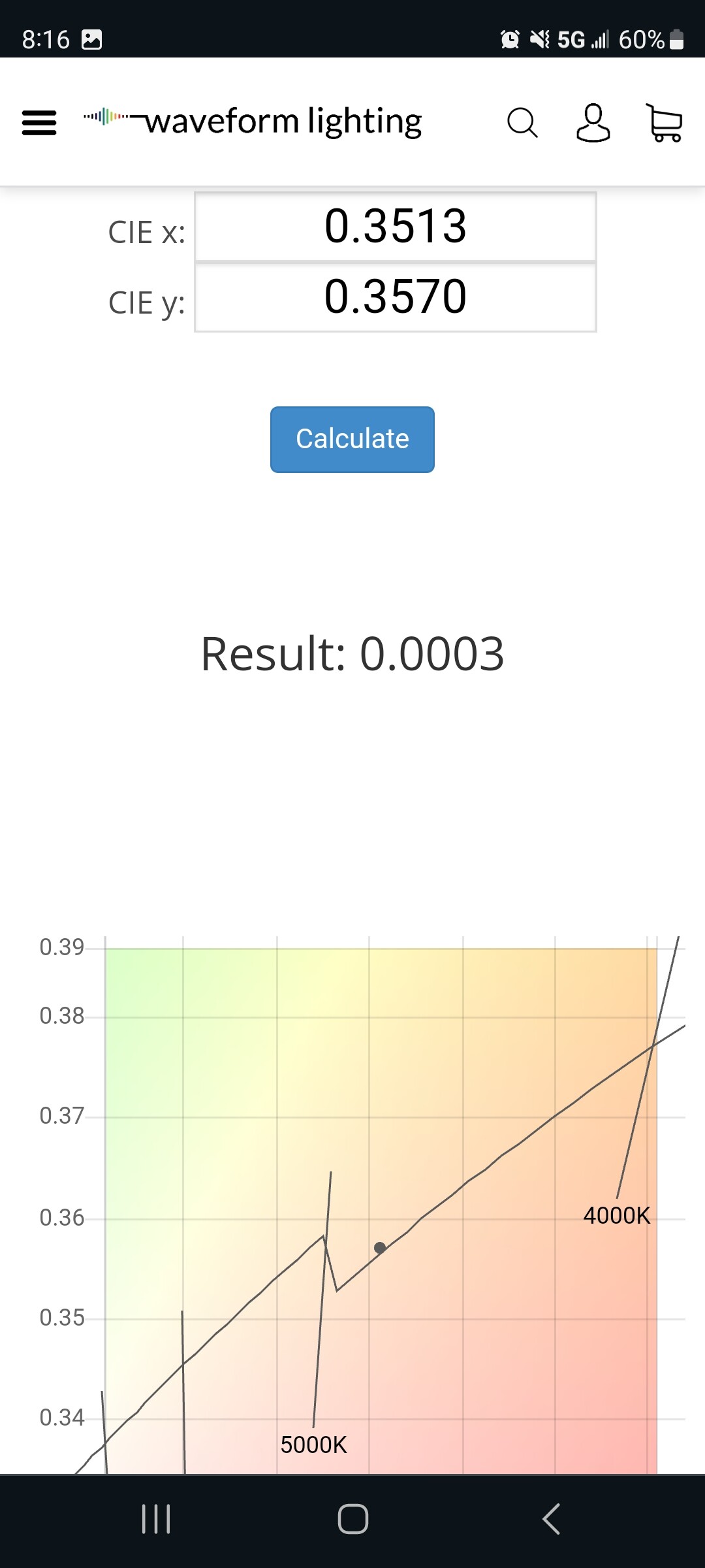

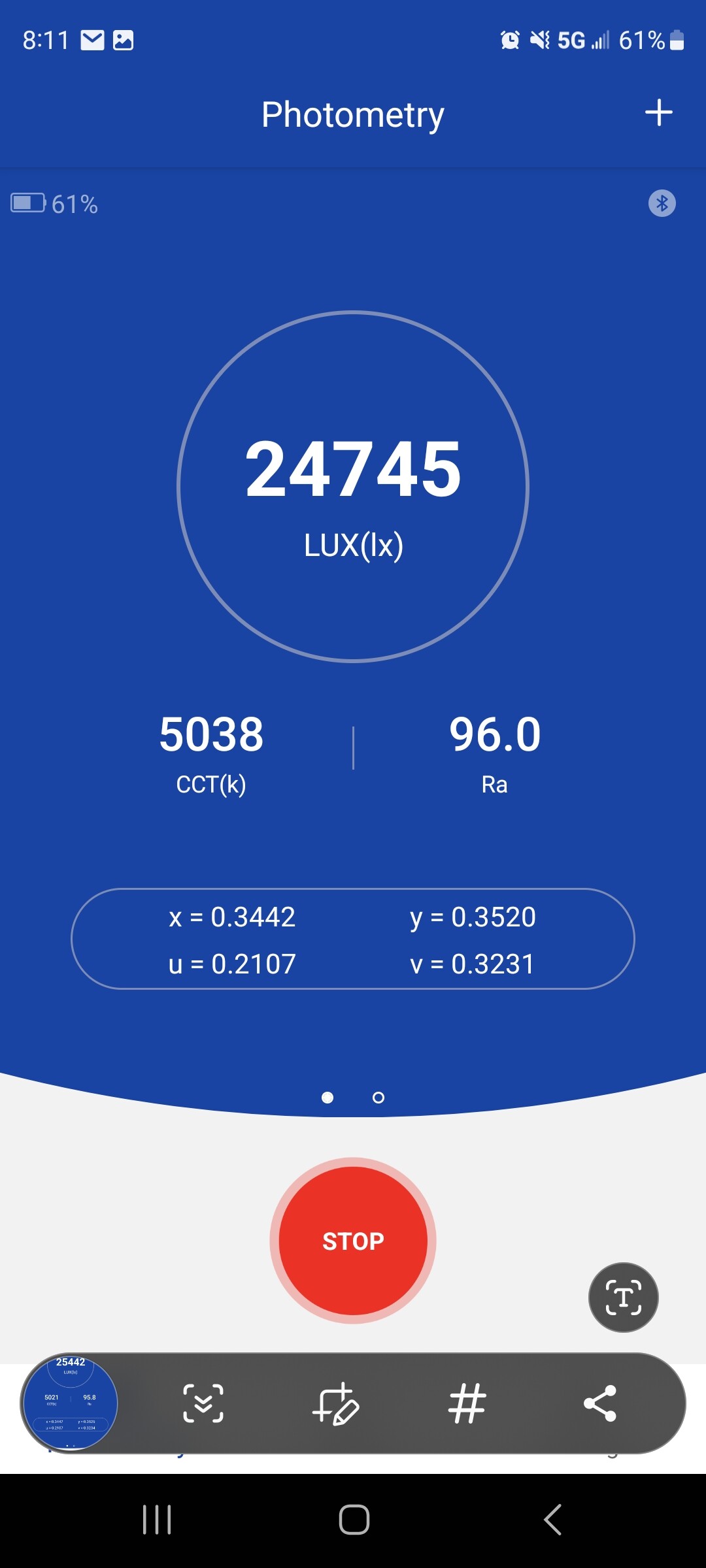

I decided to test my LH351D 5000K on my Opple:
Ceil:
Turbo:

I dont use turbo, I test at much lower outputs… about 40 lumens. which makes the tint much greener:
and some LEDs are greener than others:

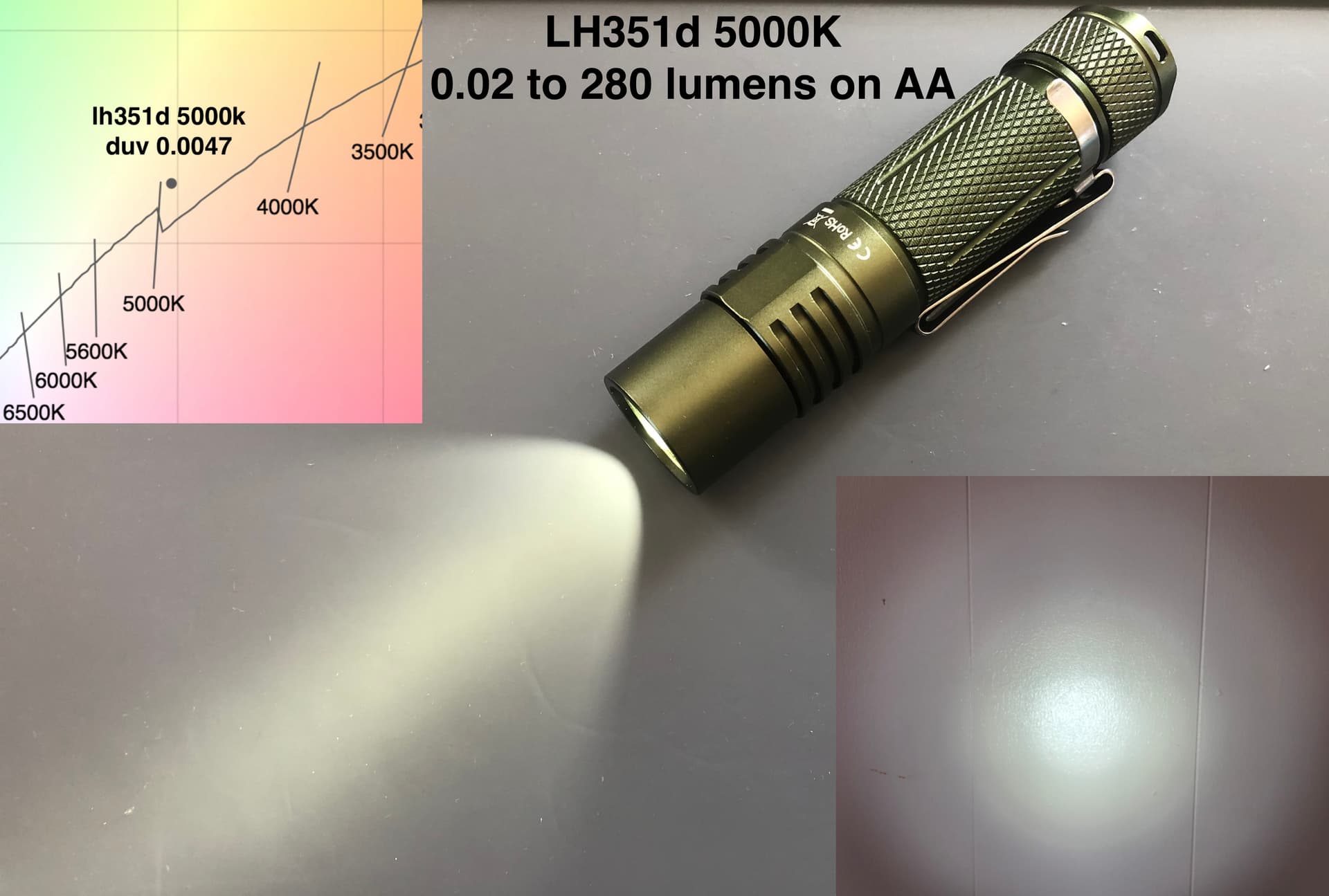

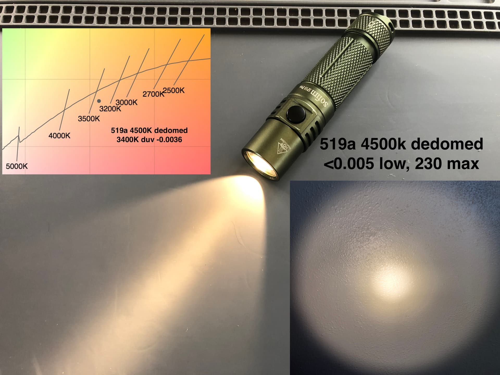

Dedomed 4500K 519a, LH351d 5000K:
imo the SC21 Pro has a better reflector than the SP10 Pro. Without the shadow around the corona, that we see in the SP10 Pro:
A bit off-topic, but where does the step/tooth around 5000K in the BBL line comes from?
Thanks a lot :slight_smile:
