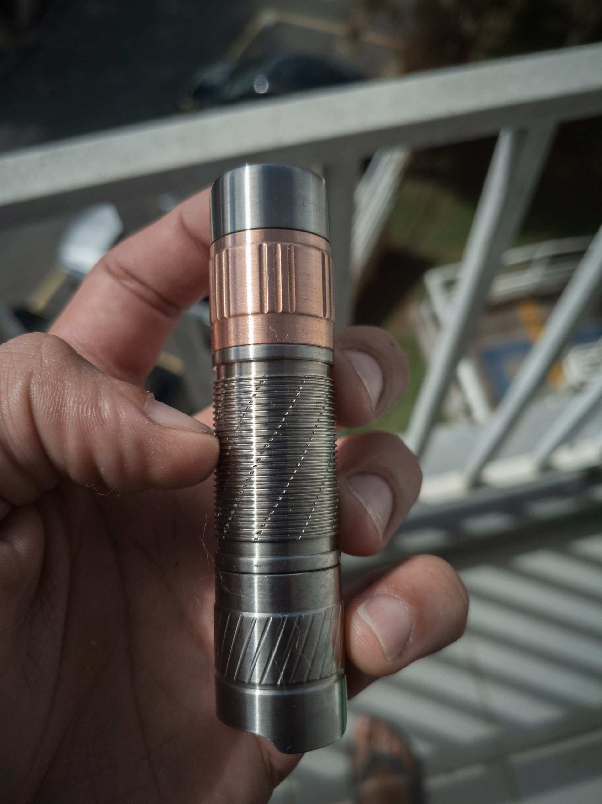

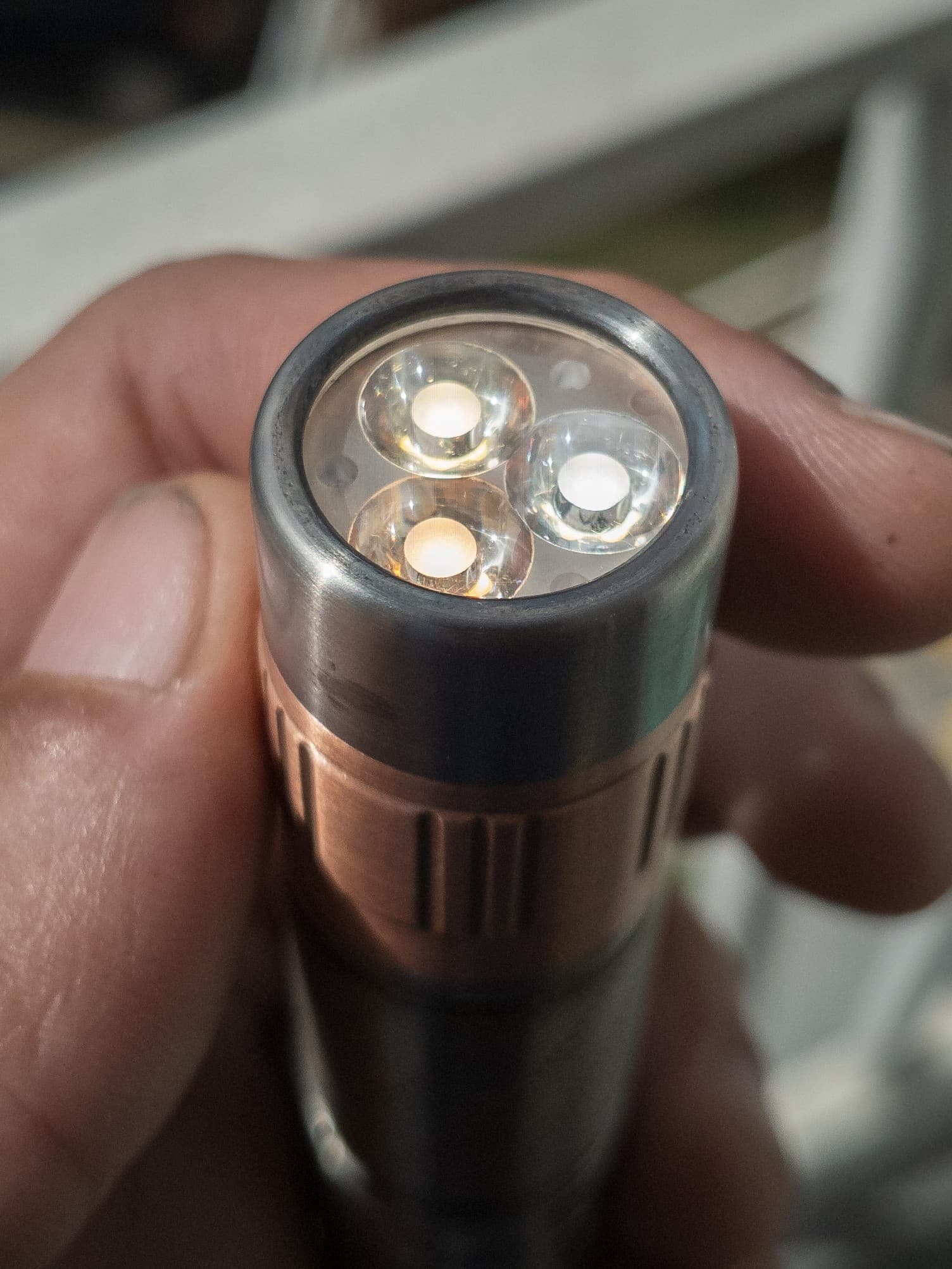

I used some spare parts that were lying around to assemble a TiCu Convoy T3. Wurkkos TS10 optics, PCB and bezel, with 3000K, 4000K and 5700K CSP2323, also from the TS10.
The 4000K came from the first Ti TS10, so they aren’t very great, but now the mixed tint is great, temp is about 4300K with neutral to slightly negative DUV. I used a chunk of copper made of 3x16mm (one of them was sanded to 14mm) MCPCBs to raise the triple LED PCB, which was also sanded to fit inside the T3 head. I’m using a 8x7135 driver, as the stock T3 driver output current was quite a bit low for this setup. No illuminated switch, yet.
8 Thanks
I like that setup with the TS10 triple.

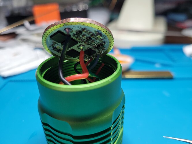

I fit a 9 Amp D4sV2 driver into a DM11 with a W2 green led…took a little sanding but got it to fit. Just wondering how long the W2 will hang with 9 amps before it gets crispy :crazy_face:

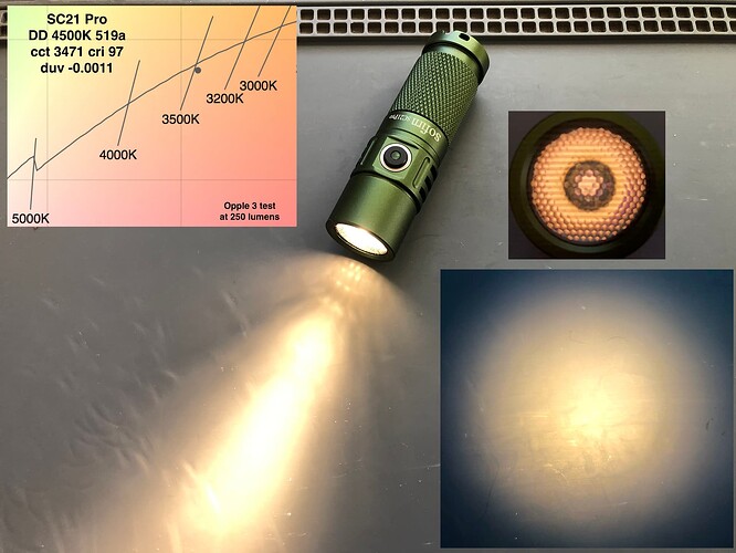

Sofirn SC21 Pro arrived, modded one immediately:
Installed a Pebbled Tir and reflashed firmware for lower lows
Popular mod

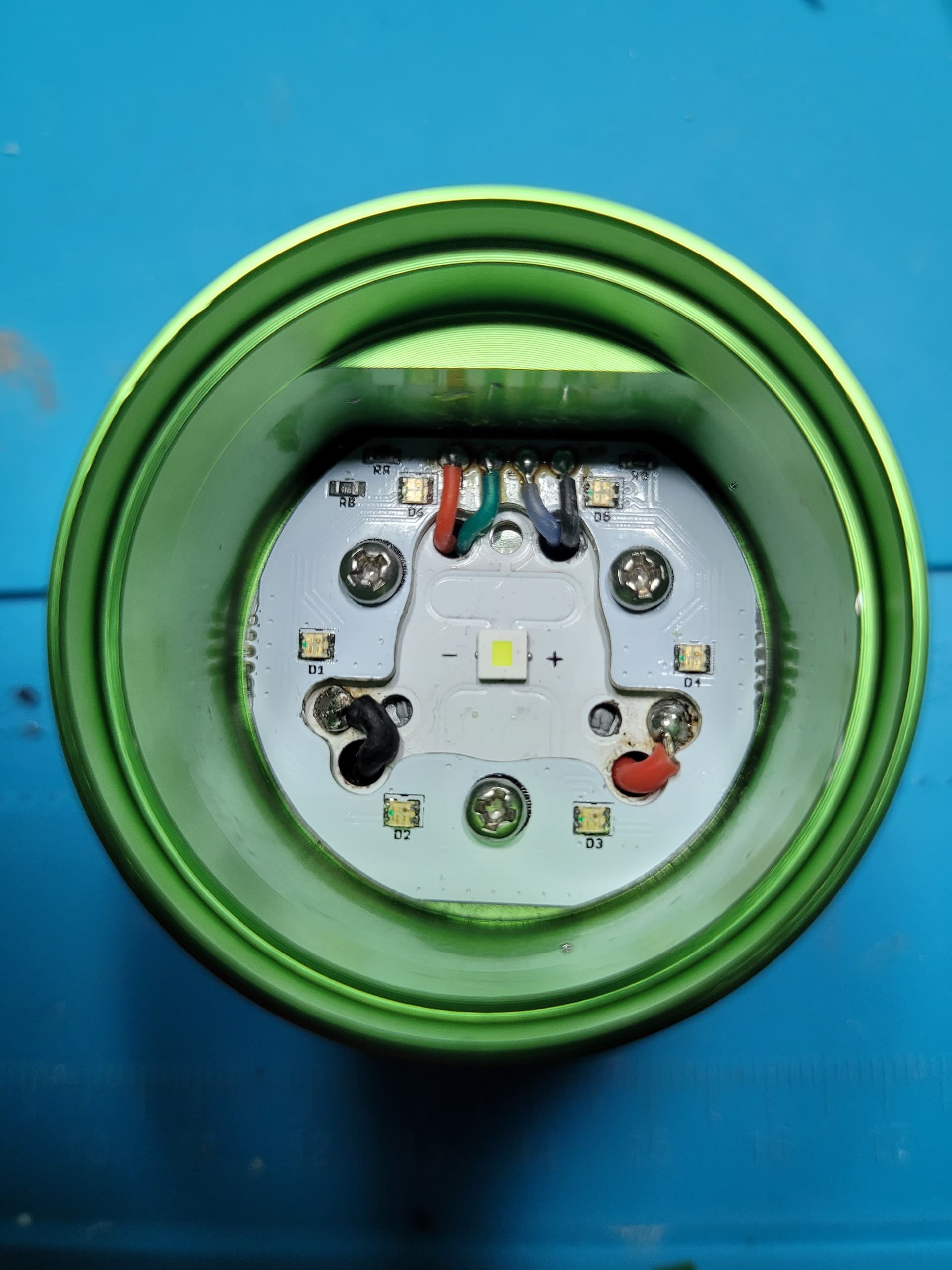

I recently received an Acebeam H16 headlamp.
The 5000k 519A had a CCT of 4800k and duv of about +0.0015.
After shave of 1.2mm, CCT was about 4575k with a slightly negative duv of -0.0015.

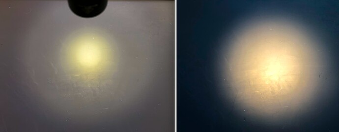

Nice, except the smooth reflector now generated a few artifacts around the hotspot.
Time for an old trick from my CPF and incandescent days… I lightly “sputtered” the reflector with some clear Krylon. Now beam is almost perfect. It is hard to get a good reflector picture. The texture isn’t as rough as this pic makes it seem. I find this to be an excellent way to lightly soften a beam when DC Fix is a bit more than you want.

Nice trick. I used DC fix when I dedomed mine but I do wonder if it’s a bit too disused for my liking.
lol, great minds :wink:

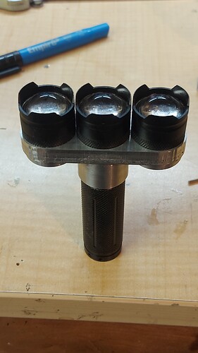

Part way through making a fixed focus light
19 Thanks
wtf did i just see
Old school… not so long ago, flashlight making.
Lol, that’s funny :grin: . Flashlight making is so old school that whipper snappers don’t know what they’re seeing … :crazy_face::upside_down_face:
