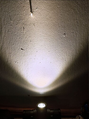

Running 12 amps through the SFT-40 makes it stupid bright it I’ve been trying to get a good beam shot but pics dont do it justice

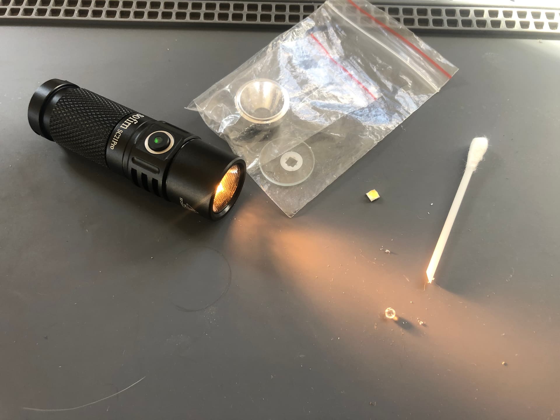

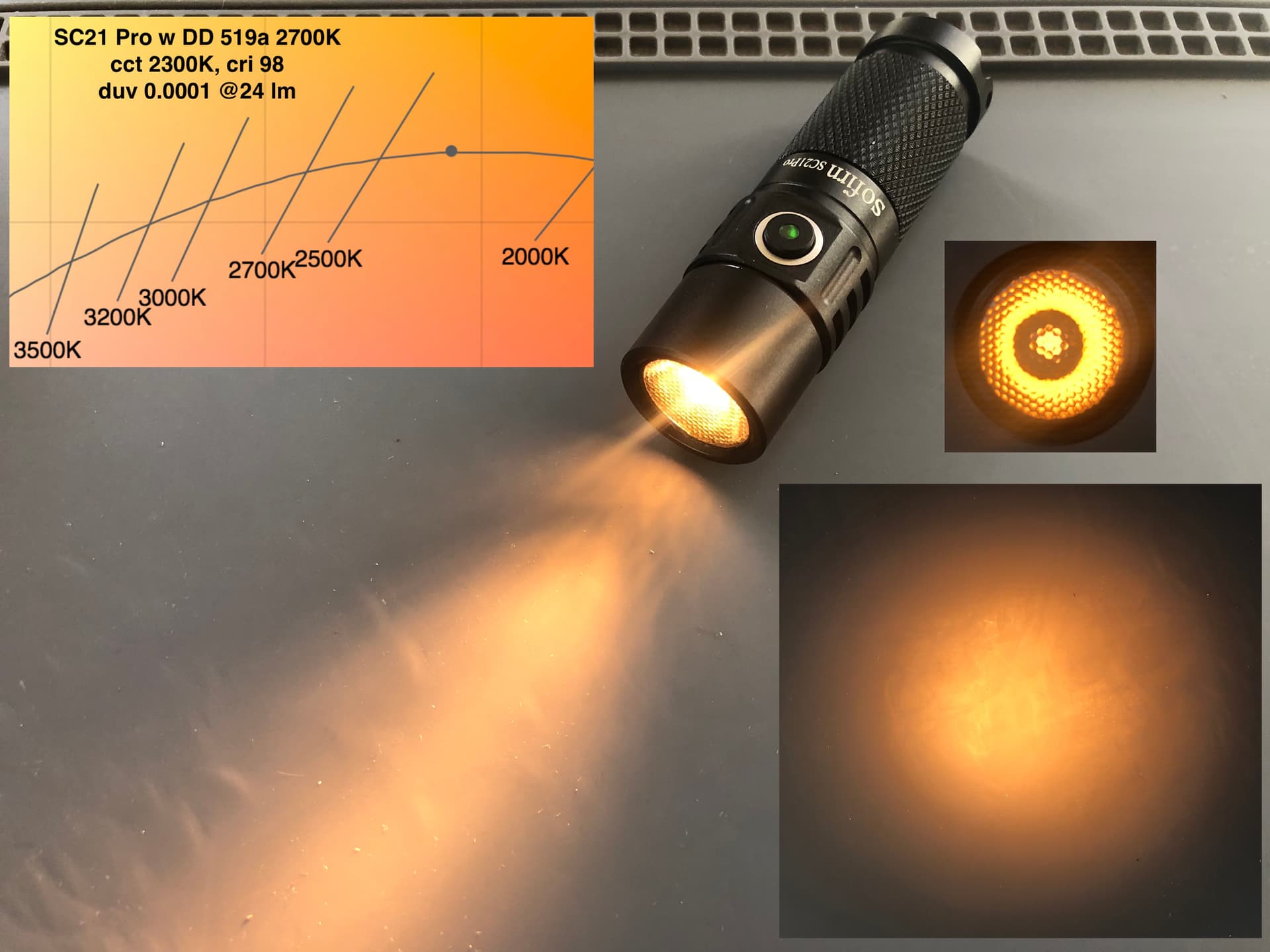

SC21 Pro, reflashed to have LVP on Aux and to have 0.02 lm lows, using 30 degree Tir:

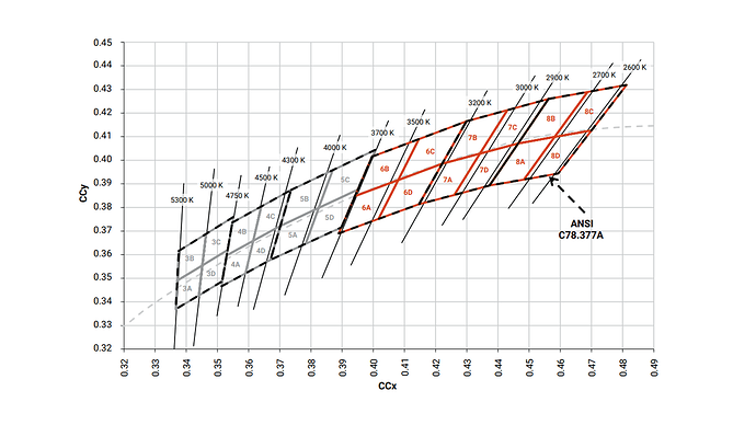

Convoy has 50.3 HI’s in 7A tint. I have one and it’s obviously below bbl.
They have 5D now too which should also be (edit:close to or) below bbl.
If only Simon had 4500K XHP50.3 and XHP70.3.
Which CCT?
3000k and 4000k

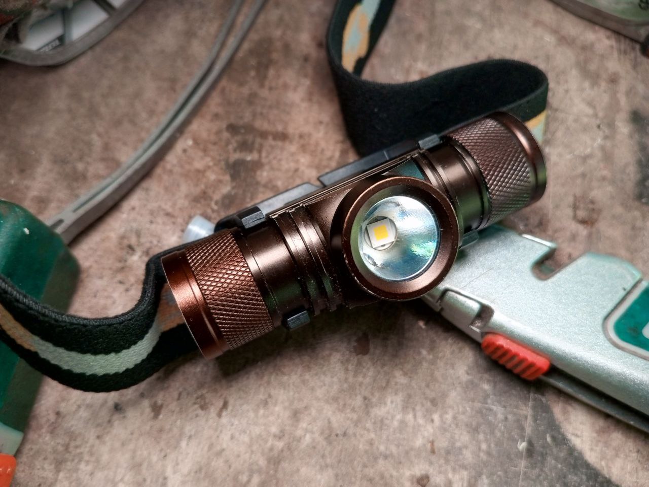

Boruit D10 is my favourite headlamp due to how cheap yet sturdy it is. It’s also very moddable, you do emitter swap very easily and with a little sanding, most 20mm TIR lenses can fit in the head.

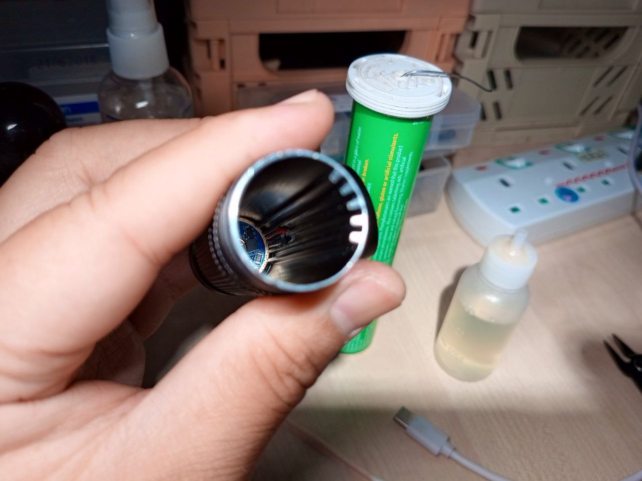

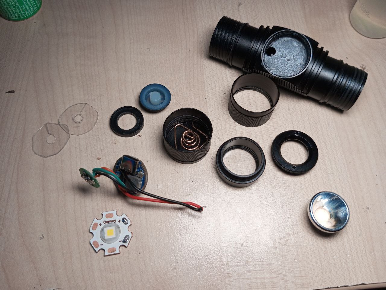

Gutted and stripped down, next to components ready for upgrade. (Note my super special customized plastic washers made from a soft drink bottle)
This particular driver only needs some minor filing around the side where you thread the wires through. I used a mini dremel with sanding head.
photo_2024-03-06_13-53-27

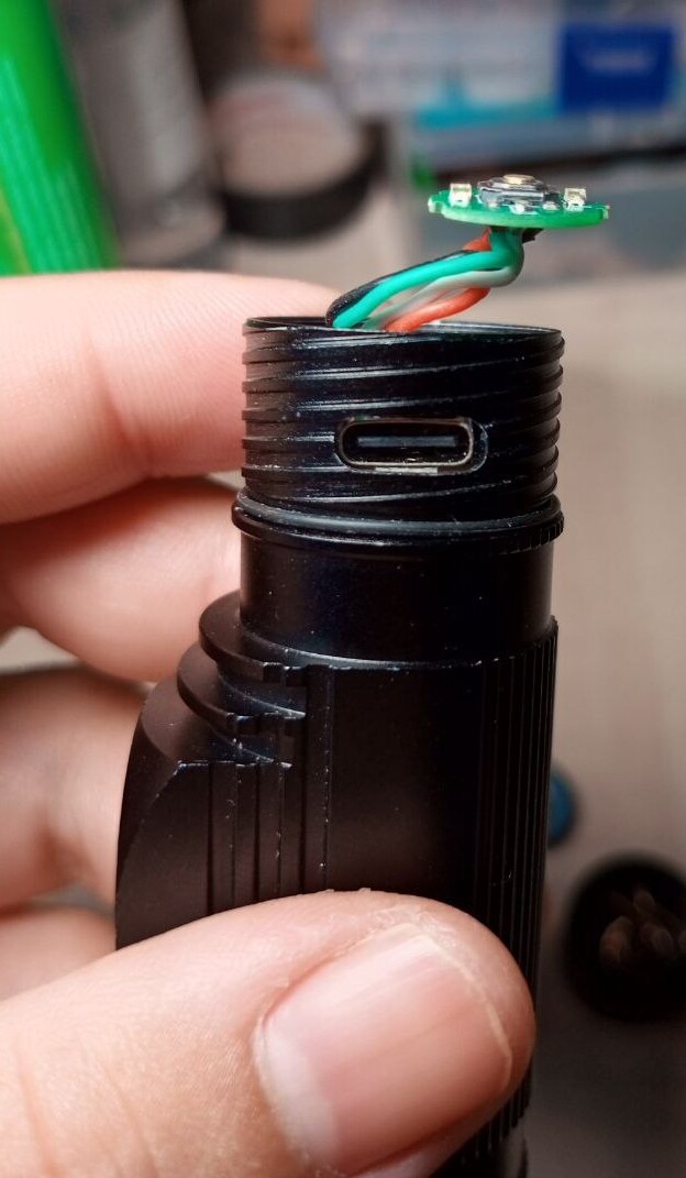

It’s a bit fiddly, but you need to thread the wires through those grooves, or else the battery won’t fit. Pic later of what I mean.

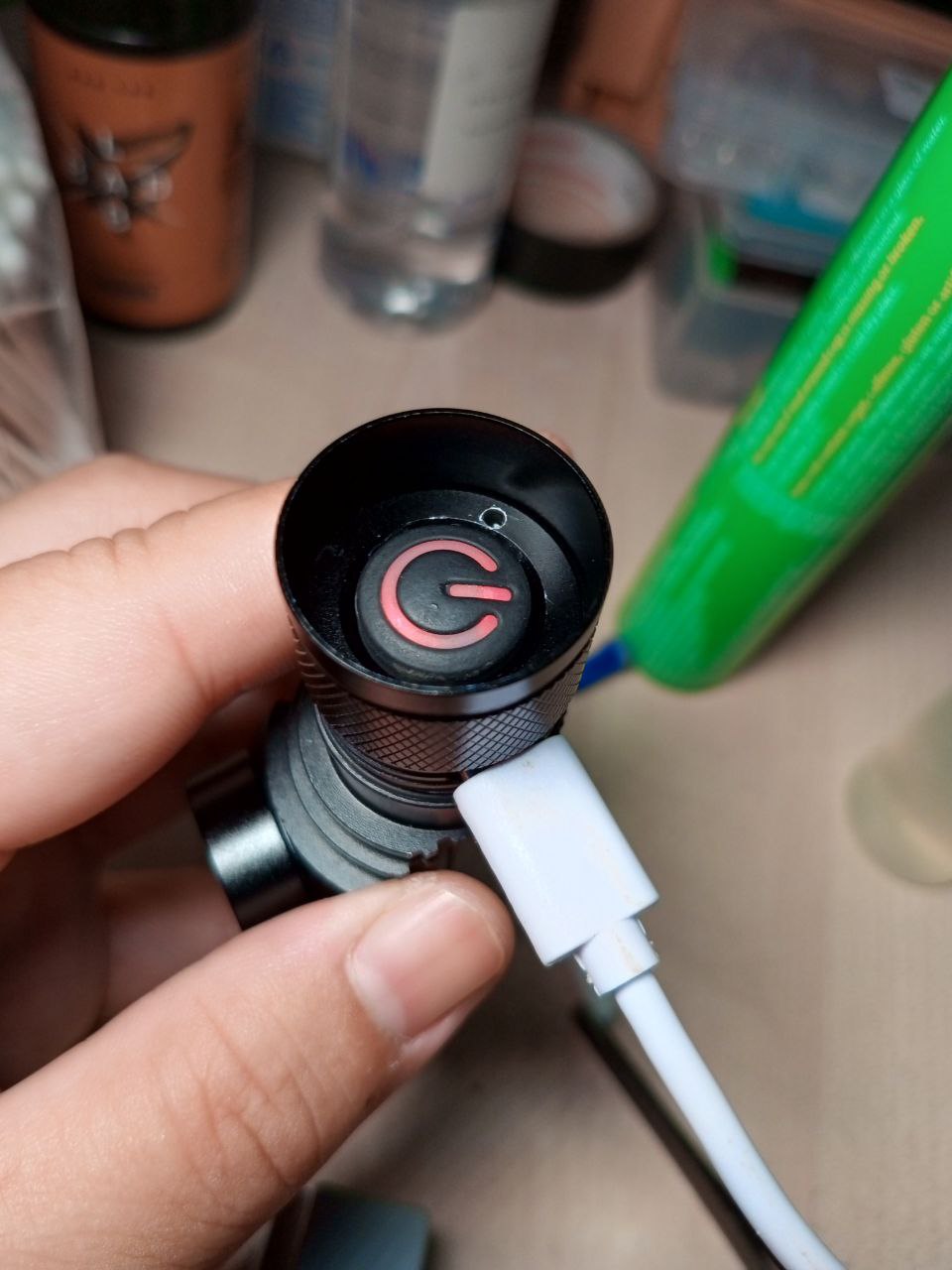

Installed correctly, the USB-C port should line up almost perfectly.
XHP50.3 HI 4000K R70 soldered in. Tint seems fine.
I accidentally destroyed the stock plastic spacer, but IDK if they would have worked anyway. So instead I made these from a plastic bottle.
Charging works. Not sure of the amps on the convoy charging unit.
A bit hard to see, but the wires are threaded down the trenches.

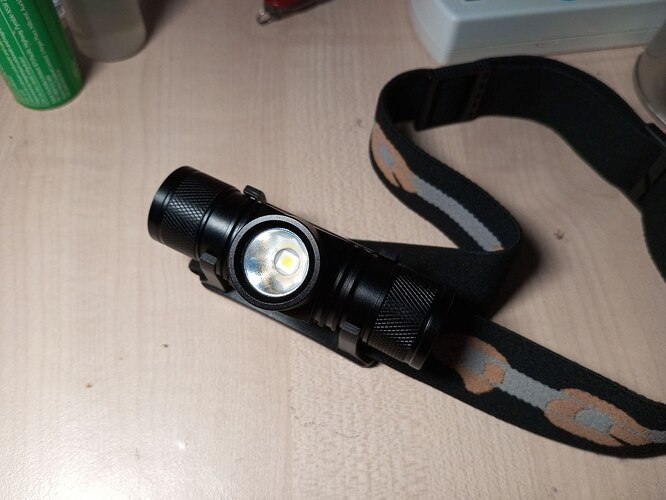

Fully assembled

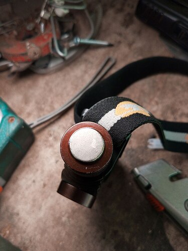

On my baked D10 I superglued a cheap flat magnet on the tailcap

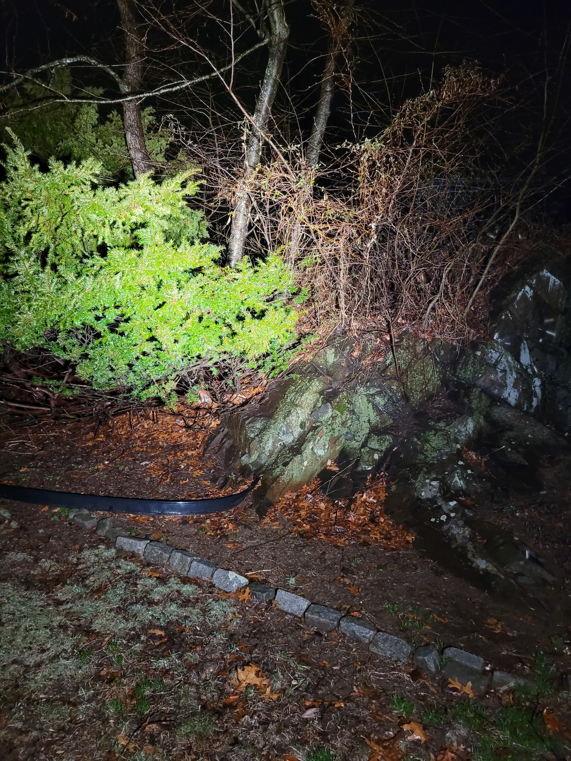

Beamshot of XHP50.3 HI 4000K R70 from Convoy. In reality it’s a bit warmer. But seems quite clean, not much visible green or shifting.

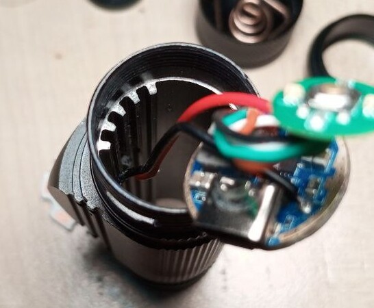

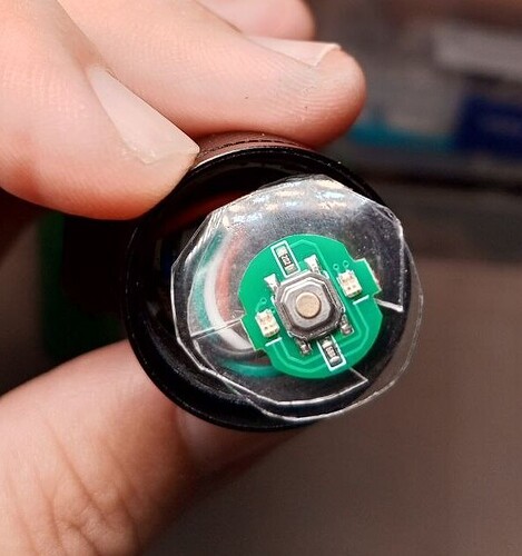

They recently changed the UI for the worse, with recent units of the D10. UI somehow has 1 second delay in all actions, whether changing modes, switching on/off, etc. Very bad. So I decided to try out the Convoy 6V3A e-switch driver (meant for S21E and H3 headlamp). Driver needs some filiing but actually the fit is quite good.
