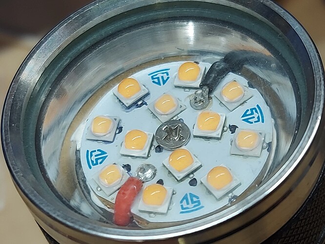

Today i finished refurbishing the host with a fet driver and heap of nichia’s (5x 3000k + 7x 3500k) to make a super mule
10 Thanks
I do like mules
I like the way you secured the mcpcb with the screw in the center. I had thought about picking one of those up, but didn’t like the idea of having nothing hold it down other than the thermal paste.
Yeh, holding down the board is a must. The host was already set up this way, though i did need to drill new holes through the shelf for the wires (OG ones were too close to centre).

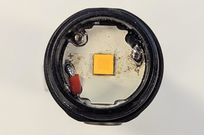

I had a little bit of a frustrating time emitter swapping a Sofrin Q8 Pro. The bezel wasn’t glued but hard to remove due to a tight oring and not much area to grab onto. I struggled for a few minutes trying to remove the reflector - no luck. I figured I’d take a look at the driver side. Two screws and the driver comes out. Then I found the secret, two screws on the driver side of the shelf go through the MCPCB and into the underside of the reflector. It came out easy after that. Pretty neat design, actually.
So I remove the stock LEDs. They weren’t horrible but I wanted something throwier and with better tint. I replaced them with XHP 50.3 hi 4000K R70. Get it back together. Click it on… but no light. Eventually I think to test the stock LEDs. Dang it Sofirn and your love of 3V XHP! Maybe I should have researched this…
I checked my spare LED supply and didn’t find anything I really wanted. So I figure I’ll try slicing the stock LEDs. Reflow them. First slice attempt and I pull up some phosphor.
I want to use this light in a week so I won’t have time to get new LEDs. I swap some LEDs around and I end up with four STF40: two 3000K and two 5000K. Reflow again, get it back together, and it works! The tint mix is very nice, probably similar to what I wanted with the XHP 4000K. I believe I’m getting around 140,000 cd. Stock was maybe 40,000 cd. I’m sure fewer lumens but more focused. This combo of reflector and LEDs does make a pretty pronounced flower petal in the beam, unfortunately. I don’t think I’ll mind in real use though.
