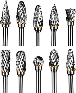

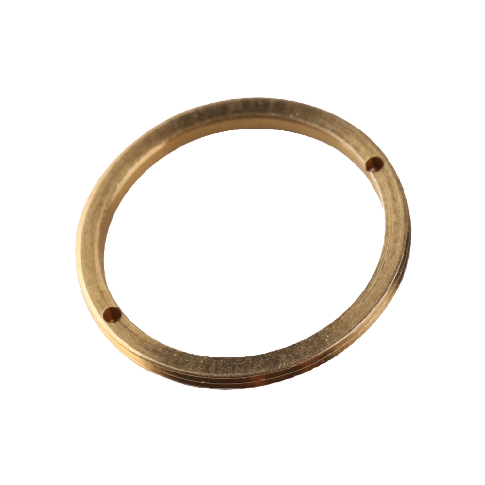

I tried to mod a Convoy S6 that had a linear 5a SFT40 to a 8a buck and SFT25R. The 8a driver has some components that touch the pill’s ring resulting in a short circuit. Tried to remove some material from the ring without success…what am I missing here? :thinking:
You probably need one of these:
You are my hero, thanks!
If you can’t wait. I had to use a rotary tool with a tungsten carbide bit to make it thinner, I spun it around in a circular pattern, you want to leave just enough material for the notches. it’s a tedious process, if you try with a hand filer eve more so. The thinner ones that convoy sells is what you want it to look like and what I’d get instead in the future
Thanks you for your suggestion!
