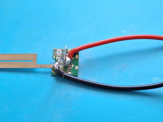

I recently purchased this cheap ‘Battery Capacity Tester’ when it was very cheap for € 4,08 (including shipping); partially out of curiousity but also discharge batteries that I want to get rid off as low as possible. (My current chargers with discharge function won’t go down to 2,5V and also almost all flashlights with LVP cut off above that.)
The annoying thing is that it only has a 18650 holder, while I also want to discharge (or maybe test) 21700 cells and also possible some smaller cells.
I still had a single bay ‘cheap’ charger I got with a Sofirn light (which supports up to unprotected 21700) with a micro-USB port, that I never used. I managed to crack it open without all too much damage.
I used my hot air soldering station to remove all SMD components, just to make sure that none of the components would interfere or act weird. I also used a Dremel tool to grind off some PCB traces (top and bottom), to give the + and - terminal a bit more seperation, since I would have no use for those traces anyway.
They don’t look pretty, but that was never the goal anyway.
I then soldered some 16AWG leads onto the postive and negative terminals. (I miscalculated a bit and they turned out a bit short, but in the end, they where still (just) long enough fortunately.)
Then I grinded some holes in the top of the battery holder/slot, to tightly fit the wires and feed them outside. (In the mean time I also installed the sliding negative tab and reconnected the spring.)
After that I soldered the wires onto the PCB, which has an extra open ‘+’ and ‘-’ hole on the top and bottom of the 18650 battery holder.
I temporarely taped the battery carrier/slot close, to test if everything worked well, before eventually glueing the battery holder shut again, with this being the end result:
It might not be the most accurate ‘capacity tester’, but that was never my goal. For now it will serve as a device to discharge batteries that I want to discard, to the lowest level I could, but since the termination voltage is selectable, it could also help to discharge cells to a proper storage level.
And instead of it only supporting 18650 batteries, it now supports 16340’s up to (unprotected) 21700 cells!

You don’t need those intelligent circuits to prepare a battery for disposal. All you need are alligator clips to attach a battery directly to the resistor which is 4 ohms (2×8 ohms in parallel). That’s exactly how this device does discharge testing, there’s no CC logic, at the begining the current is slightly higher than 1A (e.g. 4.16V ÷ 4R = 1.04A) and at the end it’s much lower (e.g. 2.6V ÷ 4R = 0.65A). So you don’t risk anything when attaching the battery directly to resistor and leaving it overnight.
EDIT: I think it’s a good idea to check the correct polarity on the resistor before doing the written above.

I know, it was basicly an impulse buy because it was so cheap now. The converted battery charger was just something ‘fun’ to do when I was bored.
So far I’ve not done much capacity testing with it. I only tested a 1000mA 14500 with it, which I tested two weeks ago on my Opus BT-C3100 (@ 500mA discharge) and had a 1037mA reading, even though the Opus terminates at 3,0V I believe. (My Opus might test a bit high on capacity, I think.)
On this tester I tested it down to 2,8V and it gave 974mA. So less than the Opus, but not sure which one is closer to the actual capacity.
This cheap tester is more of a novelty I think, also because you can’t select discharge current and also because it doesn’t do a Constant Current discharge, as @Qubeet stated a couple of posts above.
I would rather go for a decent charger with capacity testing build in, or, if you want a seperate/dedicated (and more versatile) capacity tester, go for something like the Atorch DL24, which can be found ‘relatively cheap’ on Aliexpress from time to time.
