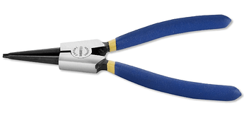

Could use external snap ring pliers
but yes, they can leave marks…

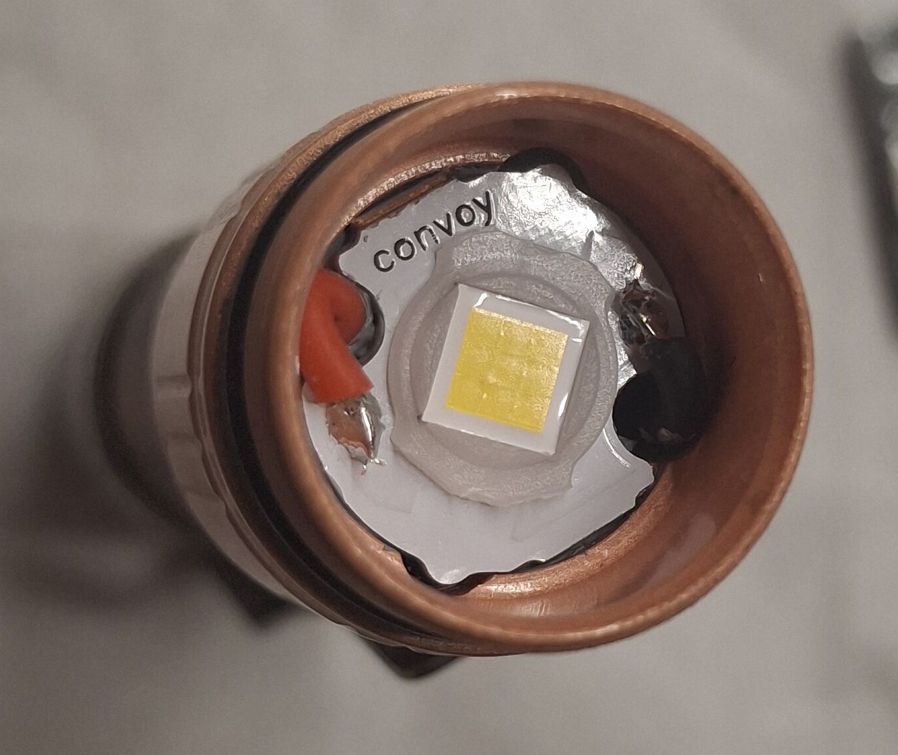

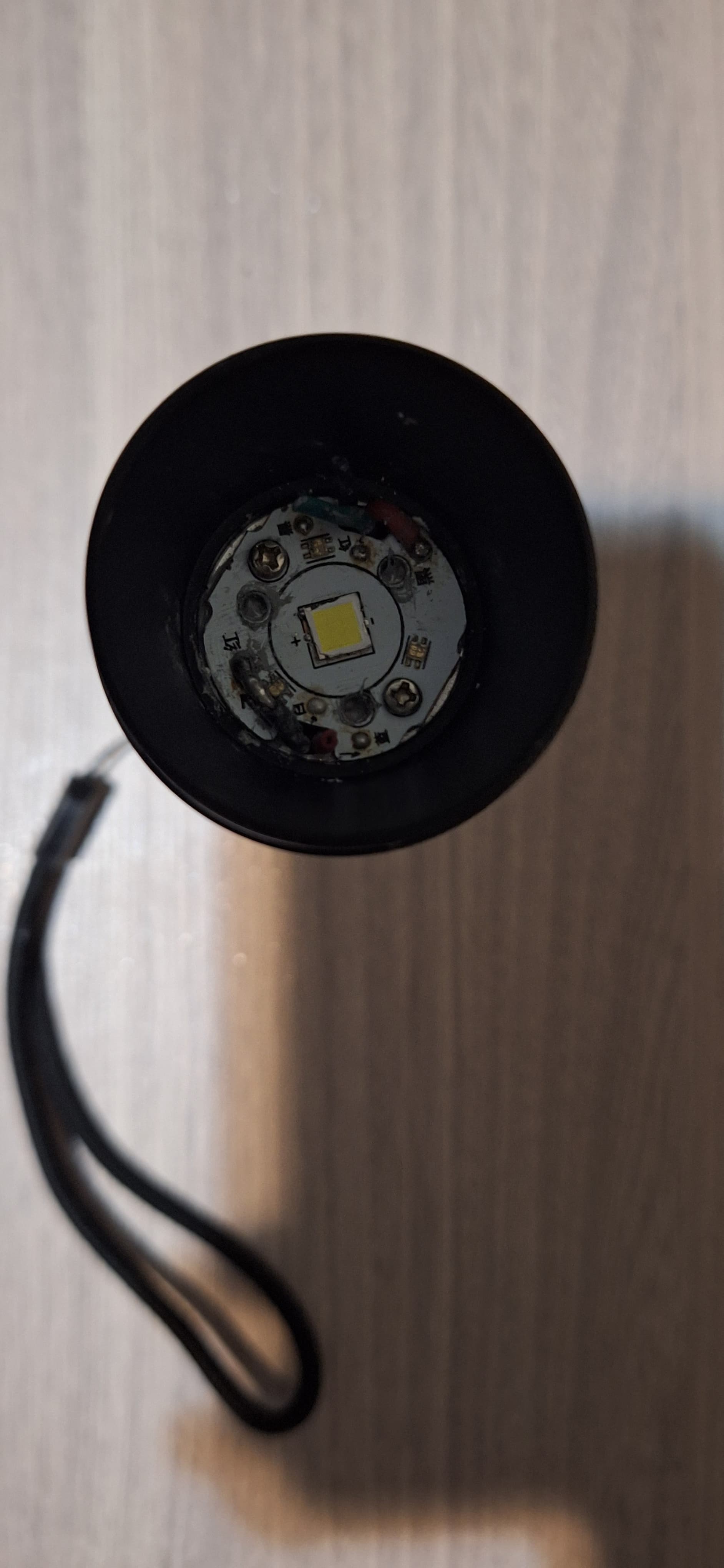

Mod #2
Convoy T3
SFT25R 5000K → LHP531 4000K
I tried Kaidomain’s 18x12.4mm SMO reflector with 7mm bottom hole but it produces a ton of rings. So settled on a TIR lens. Not the cleanest beam but it’s OK.
This flashlight is no longer a “thrower” and still it’s the throwiest among all of my 14500 lights (TS10, SP10, EC150, Pokelit AA)
7 Thanks

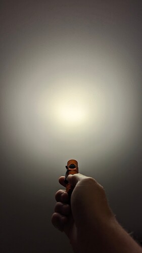

Turbo output (ceiling bounce test)
WK15’s output: Peak Sustained
XHP50.2 6500K (looked like 5700-6000) 229 66
LHP531 4000K 317 89
SFT40 5000K 152 n/a
Rosier than XHP50.3HI, as expected! And more output compared to XHP50.2, despite the lower CCT and better tint. I wonder how much is due to increased efficiency, and how much due to more current pulled by the lower Vf.

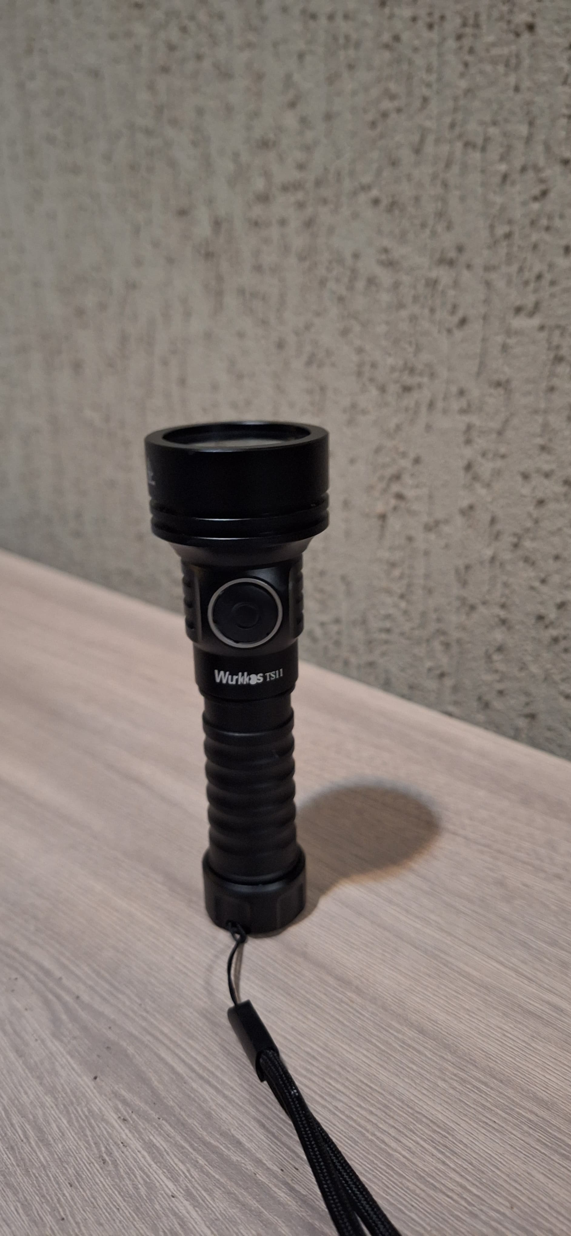

My Wurkkos TS11 now has a LHP531 6500k. Amazing beam! Throws about 480m.

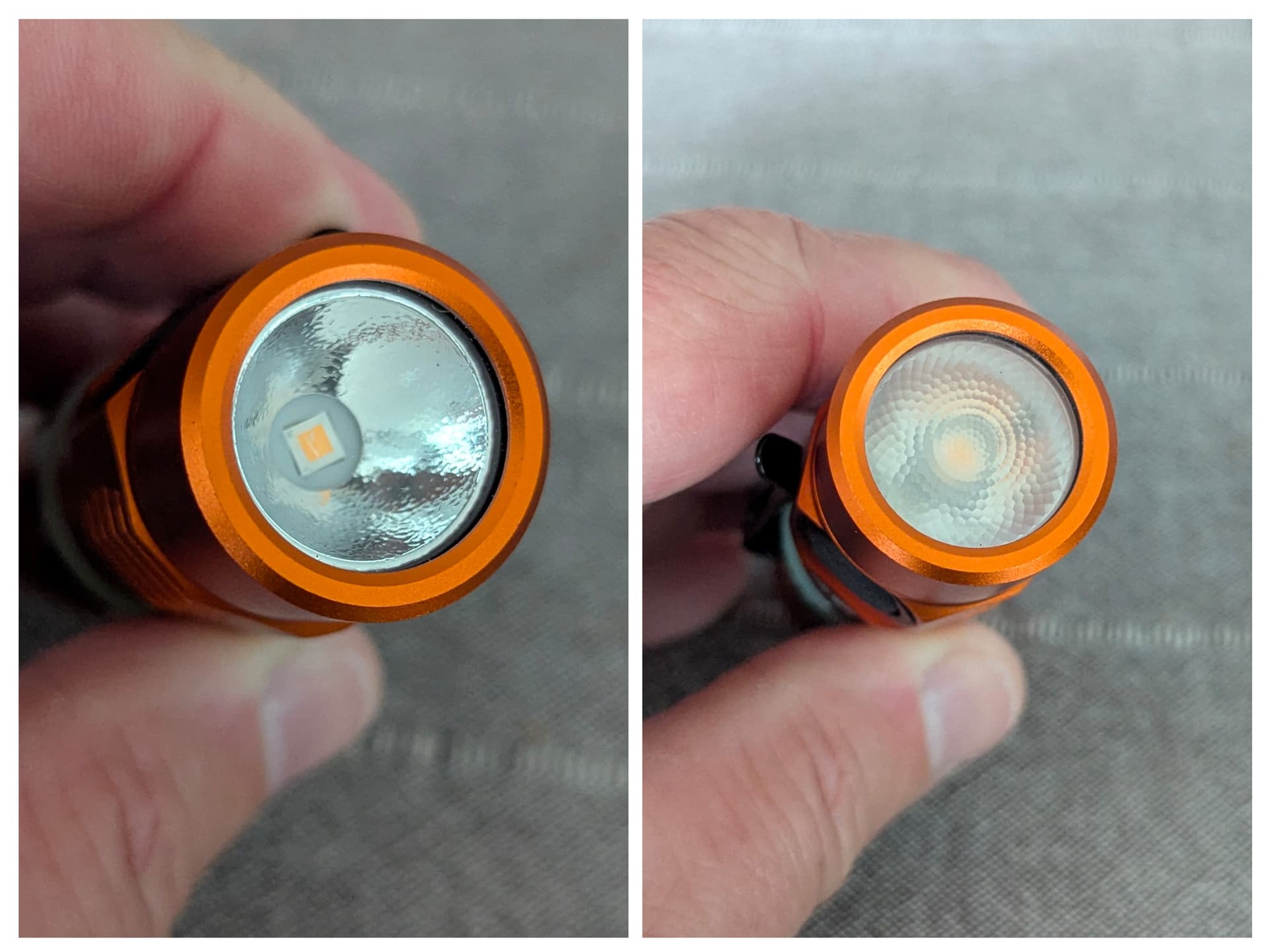

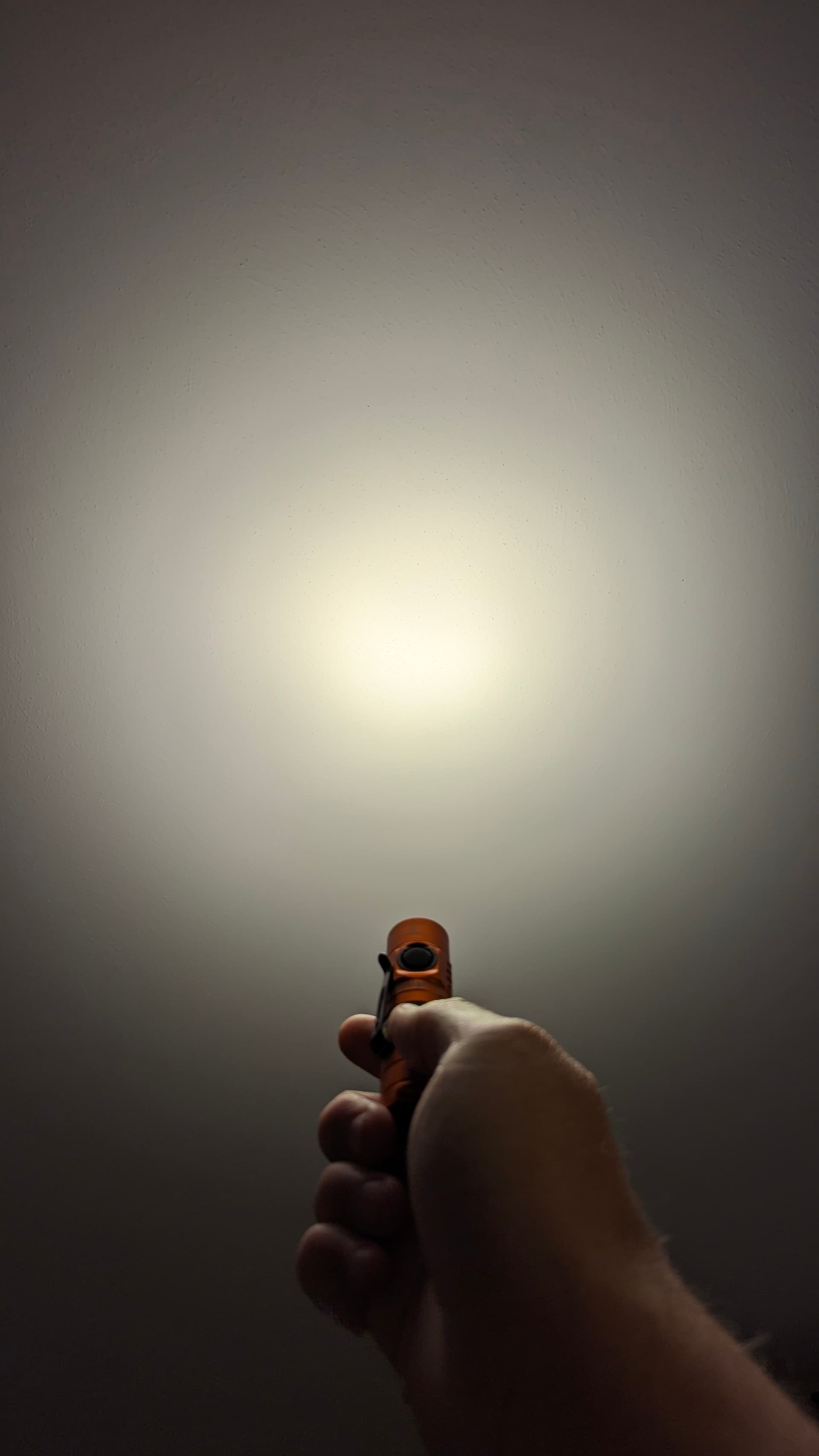

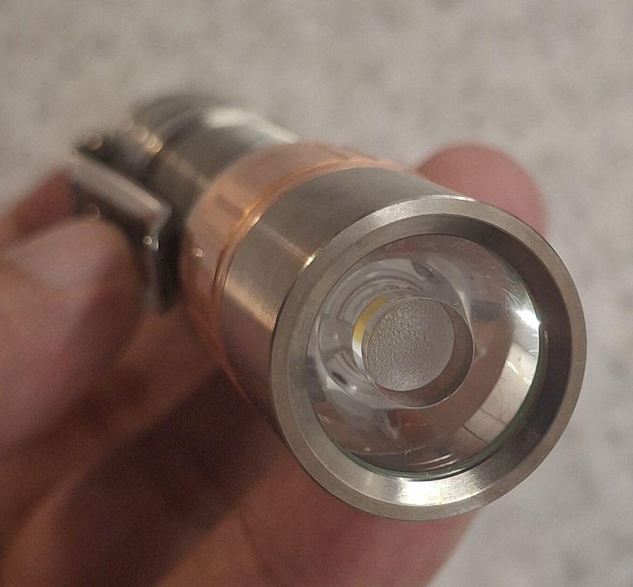

Another quick mod to my FC11C. Swapped the reflector for a beaded 15 degree 21mm Convoy TIR.
9 Thanks
This TIR looks really good! Was this flat, beaded, or matte?
Do you notice any artifacts due to the diffusion? I’ve found that Convoy’s hexagonal lattice beading causes a 6-pointed star beam shape.
Beaded 15 degree.
I’d say it looks really good! I’m happy with it
6 Thanks

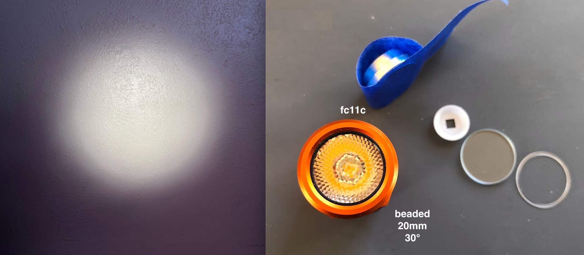

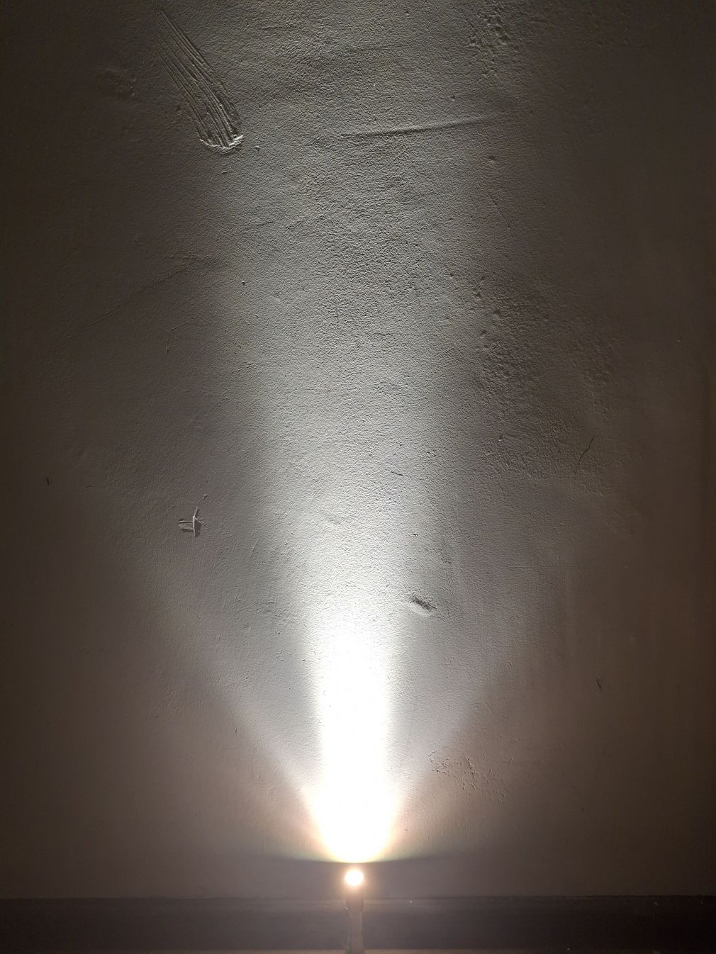

thanks for the beam pic, looks great!
Did you install the glass over the Tir?
this is a 30° 20mm Tir (does not come with a holder you need to remove from the 21mm Convoy)
pic shows I deleted 4 parts, including glass, when I installed the Tir…
I left the glass. But sanded down the bottom of the optics a little bit to make it fit. Only needed like 1mm sanded off to make it work.
thanks for the info… makes sense, the glass is 1mm thick…

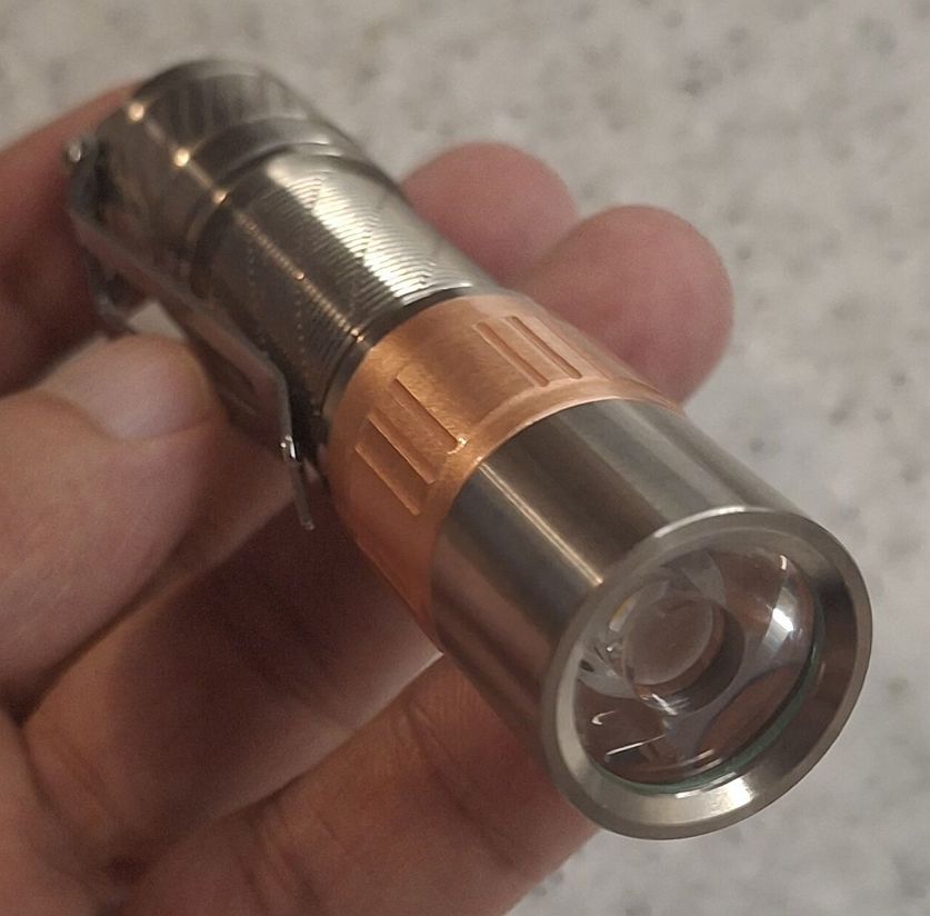

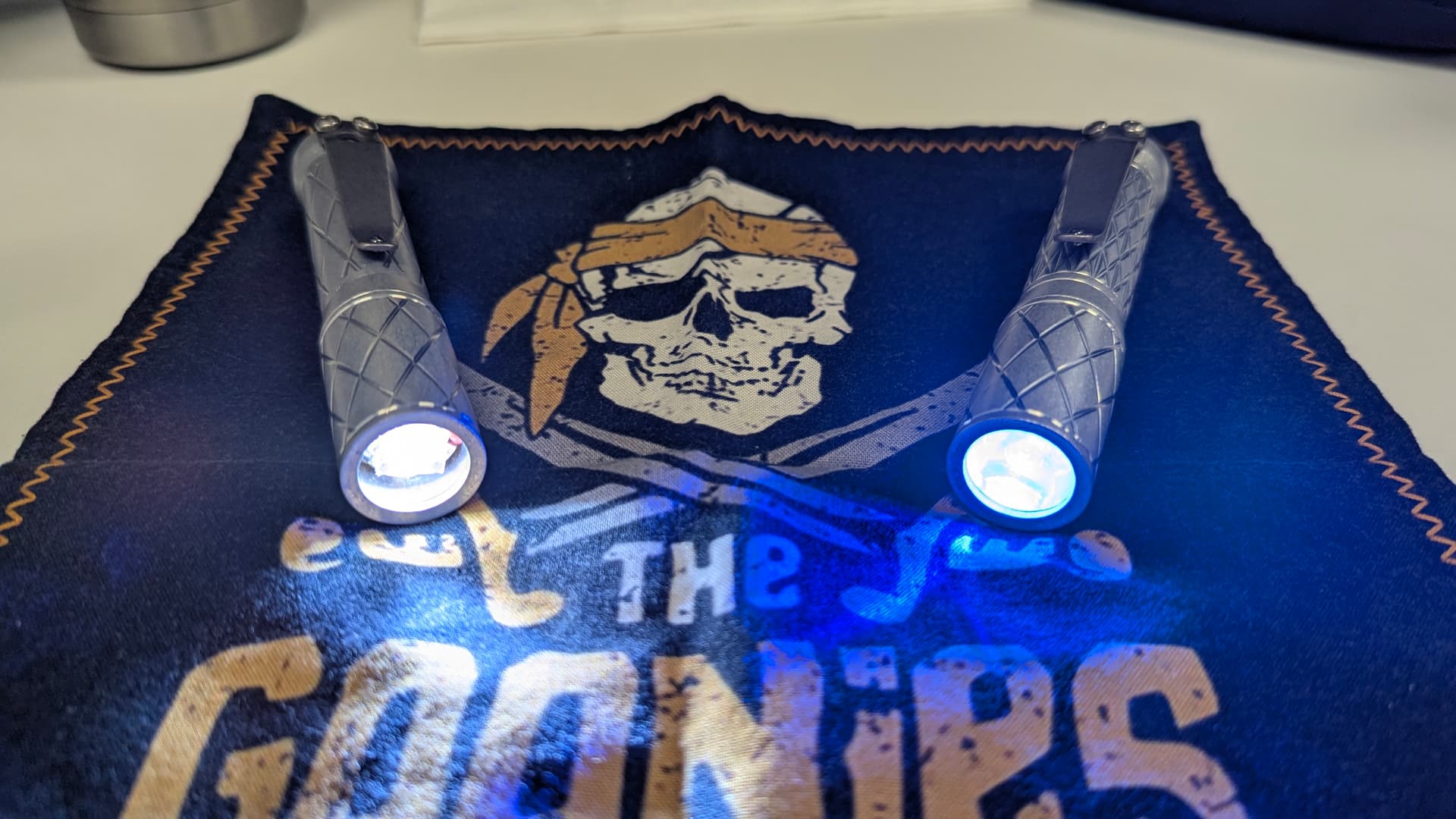

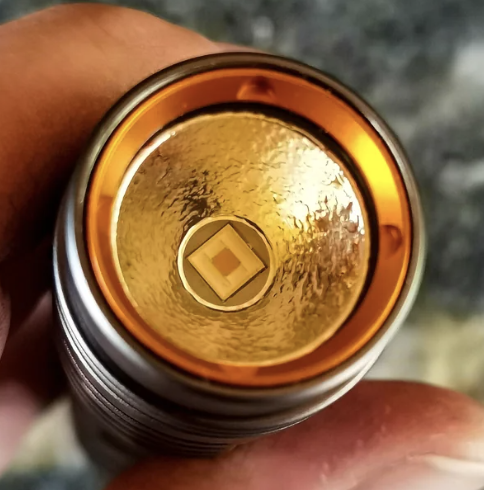

Modded another Dawson Diamond Slim. 2 channel custom mcpcb. This one is set up for throw and mule/flood. But it could really be set up any number of ways. FFL’s 351A 3700k and 350RD 6500k
