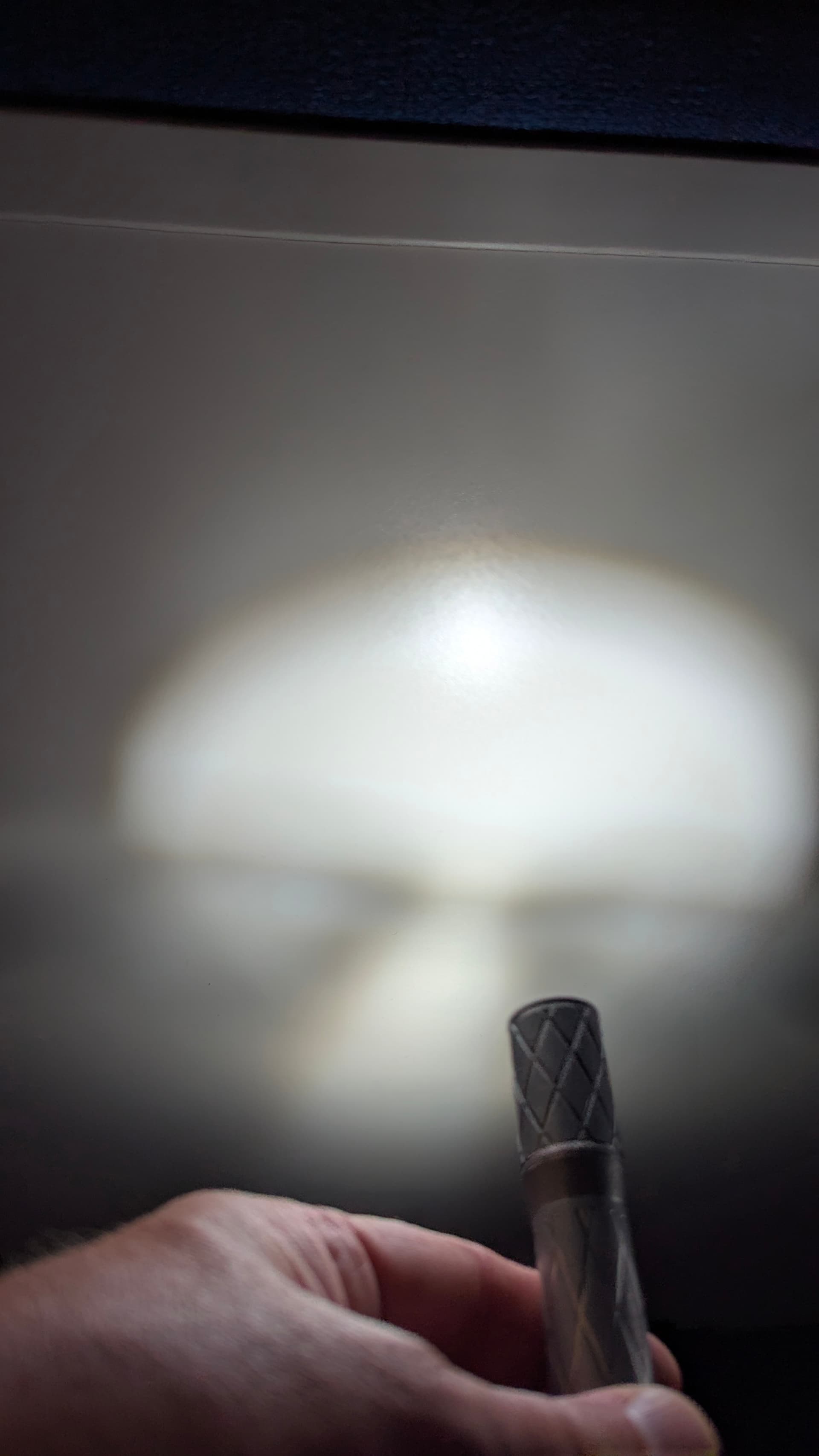

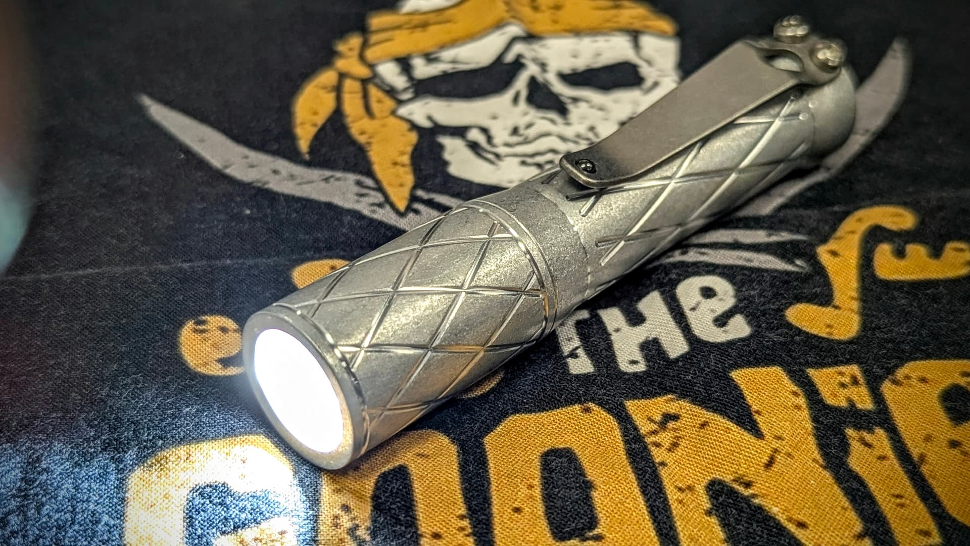

This is such a a cool, asymmetric configuration! I originally thought you cut off one optic from a Carclo quad, until I saw the legs.
Wonder how the beam is from the mule. I’d worry that a lot of the light might be obstructed by the TIR and the interior surface of the flashlight head.
It does get obstructed by both. It’s still enough light to compensate. And it looks like a mushroom cloud. LOL!
But you really only notice up close. It’ll still easily light up a room.
Love that Argyle pattern!

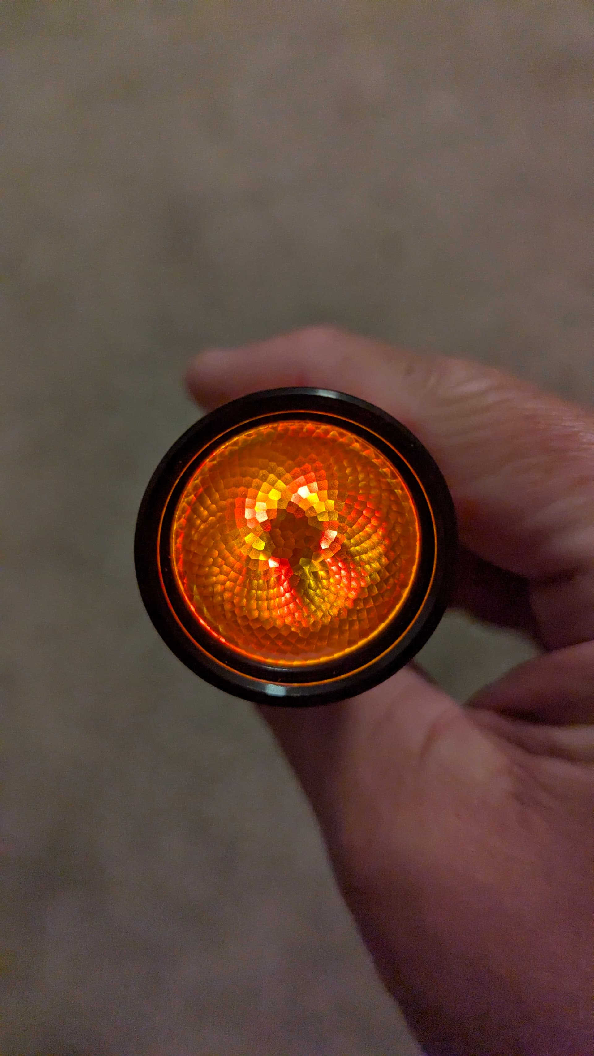

Because I like modding this platform D1/D1K/KR1. Another modded D1K. This time I went with NTG50 1800k and yellow/orange/red aux lights. Looks like fire!
9 Thanks

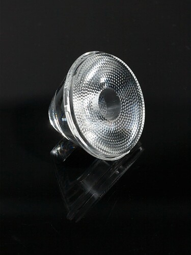

What TIR did you use, and did you have to make any other modifications to fit the TIR?
It’s a Ledil Olga-S TiR. I had to put an o-ring around the top of the optics to fill the small gap between the optics and lens. That’s it!
Thank you!
That looks like an Olga-M to me. Olga-S looks like this:
Valid!
I had put the S in a different light. Oops! I may still change it out in this light. I like it better.

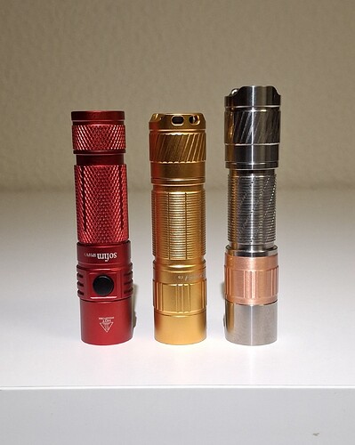

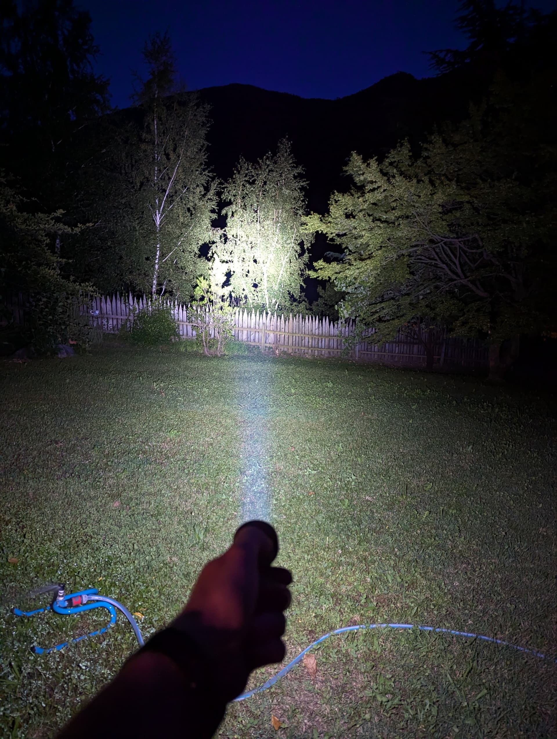

@mcjtom something you might like, I put a SFT-40 3000K in my IF19 instead of the original SST-40.

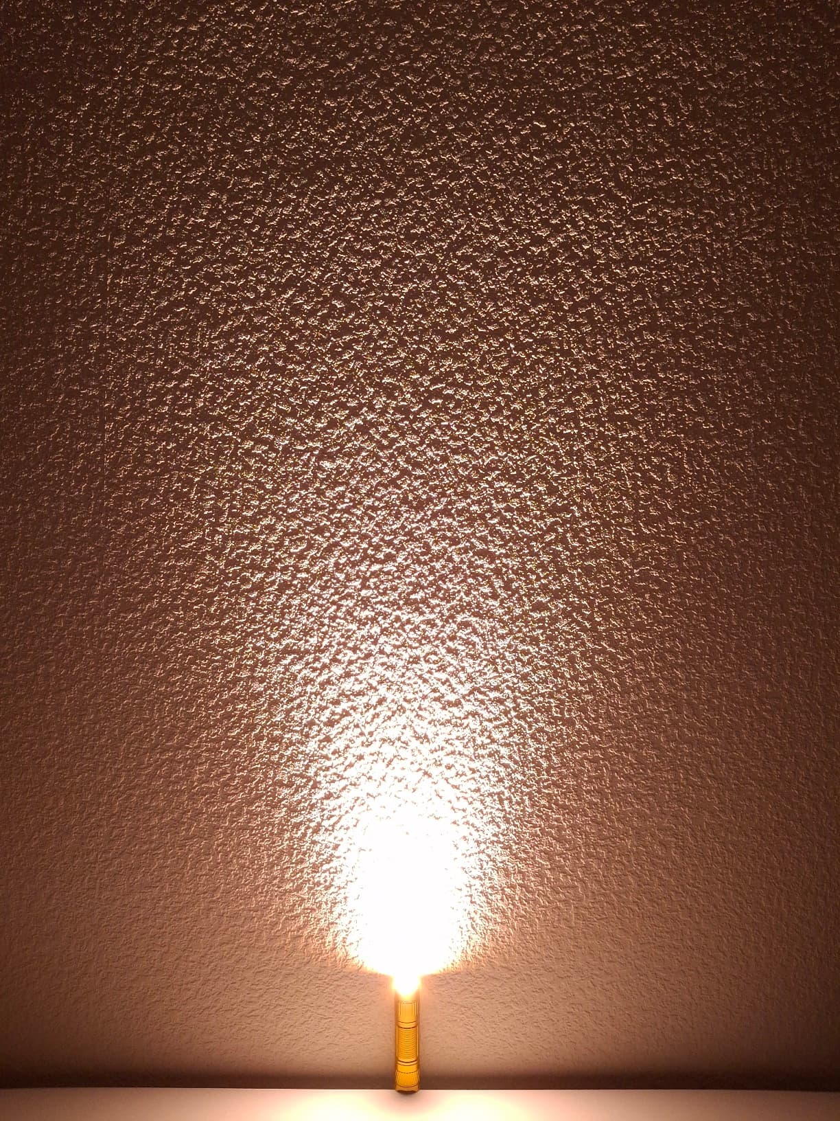

Beamshot comparison (warning, just a phone pic and not necessarily at the same settings):
And my usual 2 pictures, wine cellar indoor and wineyard outdoor. The light got crazy throwy not, with a tiny spot, and a much dimmer (but still wide) flood. Quite interesting beam profile overall.
8 Thanks
Designing drivers by day and illuminating vinyards by night, you’ve got it made :ok_hand::ok_hand::ok_hand:

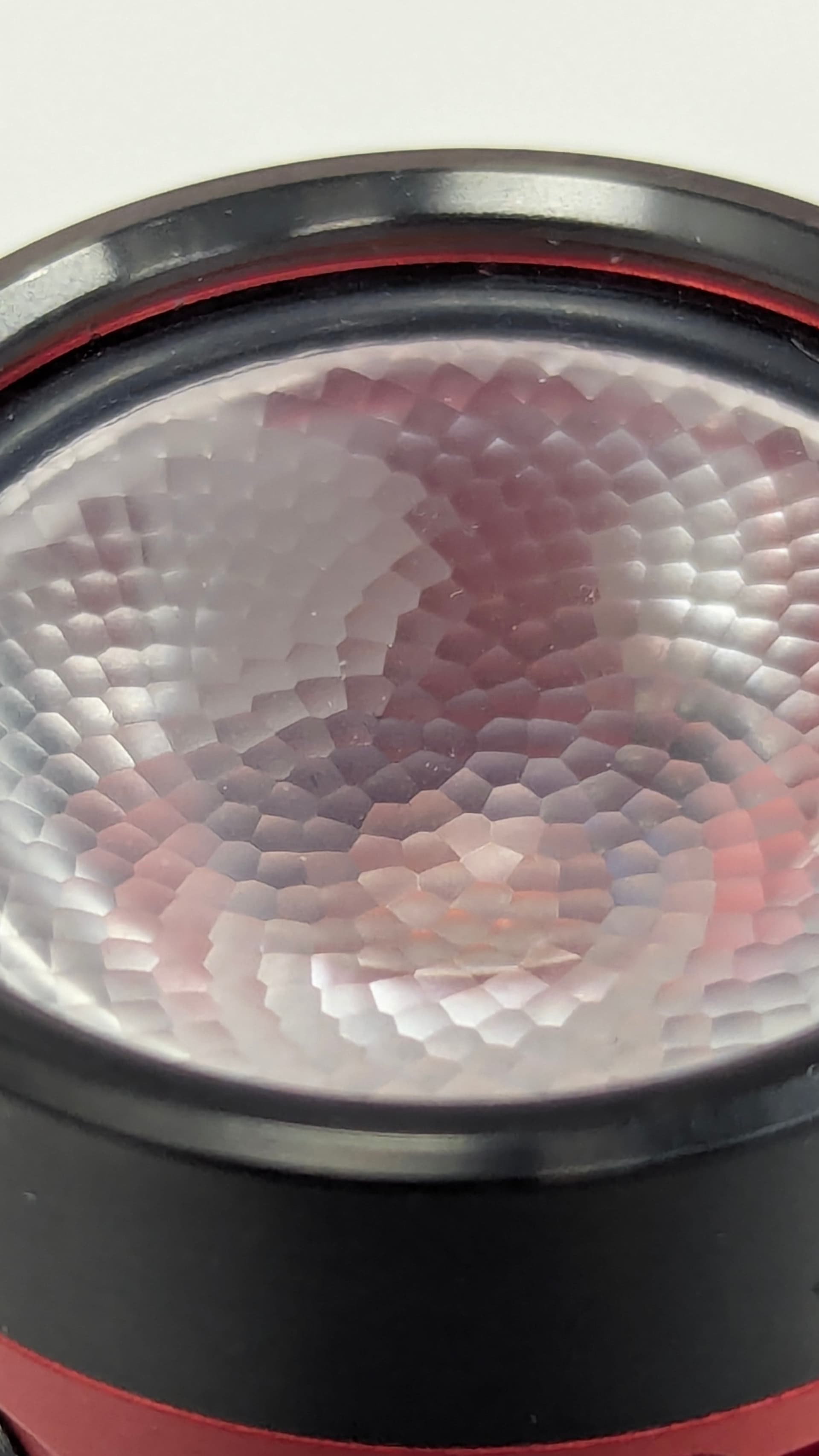

I’m curious, did the foil tape increase the output by a measurable amount, or alter the beam profile? I’m very curious what the losses are like for these giant TIRs.

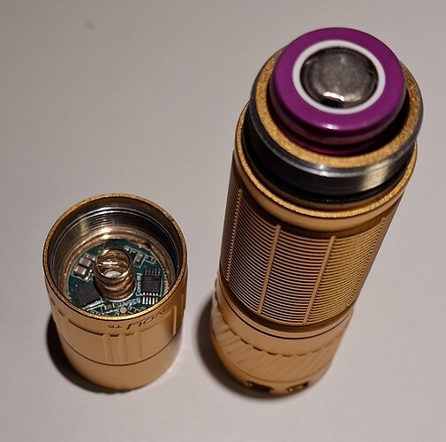

It’s been my fault:
Just Convoy T5 with B35AM 3500K, 30 deg lens and 2A driver
Made no spring mod just replaced button top Vapcell F15 with a flat top H10 which is about 3-4 mm shorter.
8 Thanks
I wish @Simon_Mao offered this as an option.
