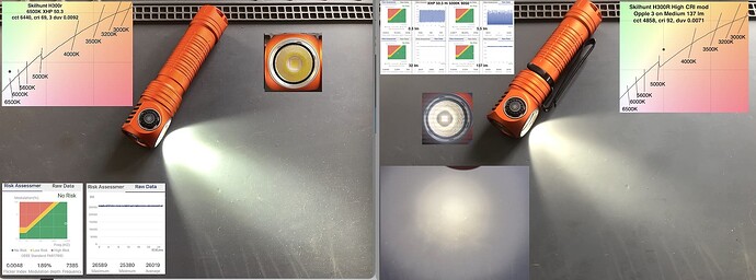

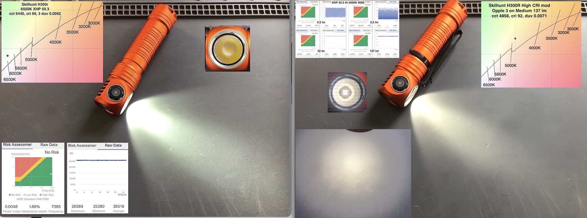

[NMD] Skilhunt H300R replace 6500K Low CRI w 5000K High CRI
before and after:
album https://imgur.com/a/xX0ZSvy

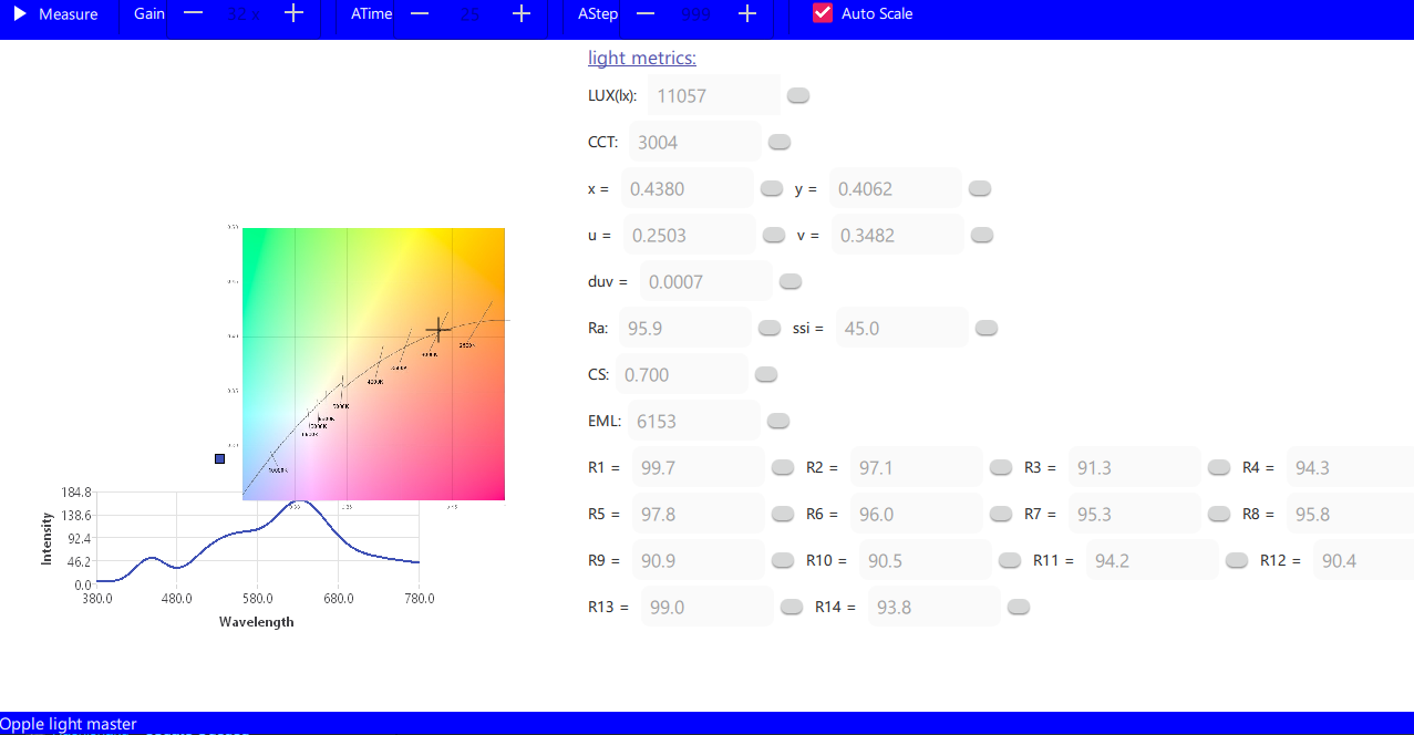

Dropped a 3000k SST-20 in my T7 with a 15⁰ TIR

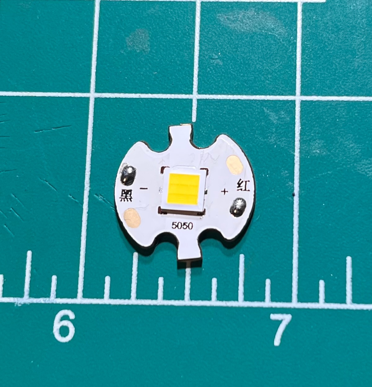

The LHP emitters are dang good for what they are, here is the 4000k
And here it is compared to other 4000k lights, white balance is set to 5000k.
From left to right: B35AM, SST-20, and LHP531

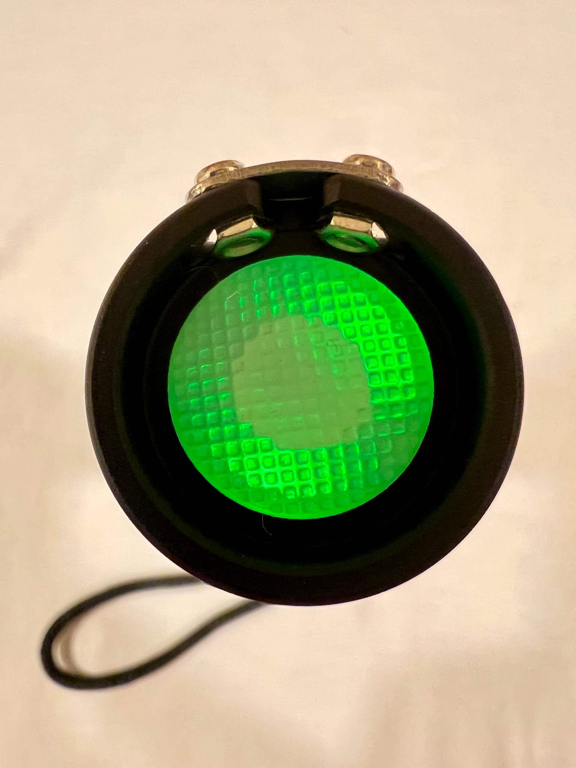

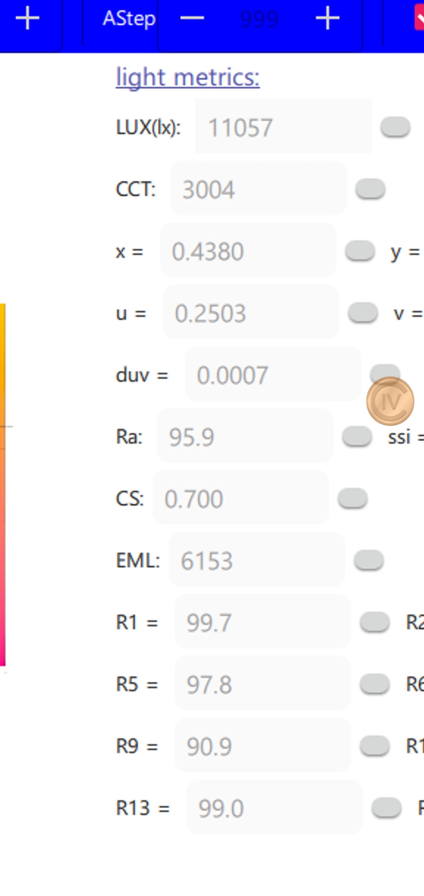

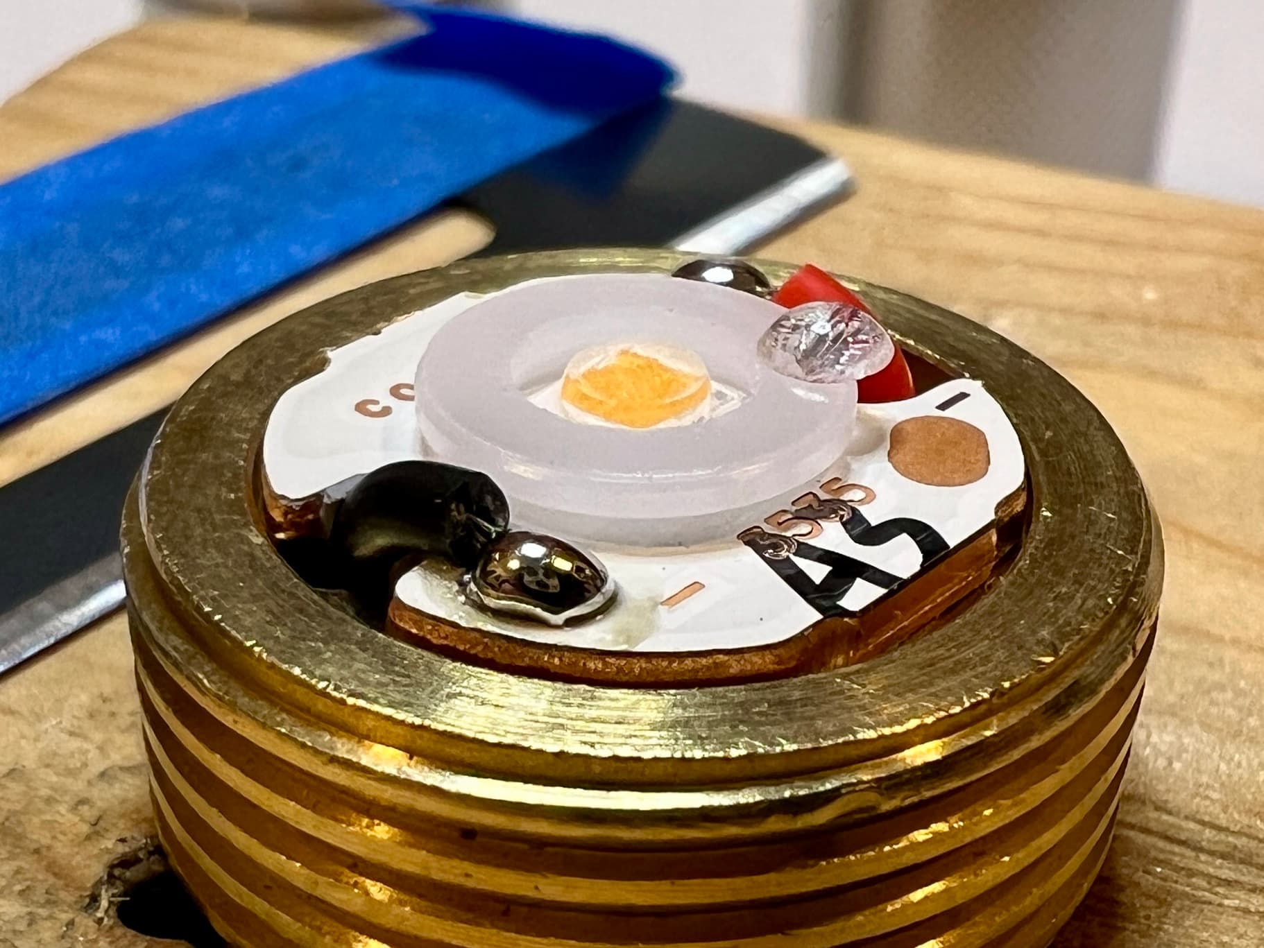

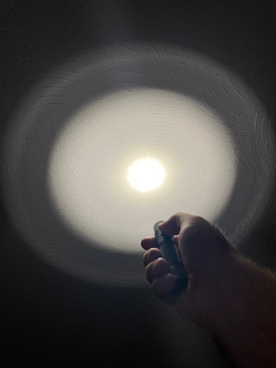

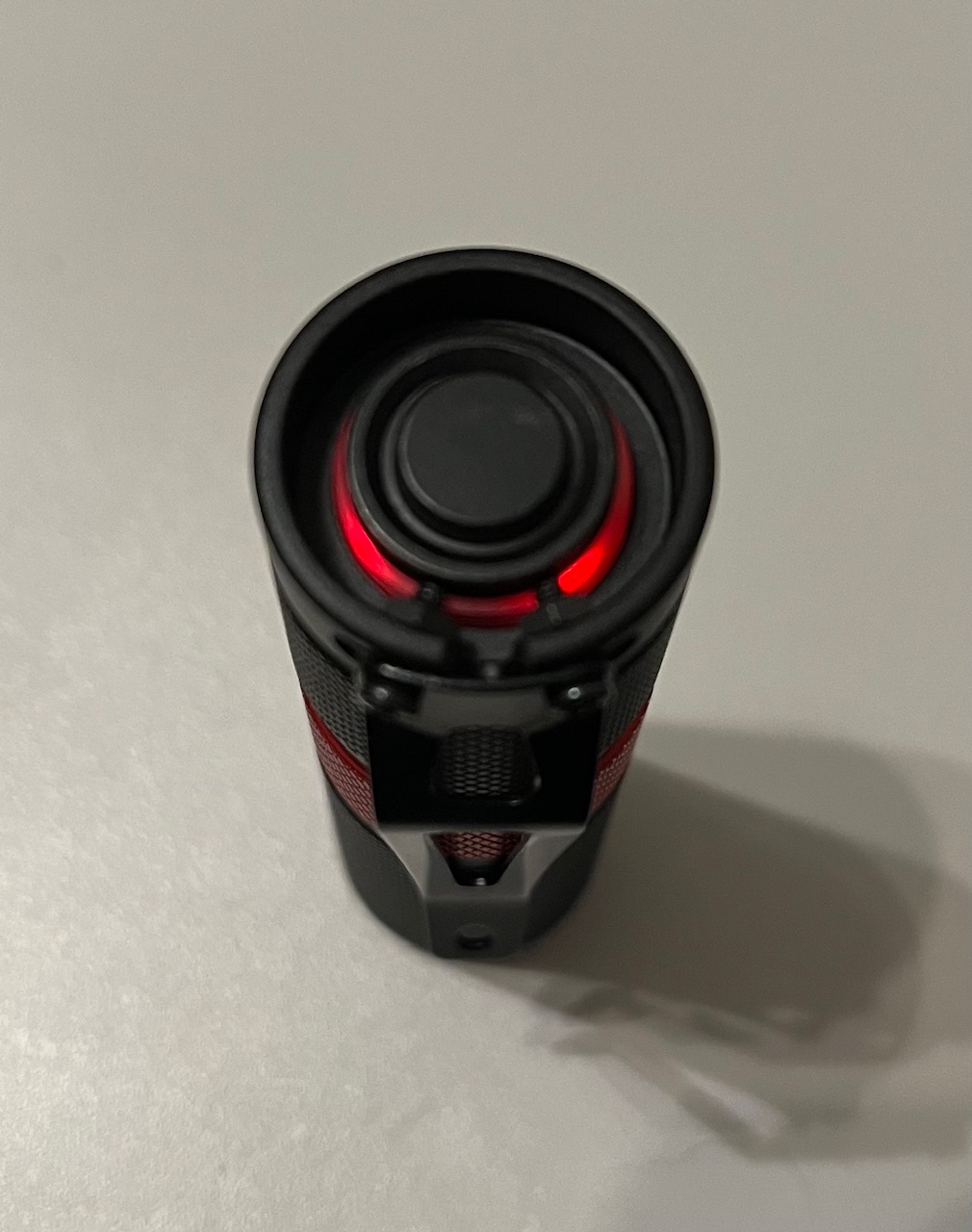

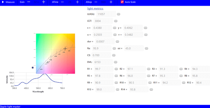

I sliced the 3000K 519A LED in my stainless steel S6 down to 1.5mm by turning over the reflector gasket and using it as a spacer to slice the dome. Worked great!!!
I wanted to minimize the reduction in CCT and my tallest customized washer was only 1.25mm. 1.5mm is still plenty enough to turn the tint from neutral to slightly rosy.

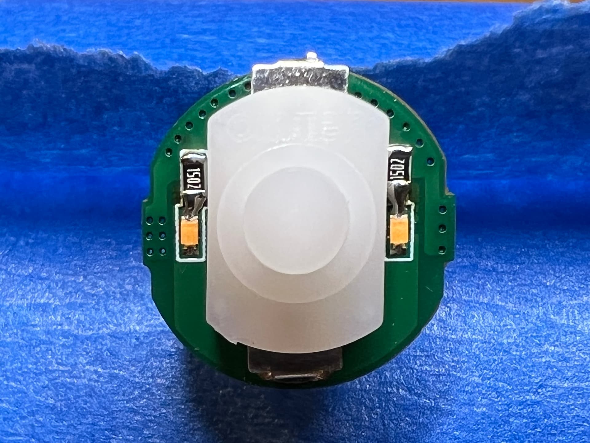

I also put in a pink lighted switch. Surprisingly these new Convoy pink lighted switches with 0402 LEDs are very efficient! Much more so than the 0805 versions that I have used in the past. I replaced the stock 300 ohm resistors with 15K which brought the current down to 0.04mA at 4.1V. My other pink (and pink variations) lighted switches are around 0.2mA with a similar brightness.

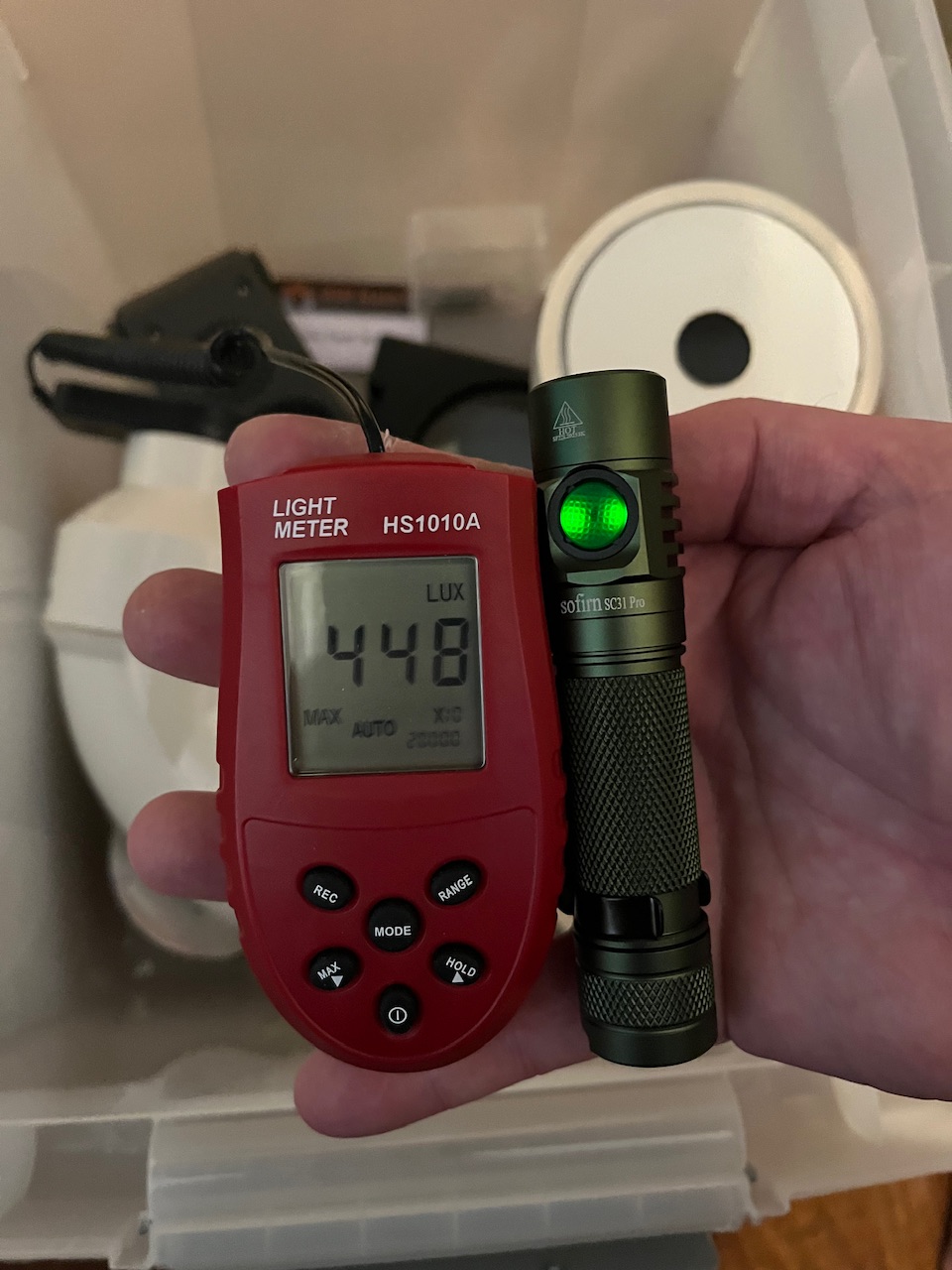

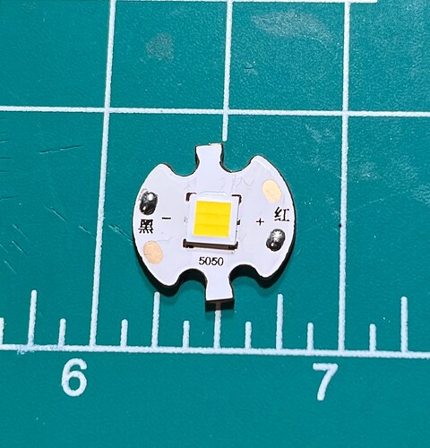

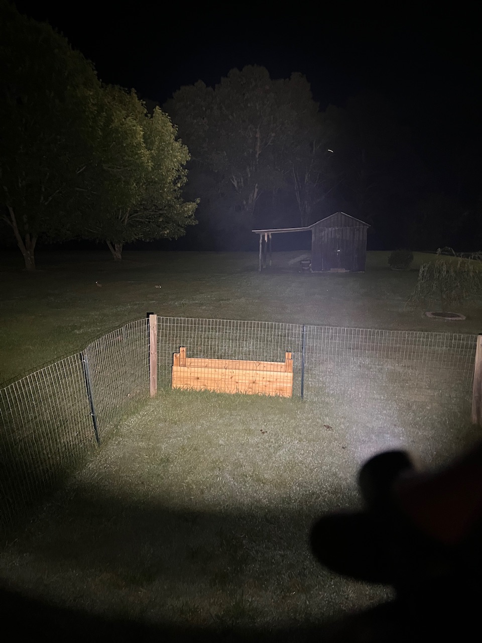

I dropped a LHP531 4000K in a SC31 Pro:
The Bezel was glued, so I needed some help:
Reflow went smooth:
4,500 Lumens on Turbo:
Less rings than the SST40:

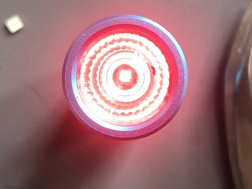

Another TS10SG mod to SST-20 DR 660nm Red:

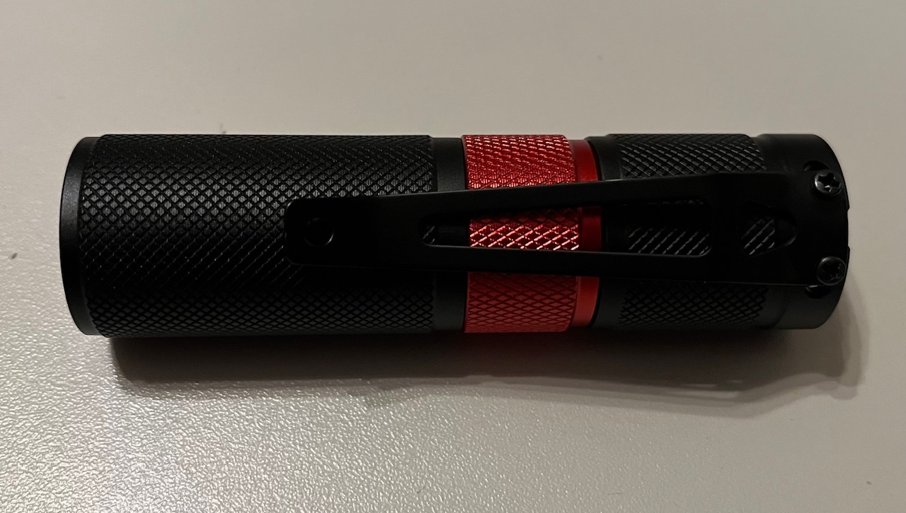

Not really a mod, but I added a Black screw on clip to my Convoy S6 that I’ve named my Deadpool Light:
Screws are a little bit too long:
9 Thanks
Looks nice!
I always file down the screws and nuts when I use those clips. Now I have to resist not replacing them with these new black ones!
What length do you bring them down too?
I’m currently looking at some 3mm M2 screws on Ali
It depends on the flashlight and how thin I filed the nuts down to. I keep checking the length until I get 1 side looking good and then repeat for the other.
I think 3mm is too short. I purchased these 4mm
Should arrive in a week or so.
That’s what I’m trying to figure out

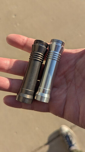

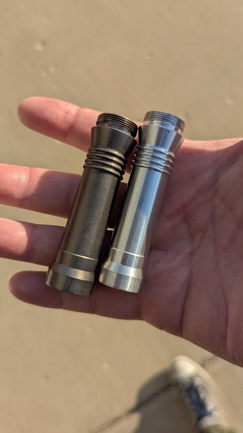

First attempt at anodizing! I used Rit dye and this is charcoal gray. It has a hint of brown in it. Next time I’ll try turning the temp down a little on the dye stage (I tried 140f ). It’s not perfect! I could have cleaned it better before putting it in the acid.
Now I know for next time!
