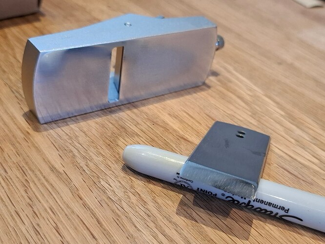

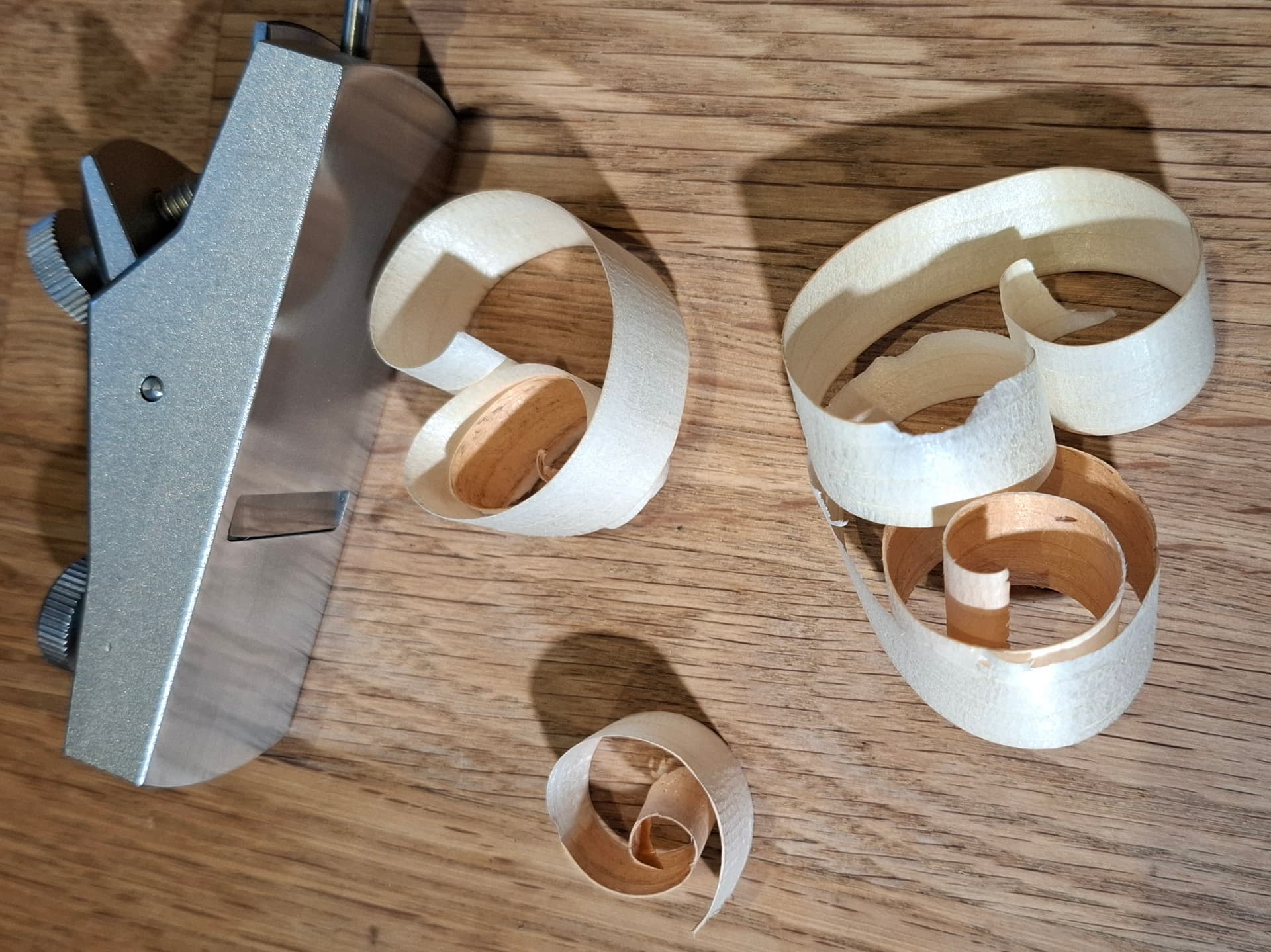

Not so much flashlight related, but I polished the base of my AliExpress mini plane, and reprofiled and sharpened the blade. These are quite fun little tools, worth the money when they’re on offer.

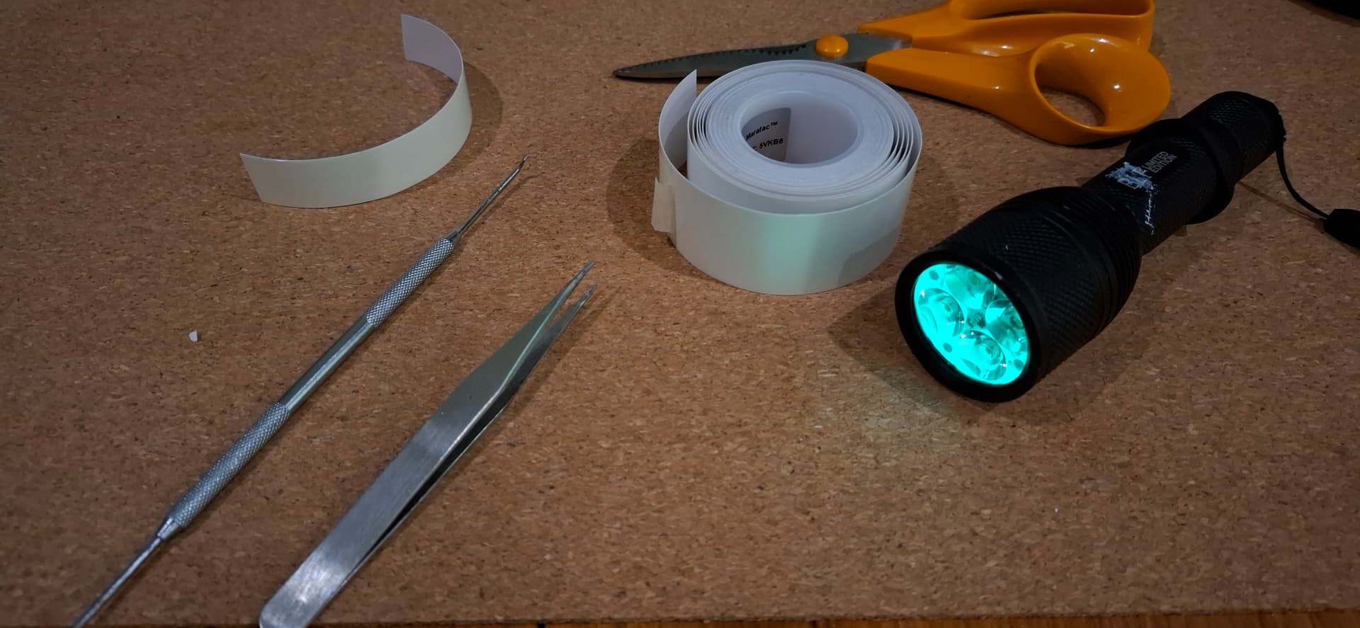

Another glow-tape-behind-TIR “mod” today, this time my BLF X6 with LED4POWER copper spacer and quad MCPCB. Glow tape is CountyComm “maraspec” stuff.
Yes, the light does have paint on it, I was last using it for some decorating.

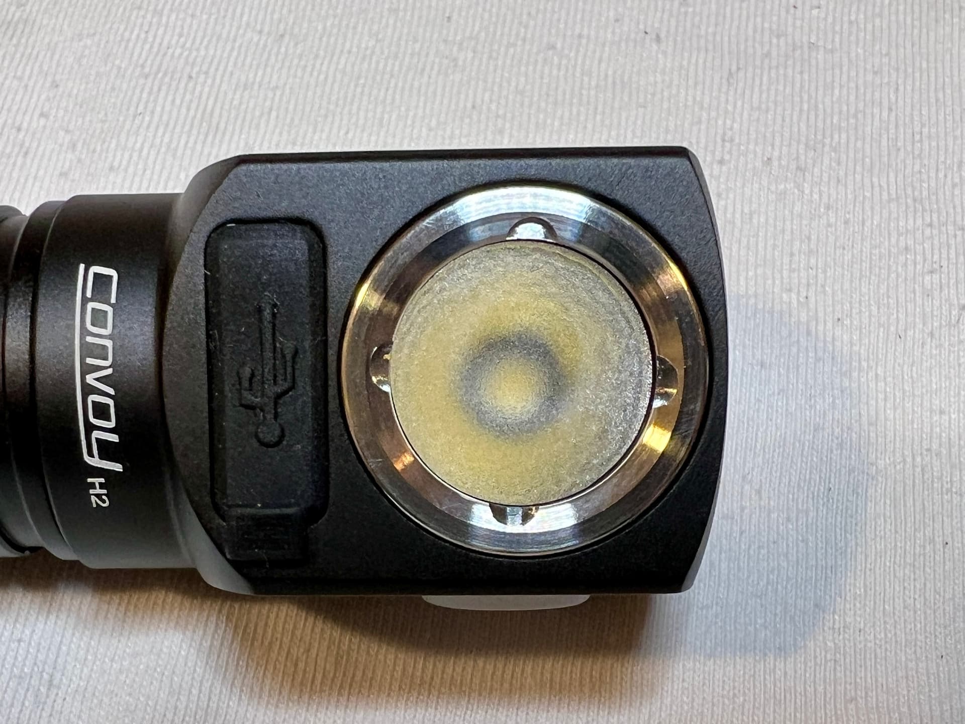

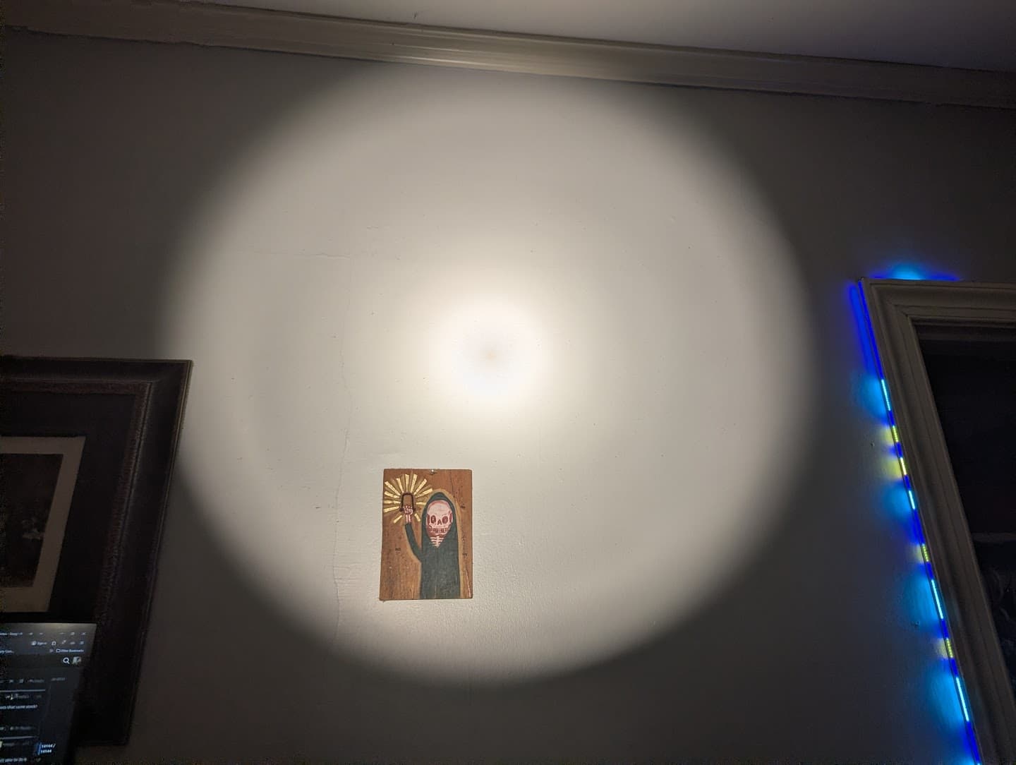

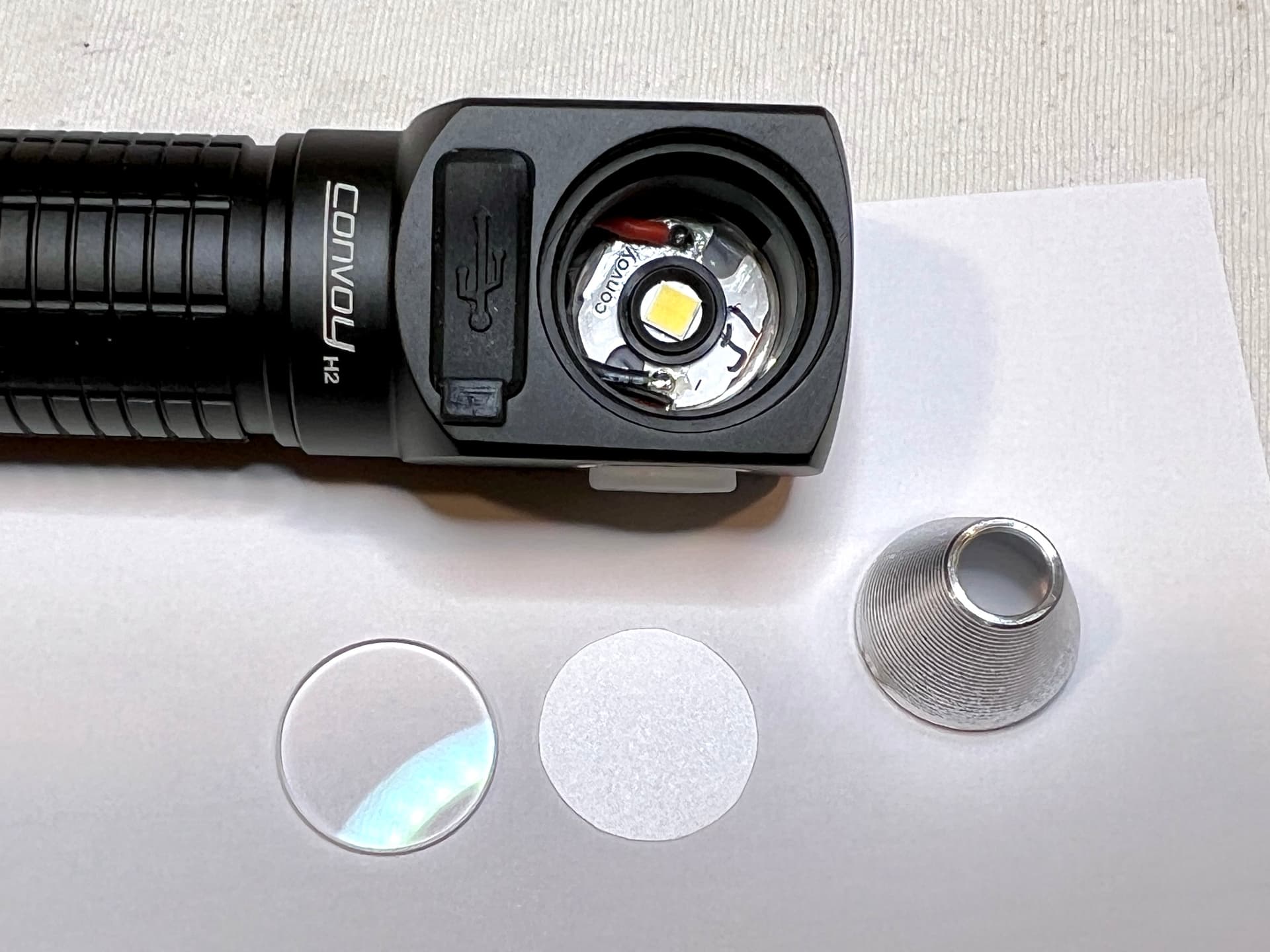

A simple, but very effective mod on an H2 that my adult son is getting for Christmas. It has a 5700K (his choice) B35AM LED and I was a little disappointed with the beam since it has a slight, but noticeable, donut hole and rings.
So I cut out some DC-Fix #3 and installed it under the lens. And in case you didn’t know, #3 is a lightly frosted thin plastic sheet. Here’s where you can get some (and other kinds too) from our friend @Boaz if you are interested: DC-Fix Diffusion Film ,Amber and Zircon minus green filters
What a huge improvement - no more donut hole (left before, right after)!
11 Thanks
That CountyComm tape is good stuff, but I wish they had other colors. I have it behind the TIR on a few lights. Glows much brighter than my Aliex tape

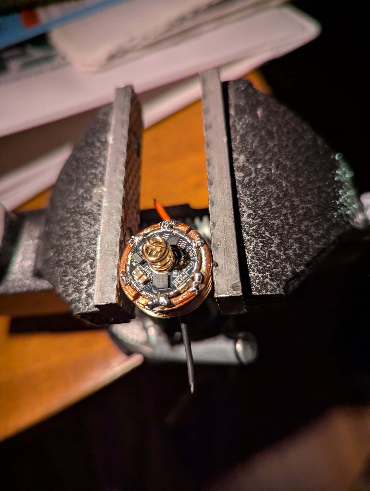

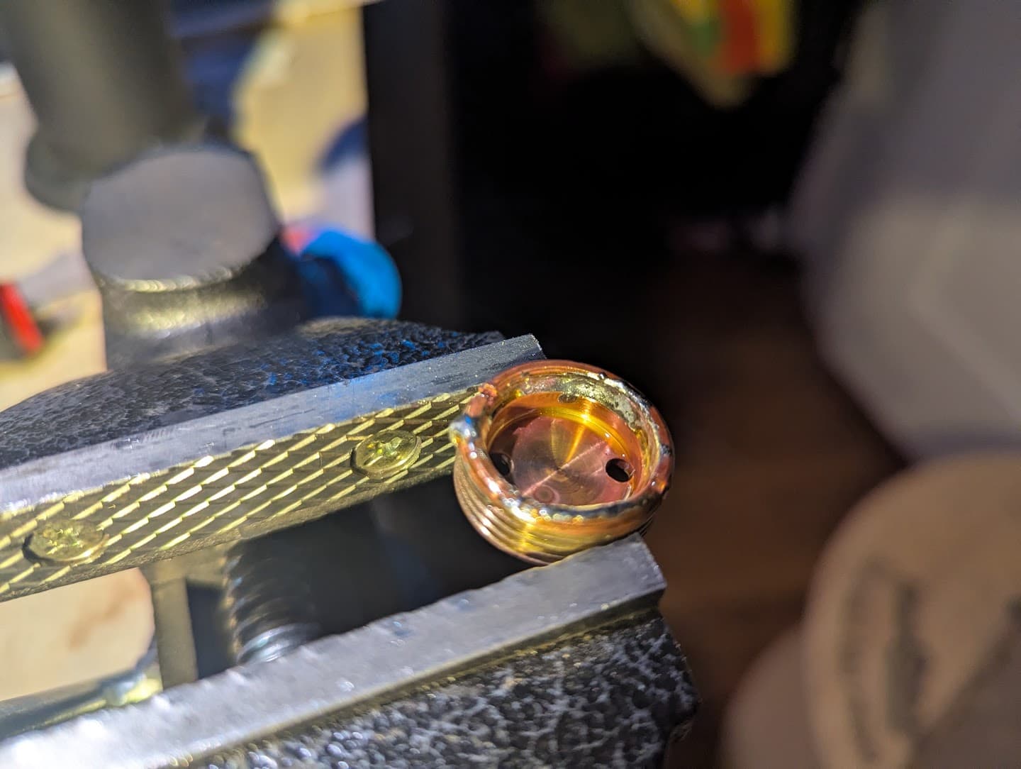

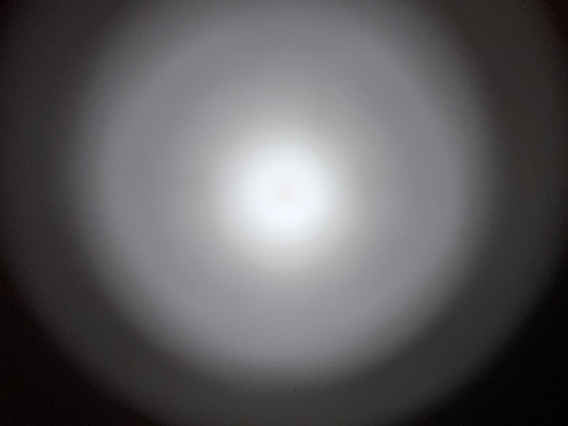

Decided to swap the sft40 3000k in my convoy pocket rocket to a sft70 3000k. I didn’t realize when I disassembled that my driver was taller than my pill’s cavity, so I needed to solder the driver to the pill. First time for me, but went off without a hitch. Got to braze and solder for this project.
Also had to pull the sft70 off a board, because I’d originally planned it to go with a 20mm mcpcb.

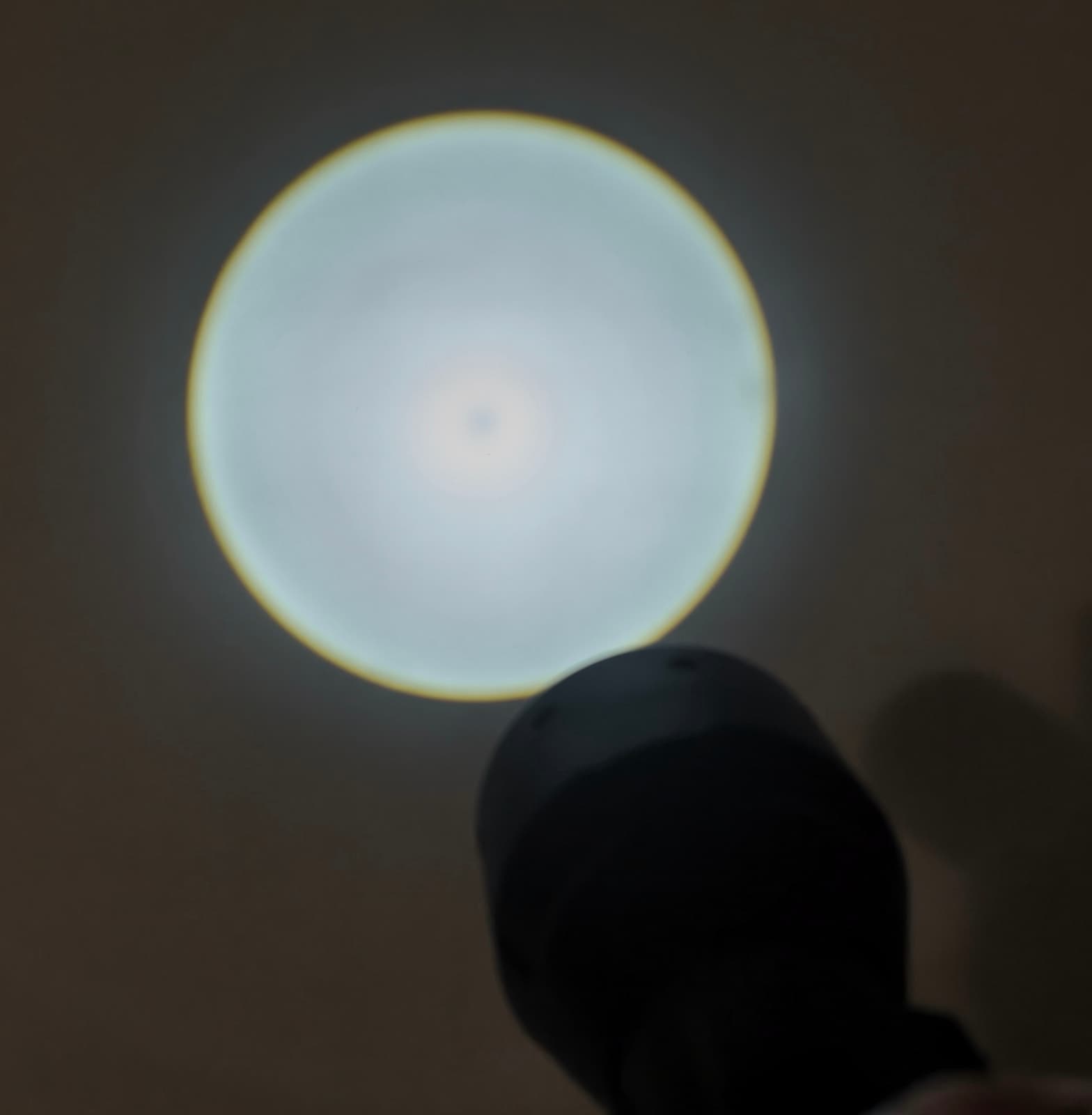

Need to decide on which new filter to put on to delete this donut:

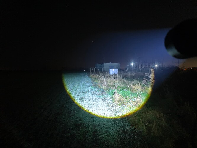

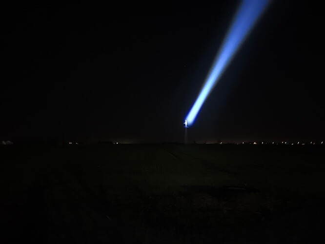

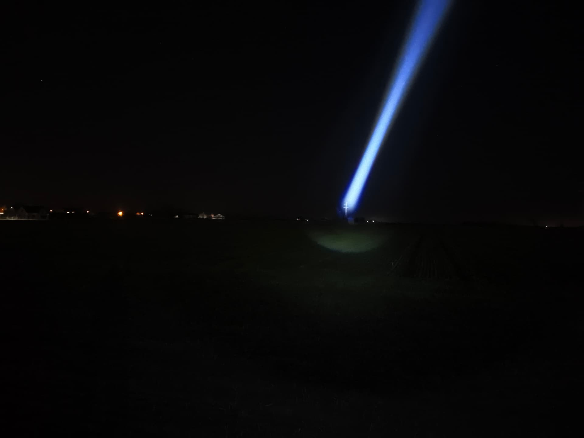

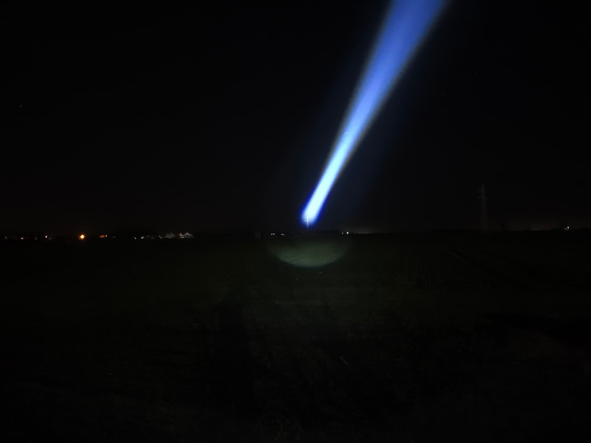

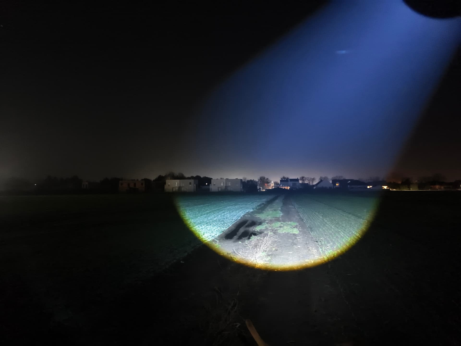

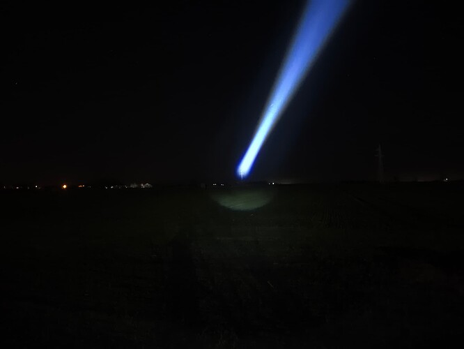

Modded a zoomie I’ve always wanted :partying_face:
UniquFire UF-1504. Huge glass lens and tons of meat ready for the heat. Unfortunately there’s an aluminium pill accommodating 16mm LED PCB and 17mm driver.
Still fair enough for 5A Convoy driver, both springs bypassed and Sony VTC6 paired with SFT-25R.

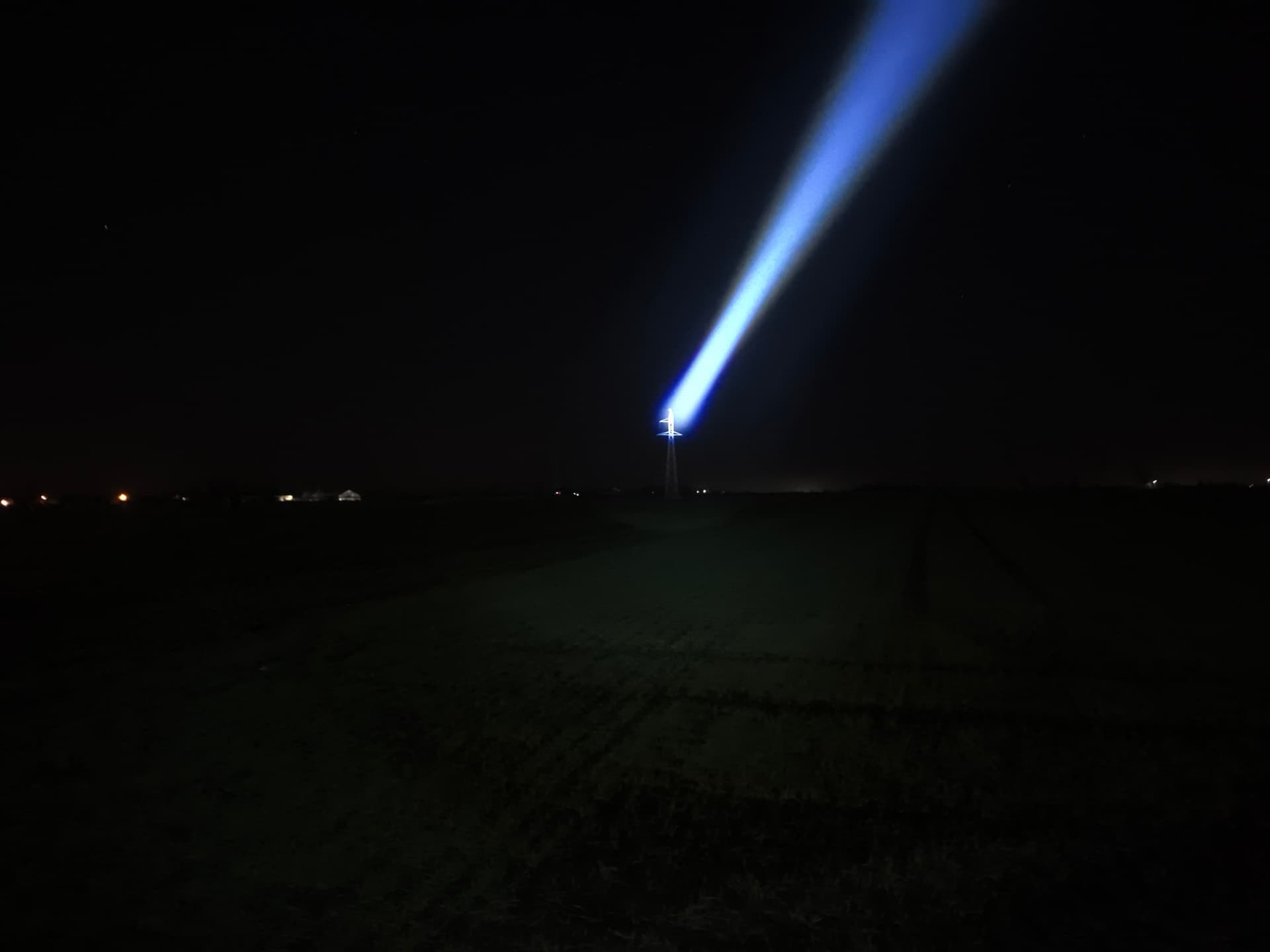

Haven’t done any measurement but judging by the eye and experience the throw is between 1200 and 1400 meters.

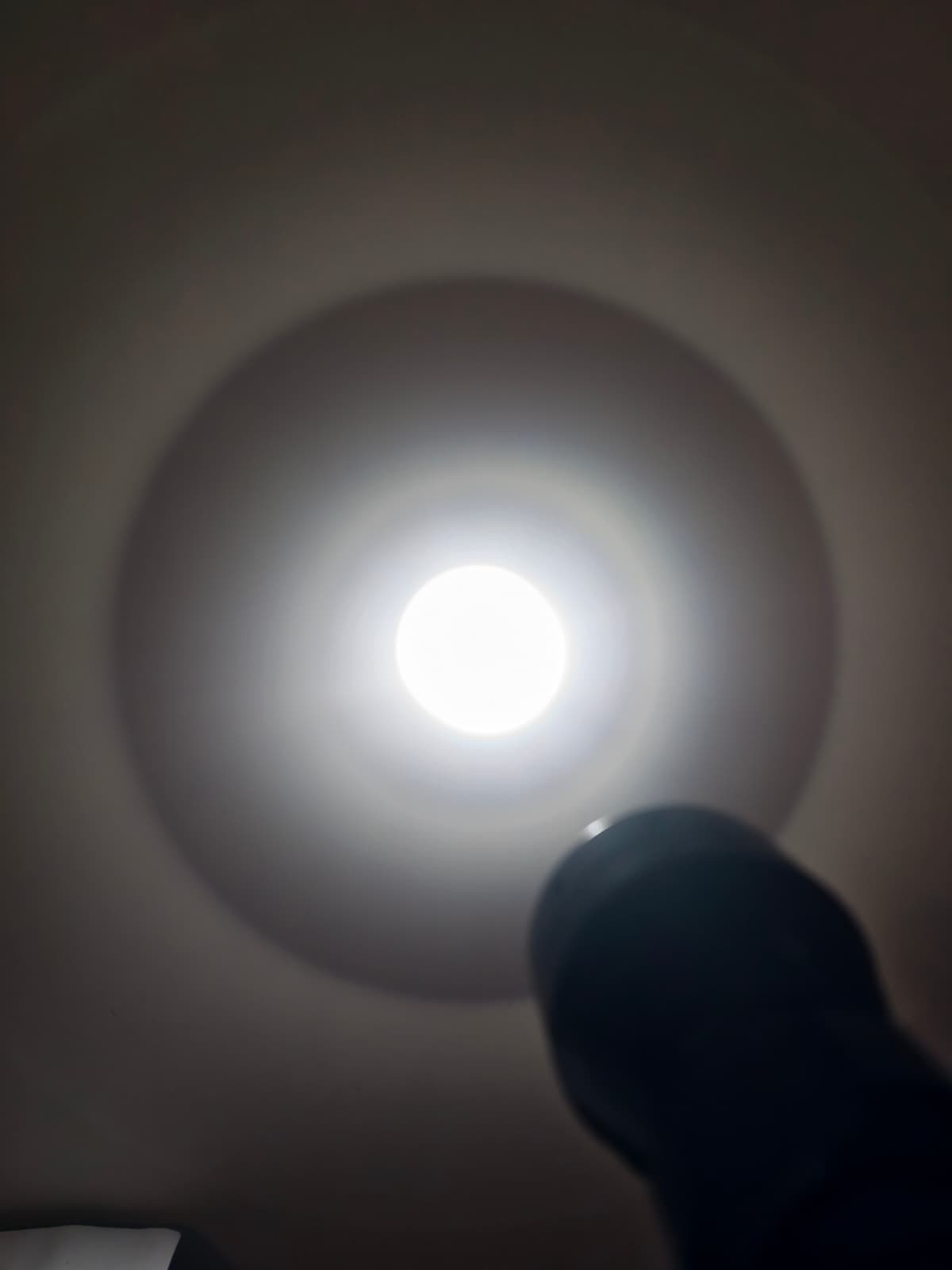

Sprayed the black matt paint on the interior to reduce reflexes as much as possible, but still the rings are present when directed on the wall. There’s also a tiny donut hole.
Despite my efforts, the beam isn’t perfect. open for any hints how to smooth it.
Nonetheless the throw is imppresive. Spill is also nice (except for that tiny hole in the middle) but the Jaxman Z1 spill still remains as top1 for me.
Some night shots:

Which model pill didn’t fit the convoy boost driver? And which boost driver was it?
It would almost be worth making a wooden jig up to machine it deeper
is this their official store?
I bought this little light used, and the seller didn’t specify which model it is. The reflector is very deep, so I’m assuming that this is a s6 from an unknown manufacture date. It would likely be more difficult (for me) to machine the pill deeper, and the shelf didn’t appear to be thick enough to really accommodate that. I also don’t have the setup for all that. Driver is a 17mm 6v5amp boost driver from convoy - this one 17mm 6V 5A boost driver - Convoy flashlight
Brazing the pill was fun to do and it reminded me that I can! Just flux it heavily, hit it with a small butane torch for a bit and flow that solder. If I’d thought about it a little better I would’ve copied what the plumbers always seem to do after applying their solder/bead, which is to smear/wipe it down with a simple piece of cloth. Would’ve been far better/picture perfect had I remembered to do that
