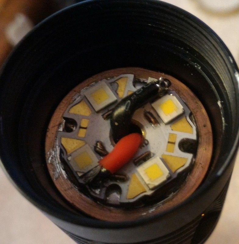

I suggest doing a mock-up before getting to excited about that. I was really pumped to put a red XP-E on the center pad of the XP32 Noctigon under the Cute3 optics, but not after I tried it. It looks sweet as some kind of backlight, glowing just for fun. But it was totally unusable as a beam. The light comes out in a weird psychedelic pattern.

Ah, it’s actually going to be a backlight just like the tailcap. Very dim. I decided not to polish the optics either as I think it will blend the backlight more. I can’t think of a way to disable it when I turn the light on like the tailcap light, so it will most likely always be on. Going to go straight up to the Noctigon from the driver using a bleeder resistor.

I used thermal adhesive to hold the copper to aluminum. I will not take that apart. I could pull the bezel and lens for pics. remove optic and brass, but that is as far as I will go.
I did not take internal measurements, I do not have internal calipes that can reach that deep, here at home. But the bore leading to the MCPCB shelf is definitely different ID. No idea how to determine if the taper is also different, but my host now has a ring indention from using lapping compound to see where things did not fit as I reduced the diameter of the upper lip on the copper.
As you can see there is an absolute flush fit to optic and brass. But there is NO room for an O-ring.
Here is the current OD of the brass ring after material removal. It is still a tight fit.
Current thickness of brass after A LOT of material removed by hand.
Here you can See the TPAD is clearly sitting above the copper spacer because there is 2+mm copper shim under it. Even with the shim I still had to reduce the thickness of the brass so the optic was held down and not rattling inside…
