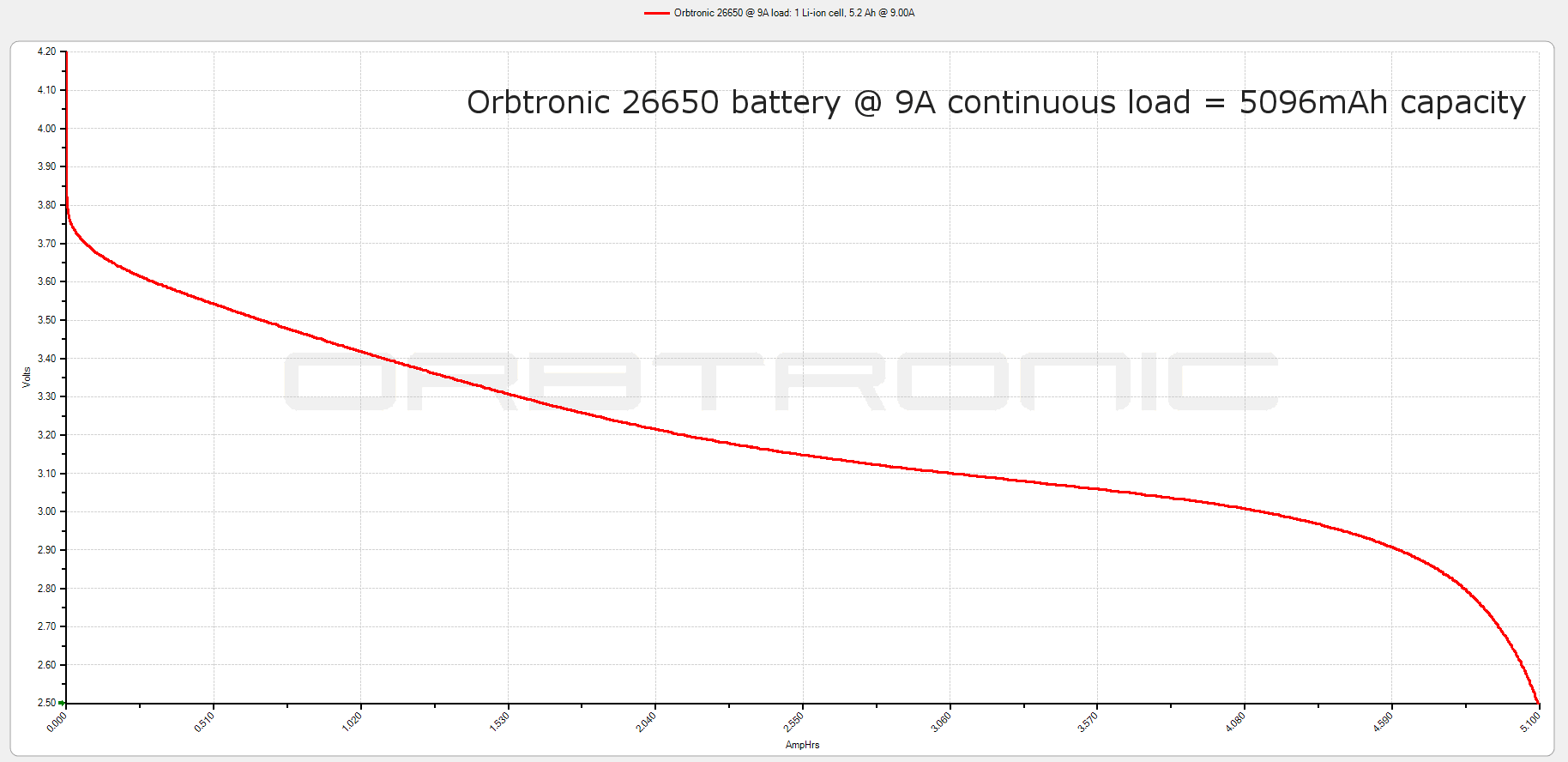

Orbtronic Protected 5200mAh
Over 5000mAh at 9Amp load
Dimensions: 26.4 mm x 69.1 mm
Thanks for reposting that graph resized, teacher.
Comments about that Orbtronic 26650 discharge curve:
  • Initial dV above 0.4V for a 9A load, which means about twice the internal resistance of a LiitoKala 26650-50A/B cell.
  • Discharge measured down to 2.5V, which is quite significant here because the battery was being discharged at what could be considered its maximum continuous rate (or nearly).
  • As I see it, ≈4130mAh for a 3V cut-off and ≈4840mAh for 2.8V cut-off.
Not in the same league as LiitoKala 26650-50A/Bs (or Soshine NCR26650s, which I presume to be rewraps of the PLB INR26650-50As too).
Cheers ^:)
Posted on Fri, 11/11/2016 - 16:24. Edited for typo fixup.
My pleasure ‘Barkuti’, it was a bit large for me to follow as it was. :wink:
Thank you for the commentary you provided above on the Orbtronic 26650 discharge curve. What you said seems right on target to me. :+1:
The Orbtronic does not even come close to the Liitokala as I see it.
Truly, as you said; not even in the same league as the Liitokala’s……… :slight_smile:
