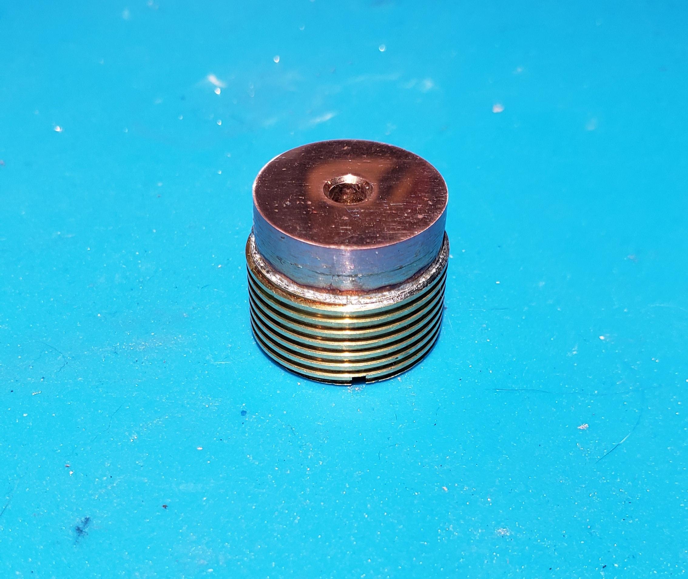

Ever try making an S2+ triple without the spacer method? It requires a little machining but nothing a rotary tool can’t handle. You end up being able to use an 18500 (or 14500, or aa with the T3 driver) with an 18350 tube.
I’ve made spacers for my S2+ triple and S21A quad with just some 1/8" copper, a hand drill and belt sander.
Pic of S2+ spacer soldered to pill.

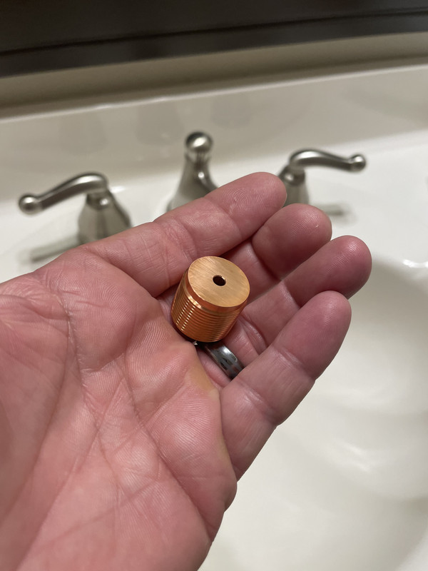

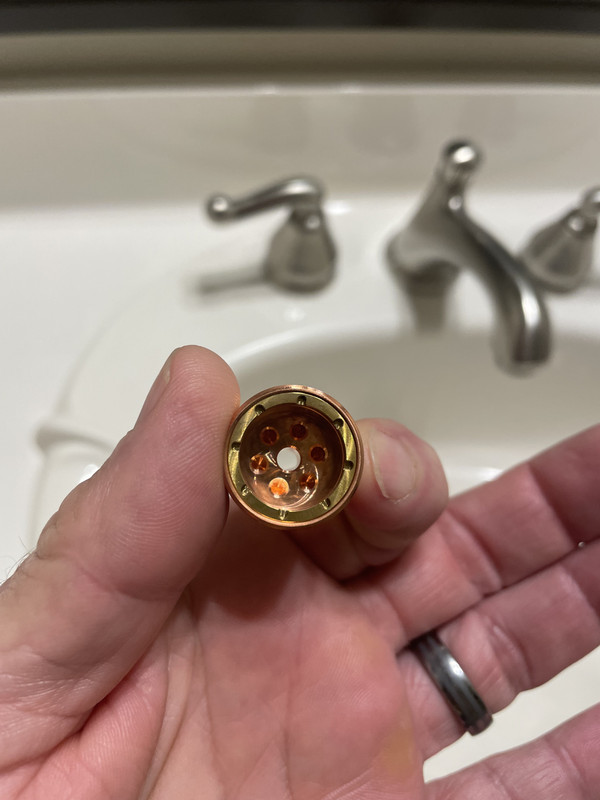

What’s that? A custom pill that’s extended out to be triple-friendly?
Yep — Custom made by HOOP – He also had a batch of stock copper pills that were just as awesome

It’s fairly easy to modify the pill of an S2+ to make it suitable for a triple without a spacer.
Remove threads from around the top edge of the pill so that the pill can screw further into the head. No need for any fancy machine tools. A hand file is all you need.
If you want to use a larger cell in a smaller light it may also be necessary to shorten the pill so there is less empty space between the driver and star. This can be done with a hacksaw and some filing on the bottom of the pill. It may also be helpful to use a dremel for this part.
Is the battery pretty loose then with that extra length?
I guess it depends on the spring(s) that are used. Have you needed to use longer and/or thicker springs?
