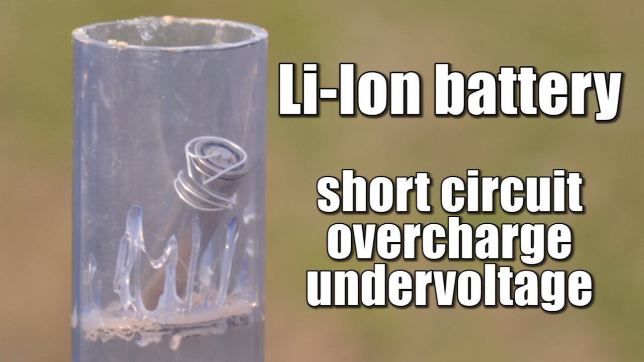

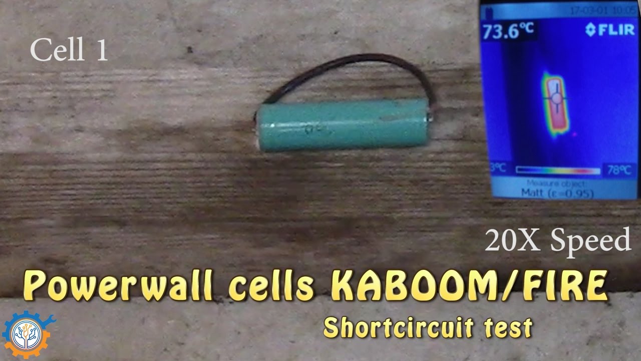

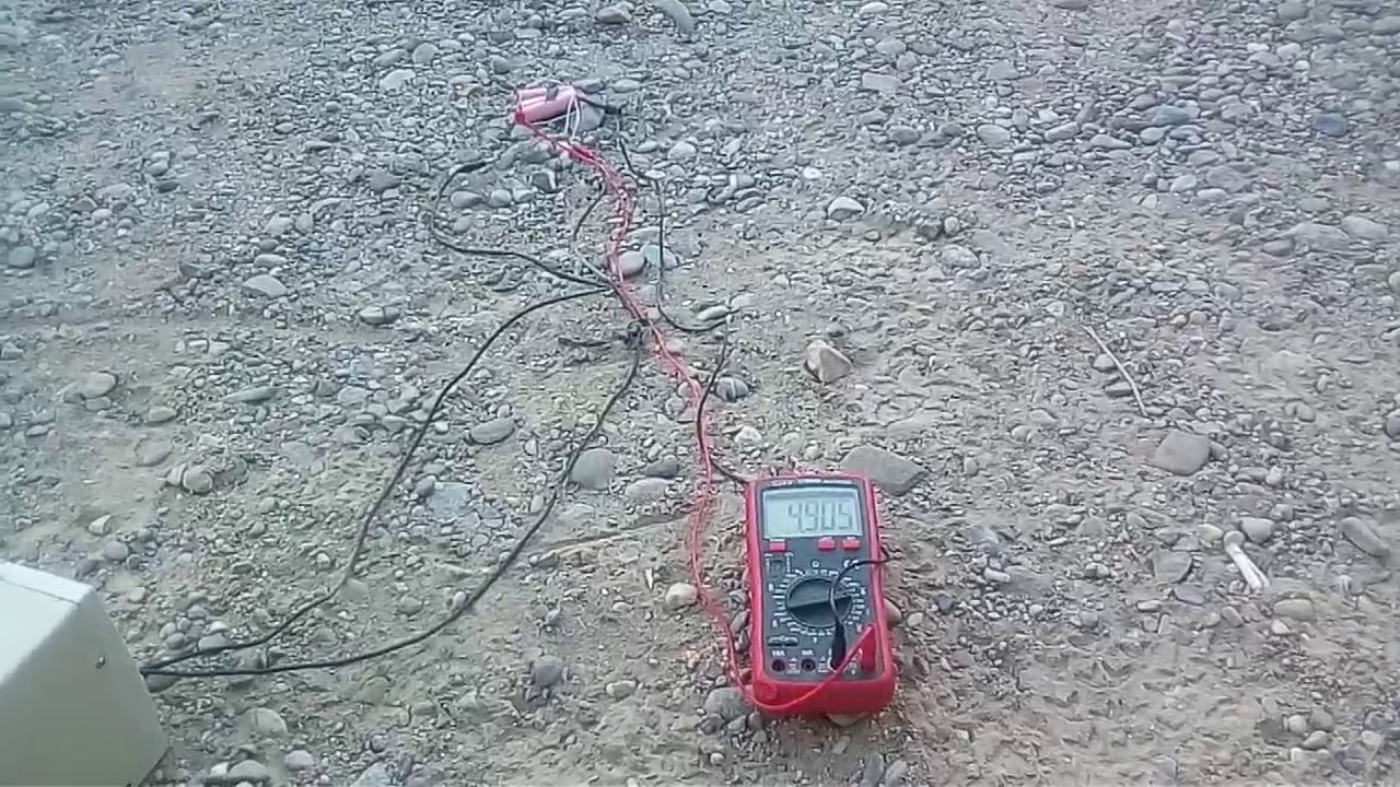

Maybe you’re confusing li-ion with lipo.
Lipos explode much more easily.
As for cylindrical li-ion cells, take a look at tests people have done on youtube, either shorting the cells or overcharging them.
In almost all cases they won’t explode, they just heat up.
Obviously if you force 20 amps into one using a power supply instead of a regular charger then it will vent.
You sound like you’re very paranoid, and overestimating how often 18650s actually vent or explode.
If there is no more electrical power left in the cell, it will not explode.
Shorting an empty cell will not heat up the cell because if there is no more power, it can not heat up the cell.
Cells that are lying around somewhere do not cause fires, cells that are being charged (overcharged) or discharged with high currents are far more dangerous than empty cells in the attic.
If you try to charge a completely discharged cell, then there is a possibility that it can go wrong.
