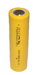

Trying to find a 2600 mAh capacity 18650 sized LiFePO4 3.2 volt battery….anyone seen any (link?). Thanks,HB
LiFePO4 has a lower energy density than other chemistry in general. You’ll be hard pressed to find an 18650 with much over 1500 mAh actual capacity.
This 3-cell battery pack is 2600 mAh and 12 volts,so probably more like 3 18650 Li-ion cells,the charger has an output of 12.6 volts,1 amp. HB
A series three cell LiFePO4 pack is only going to produce a nominal 9.6V, NOT 12V. If you have a three cell pack that produces ‘12V’, those cells are either LiCo or LiMn. Of course, the voltage characteristics of a three cell LiMn/LiCo are going to be MUCH different from a four cell LiFePO4 pack. For 12V, LiFePO4 is MUCH, MUCH, MUCH better than LiCo or LiMn, particularly as a lead acid replacement.
As far as the largest capacity 18650 LiFePO4 battery, Fasttech sells an ‘1800 mAH’ protected (WHY!!!) cell and a ‘2200mAH’ cell. Keep in mind that these numbers are substantially higher than most any other cell I have seen, so I consider these numbers to be suspect. Like the other guy, I would consider anything much over 1500mAH to probably be unrealistic.
On the other hand, unlike LiCo, going from an 18650 to a 26650 gets you MUCH more capacity. Expect to get anything from around 2500mAH from a high current cell (like the A123 Systems 26650 ) to 3300mAH from a lower current cell. So if you CAN go with a 26650, this would be a better choice if you NEED more capacity.
For even more capacity, consider the 5000mAH Feilong 32650 . Tests have shown this to be an AWESOME battery. The voltage of that battery makes NiMH look downright unstable!
Man….too many battery types available…….now it could possibly be a LiCo 18650 sized pack,same voltages,buy much higher capacity,just what my pack says. I am thinking now that since the wall-wart charger has an output of 12.6 volts,that would rule out the pack being LiFePO4’s,so I guess the only real way to find out what batteries are in the pack is to remove the wrapper and see?! trying to get some info from my dealer where I bought my heated glove liners. Thanks,HB
DEFINITELY LiCo or LiMn. Both of these chemistries charge to 4.2V. So 12.6V = 3x4.2V. But 3 LiCo/LiMn charge to 12.6V and drop steadily to around 9V (depending on where you want to cut things off). Four LiFePO4, on the other hand, charge to 14.4V, quickly dropping down to 12.8V. The voltage stays more or less here until the pack is discharged. Because LiCo has a higher capacity, it is more often used where a voltage of around 12V is needed. But LiFePO4 is used when (1) a drop-in replacement for lead acid is needed, (2) greater safety is needed, and (3) a more constant discharge voltage is needed. This is typically not the case with heated gloves (although LiFePO4 would certainly work).
