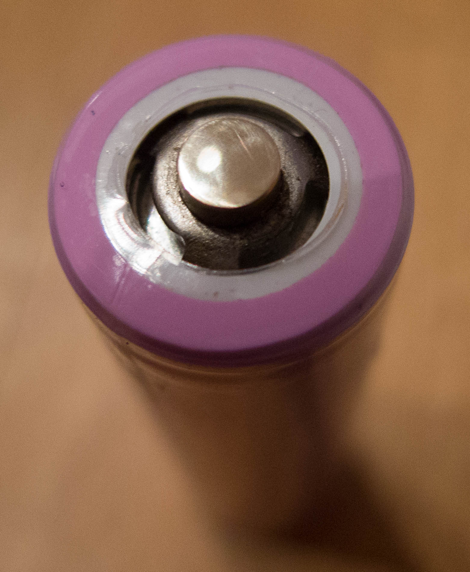

I haven’t tried turning flat tops to button tops, but if I did, I would use the same method I use for making buttons for positive contacts on drivers:
1. Take a piece of sheet copper and cut a small disk using metal scissors.
2. Place cell vertically in vise.
3. Apply solder paste to top of cell
4. Place copper disk on top of paste
5. Use a toothpick to hold disk in position so it doesn’t shift while applying soldering iron to top of disk. The instant the solder melts remove iron.
6. If necessary, apply a second disk on top of the first for a taller button.
7. If necessary use a handfile and possibly steel wool to file the top of the disk completely flat and to remove any sharp edges.
I’ve when using neo 5mmx1mm or 1.5mm magnets. No need to glue or washers or any kind of spacer. Just center and load the whole assembly up. Most lights that need button tops have a non-conductive ring that surrounds the magnet.
It helps when you have developed some soldering skills of course.
But the flattop surface (of course) needs to be clean and without oxidation.
Do not sand the nickel plating off.
Use a hot iron of around 40 Watts.
Wet the tip with rosin core solder, put it on the flattop.
Add rosin core solder kind of between tip and top.
Add more when it starts to flow.
Move the tip over the surface of the top while adding more solder.
When it’s all flowed on the top (and you have put enough solder there), retract the soldering iron.
The solder will solidify in a nice dome shape.
This all should take no more than 4 or 5 seconds !
Have you tried doing tail cap amp readings with & without magnets ?
I used to use magnets but after finding that on an S70 on turbo running 2 x Liitokala 26650”s with magnets I was losing nearly 0.5A.
It may be of course that the magnets I was using had pretty high resistance but because of that I quickly over came my fear of solder blobbing cells & now solder blob if I need to turn a flat top cell in to a button top :+1:
I’ve seen magnets dent my cells .
not a fan of magnets
Solder blobs are simple …Add flux first then load up your iron till the solder is almost dropping off …it takes about a second to do .
Kicked myself for waiting so long to do it .
Seems like I was always hunting for a longer cell for lights that didn’t have a spring …messing with magnets or buying protected cellsbecause they were longer was just dumb .
