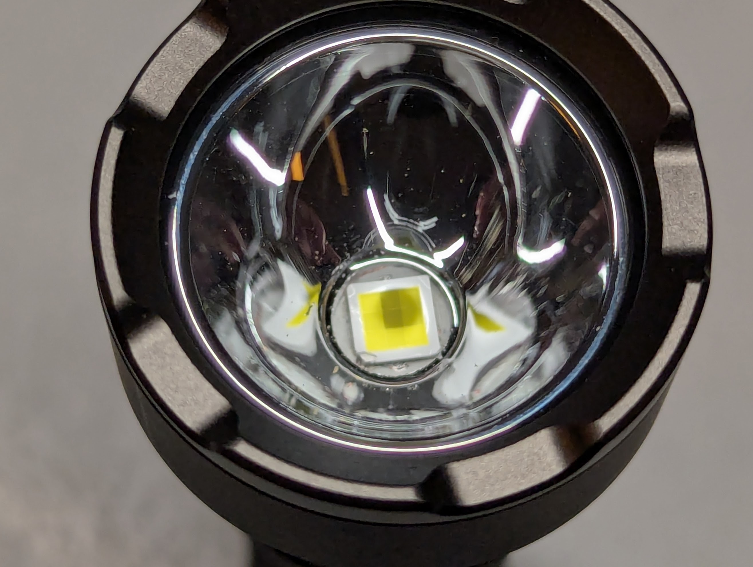

I got the TS12 yesterday and quite like how it feels etc. but the LED… the LED was not well centered, the corona looked awful.
So I changed it to a 519A 5700K - but the reflector doesn’t work too well with that LED, I get a yellowish center.

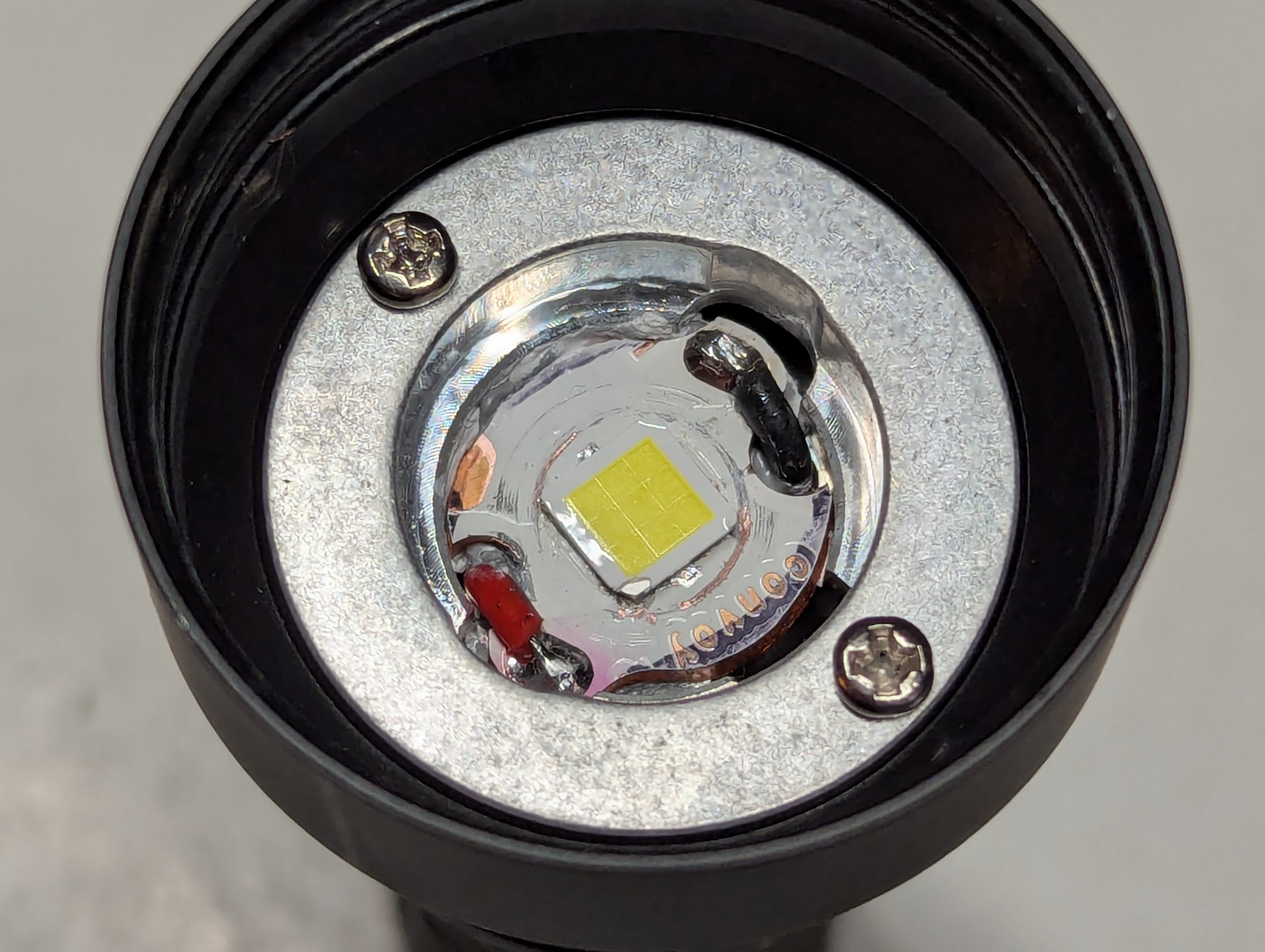

Here you can also see how much play the gasket has around the LED…
Hmmm… just put a 16mm 5050 board over the current MCPCB, with a little bit of grinding I could make it fit…
The reflector hole is a tad too tight for a 5050 LED, but that’s a prroblem that can be resolved.

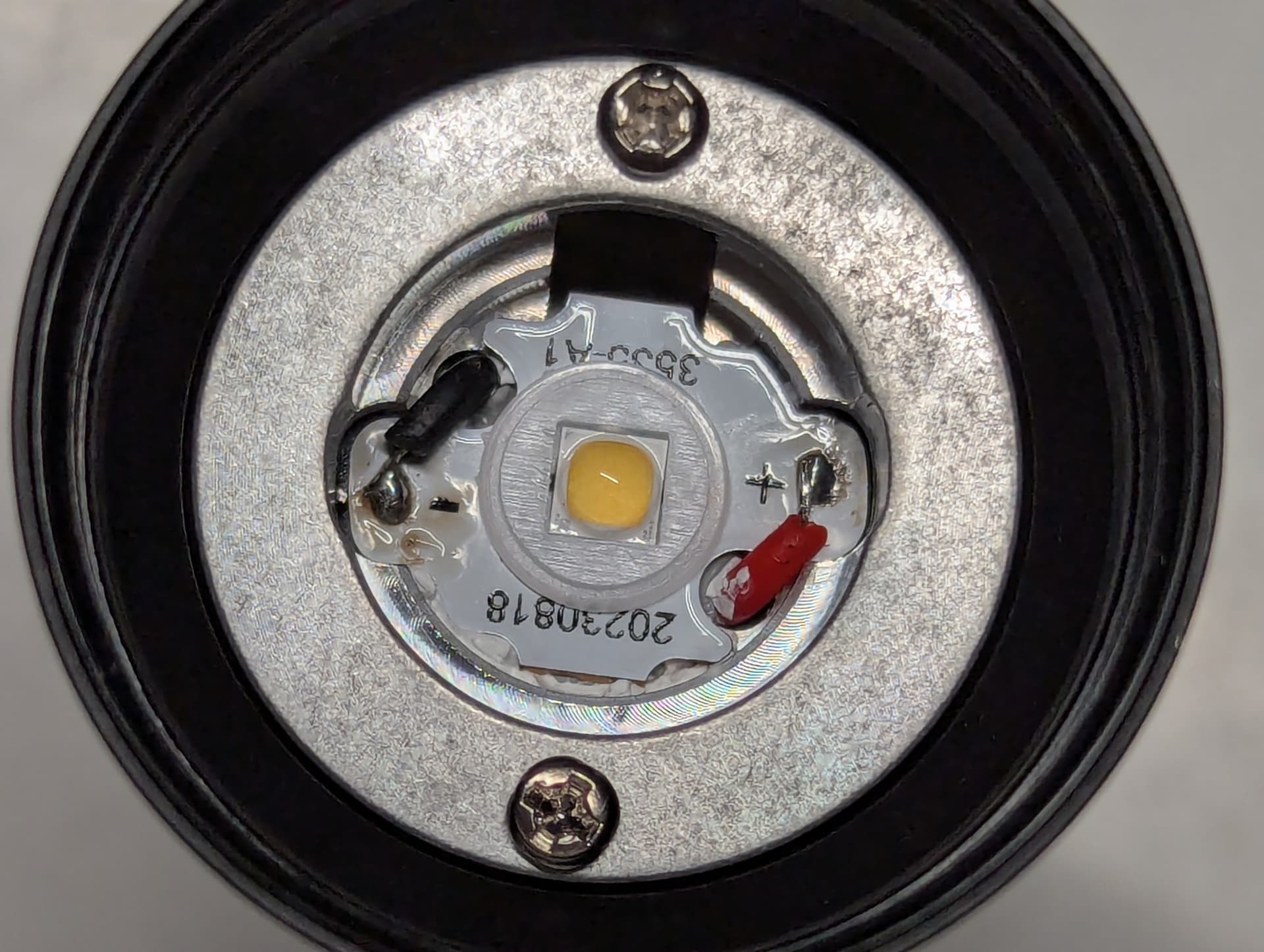

Apparently I did have some time…
I had to ream the reflector hole a bit, before, it damaged the LED and the PCB - and I did fry the driver, probably the mosfet since it still works, but just in like 1-2% brightness.

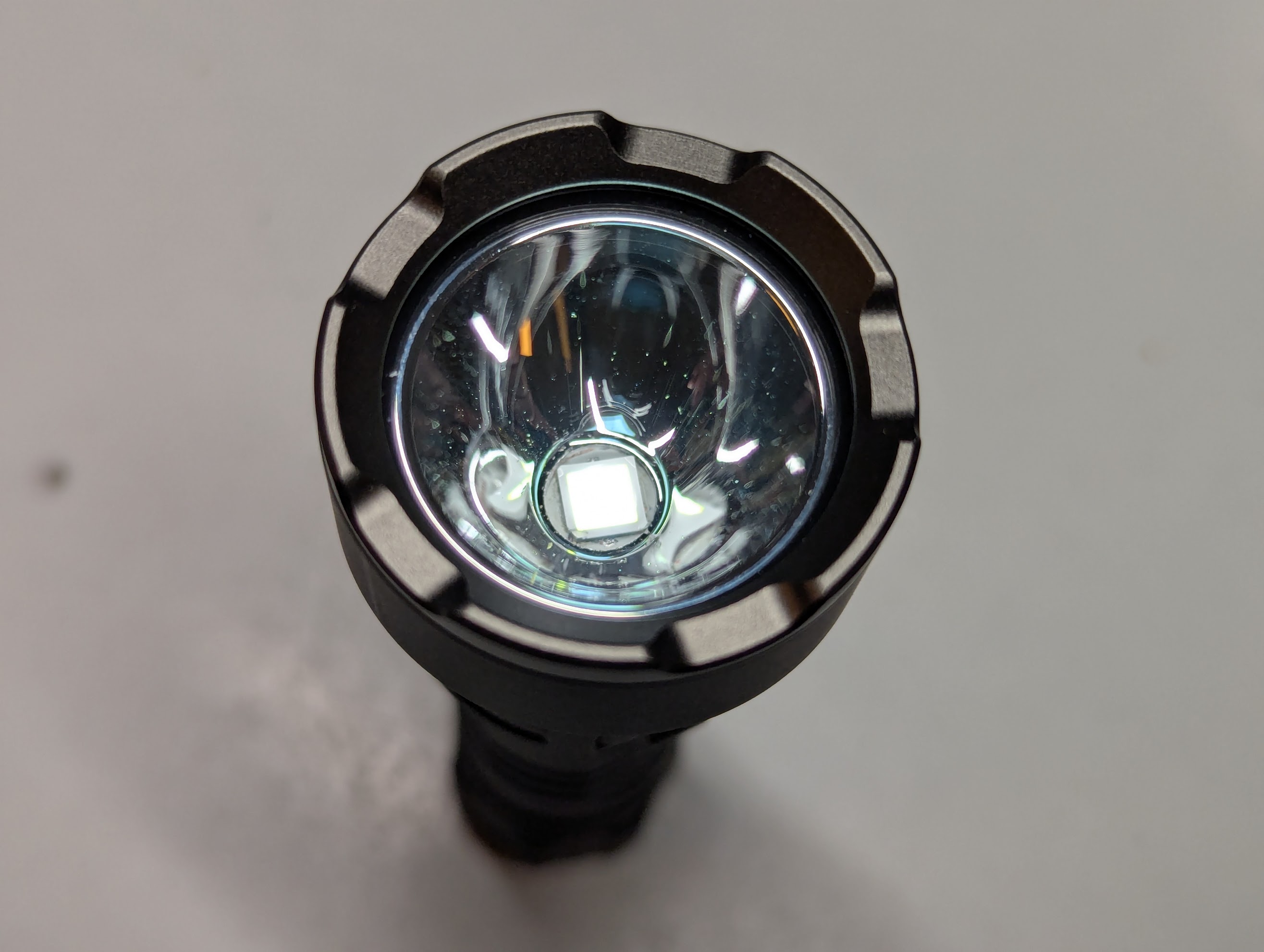

Edit: Eventually I got the driver and changed the LED. The light still has this configuration and I am happy with it.
