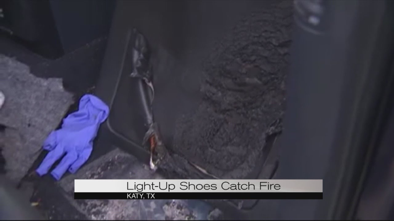

> Have there been any incidents of leakage or fires with batteries inside a well made aluminium torch?
yes, but that is not your primary risk. The main issue is related to recharging a cell that has been overdischarged.
also, the main risk is from ICR cells… the newer chemistries INR, and IMR, are less likely to get damaged by overdischarge (and are more likely to be sold unprotected).
maybe you can deduce what caused this: (Im not sure)
> oxygen
I dont think the issue is “normal” combustion… it seems to be more of an electrochemical heat discharge.
you could spend some quality time googling for more info… I started to search and found this (battery fire, but not a flashlight):
