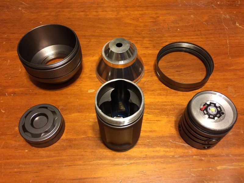

My first impression, this flashlight is made for big hands. Second impression this thing begs to drive an XM-L2 till it screams. 3 18650s in parallel would allow a hard driven XM-L2 decently long run times. Here’s the major component tear down.
I didn’t measure the head but let’s just say it’s big. The lens is glass but probably not coated. The reflector is a fairly robust piece of aluminum.

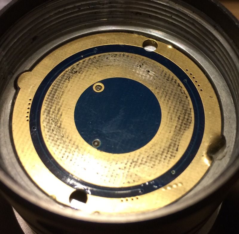

Here’s the battery side of the driver board. I attempted numerous times to pry the driver loose but it was in there really tight and I just couldn’t get it to budge. Those wear marks are just as it came out of the box. So certainly somebody’s been twisting some batteries against that before I ever owned it. I’ll give them the benefit of the doubt and say that they were testing it with batteries.

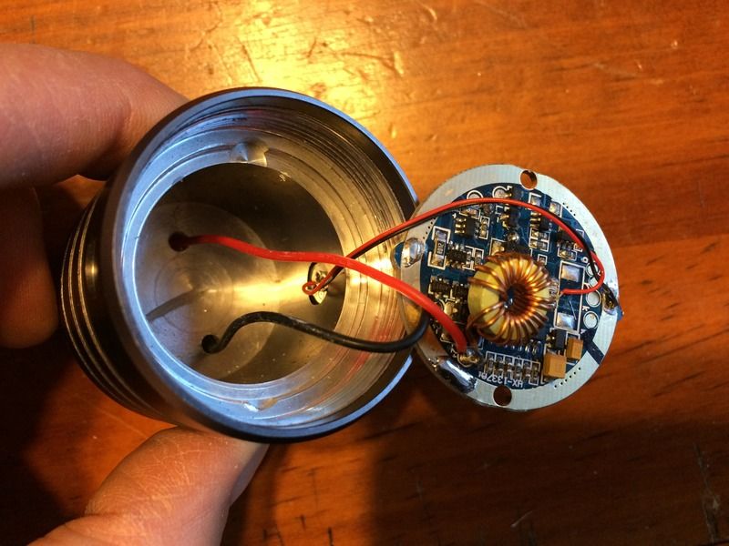

I really wanted to get that drive board out so here’s where I got stupid. I inserted a screwdriver through the negative wire hole of the star platform and wiggled around until I was mildly sure that I was not on top of any surface mount components and pounded the crap out of it until the board came loose.

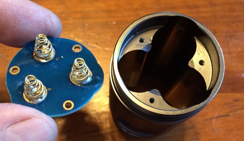

I really don’t understand why this driver board needs to be so complicated. It is only capable of switching to high and then low them off. Repeat. No memory, no flashy modes (thank God) Nothing else.
I pulled up the toroid to expose a chip that could probably launch the shuttle. Somebody smarter than me will need to explain why this thing needs so much intelligence.

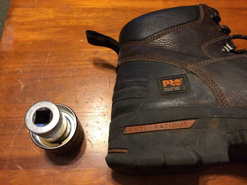

I had a heckuva time getting the driver board back in because it’s such a tight fit. I finally resorted to a socket and a steel toed boot and pounded the heck out of it. It did fit.
Of course you’re all wondering whether this thing even works anymore after I abused the board like that? I can assure you it does. That persistent Blue dot with red Corona in my eyes constantly reminds me that it still works. Yeah, I accidentally hit the switch again right in my eye.

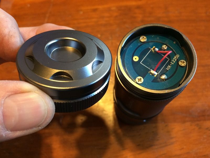

Moving onto the tail cap… Why would they design the board so that it requires a jumper and then, why would they then jumper it with a 26 gage wire?
