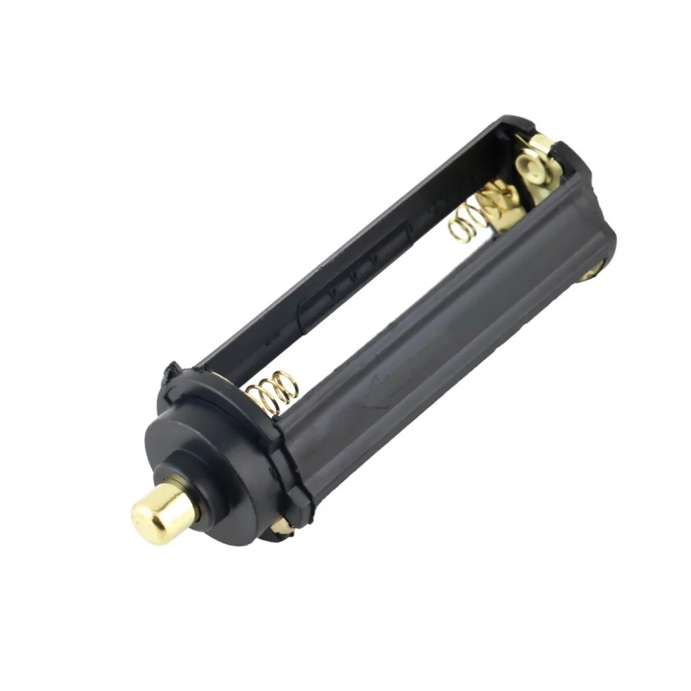

I’ve been using promotional 3 - AAA flashlights with the 9 LEDs / the ones they give at Harbor freight for free… they give a good amount of light for the size.
But I’m noticing that sometimes they may not be as bright as I’d like. I can unscrew the end cap and take out the plastic holder of the 3 AAA batteries and ‘spin’ the batteries in place - just rotate them a bit like a log in the water, put it back together and the light is brighter.
There’s oxidation on the contact surfaces of the batteries and battery holder. I realize that.
Is there something you guys use / recommend to put on the contacts to keep them clean?
And same idea with the threads of the end cap. Just unscrewing / screwing it back on makes the light brighter typically. the body is aluminum I figure.

have a few of those lights, not sure whether a lot of work would be worth it for them. however I would use alcohol to clean the board/springs and good grease for all threads. my board was full with strange stuff I scraped off.

I see plenty of steel springs (high resistance) and other crappy materials in those adapters. AAA cells, if alkalines, have quite high internal resistance. Trying to overcome this may be a waste of time, in my opinion. Clean the contacts with some alcohol, and move on.

Just use silicon grease on the threads and a light coating on the contacts to protect them from oxidising
NO-OX ID is pretty much designed for that. Not the best lubricant (not terrible either) but designed to keep electrical contacts from oxidizing
I don’t think you are having oxidation issue, much more likely it is the result of weak spring and poor contact in these bargain basement lights. All of these lights behave this way. Every pressure point connection in the light is problematic including the switch. When you fidget with it it makes a better connection for a short time. Probably get the same result banging it in various ways on a table.
