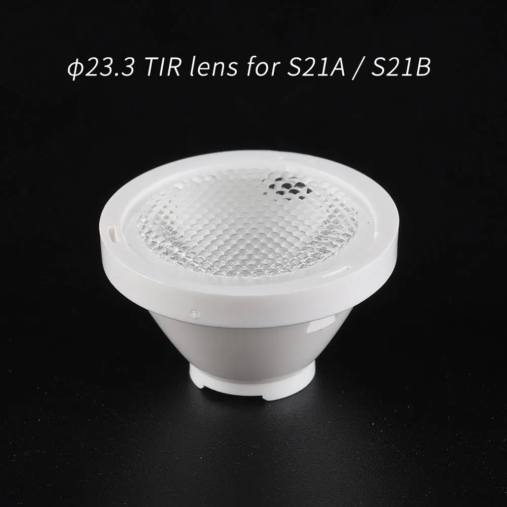

This Convoy TIR for the S21A/S21B might work for you.
It’s 23.3mm wide, the height isn’t listed:
23.3mm lens for S21A S21B with SST40 XML2 XHP50.2 5050 LED
