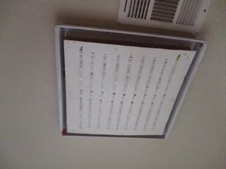

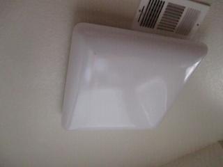

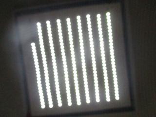

You could do a lot better if you switch out the existing array for an LED array. I had a similar lamp over my kitchen table. It used two U-shaped fluorescent tubes. When the ballast died I switched over to using 12V LED strips. You do need to use an LED driver to convert house current to 12V DC but the conversion would be way less than buying the replacement tubes shown. I’ve uploaded three pictures to show what I did.
I mounted the strips on a piece of coroplast (like corrugated cardboard but made of plastic) but could have mounted the strips directly to the base of the light. If I were to do this today I would use COB LED strips instead. A 5 meter roll costs around $12 and the driver less than $10 on eBay.
