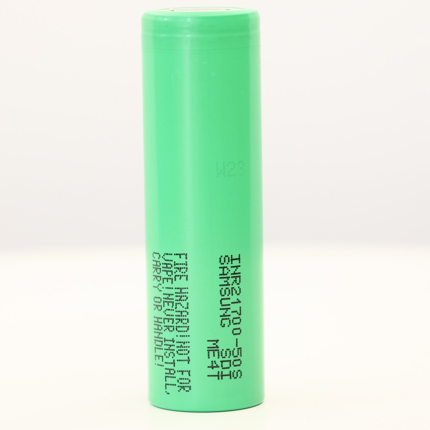

My best 21700 cells (Samsung 50S) only have 5000mAh, but I get fairly inexpensive cells. :money_mouth_face:

Mooch measured the F60. At 5A it has an e-score of 14.2, at 10A 12.9.
As a comparison, a Samsung 50S has 14.3 and 13.7, so even at a mere 5A load the 50S will already run for longer than the F60. P45B has 13.1 and 13.0. Despite only being 5000 mAh (50S) and 4500 mAh (P45B) they both outperform the F60 at 10A.
Maybe in a lower powered light it could show its potential, but in most lights I’d rather grab a 50S, P45B or cheap 50E (14.0, and 12.2, at 5A and 10A, respectively). I would not get it for anything running more than 2-3A through the emitter.

This is where I got my Samsung 50S if anyone wants a store recommendation…
They charge shipping, but even with shipping it’s a pretty good deal, in my opinion. :slightly_smiling_face:
I think that’s one of the best sources in the states. In EU it is nkon.nl. That’s where I got mine. Shipping was rather slow, but price was excellent.

I must have gotten my Samsung 50S cells on sale because I paid $4.65 each, before shipping.
