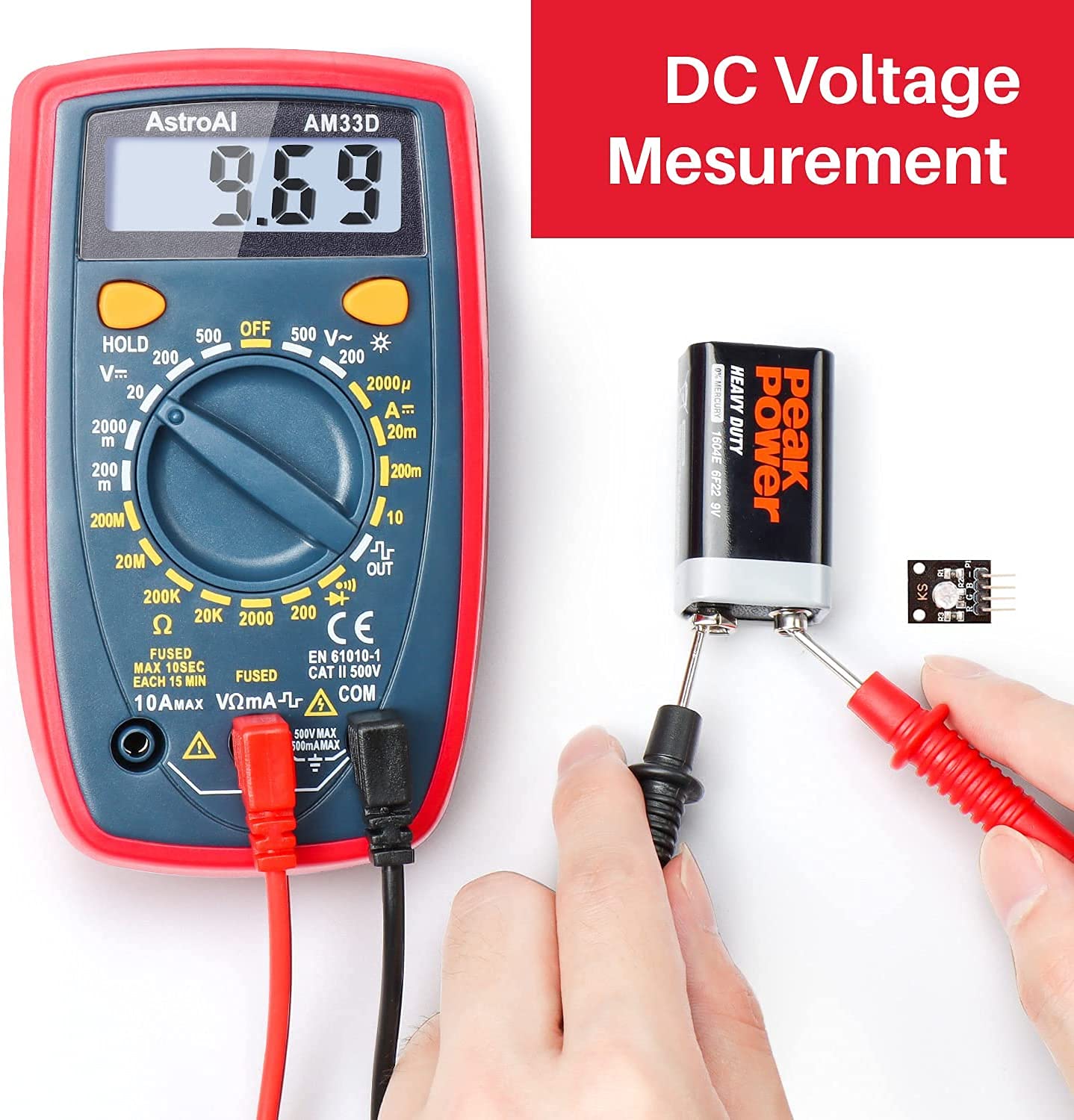

I have the AstroAI AM33D, but I’m not sure which setting could test the IR of multiple 18650 lithium ion cells I’ve collected. This meter was cheap, but I don’t know if it can test the IR accurately or which setting to use. Do you recommend some other multimeter or this one should suffice for this scenario?
It can’t. That’s a regular (cheap) multimeter. To measure the internal resistance of the battery, you need a special meter. Can’t recommend any specific model.
As @SammysHP says, you need a special/dedicated meter for this kind of measurement. A meter that can measure very low impedance and typically uses the 4 wire measurement method.

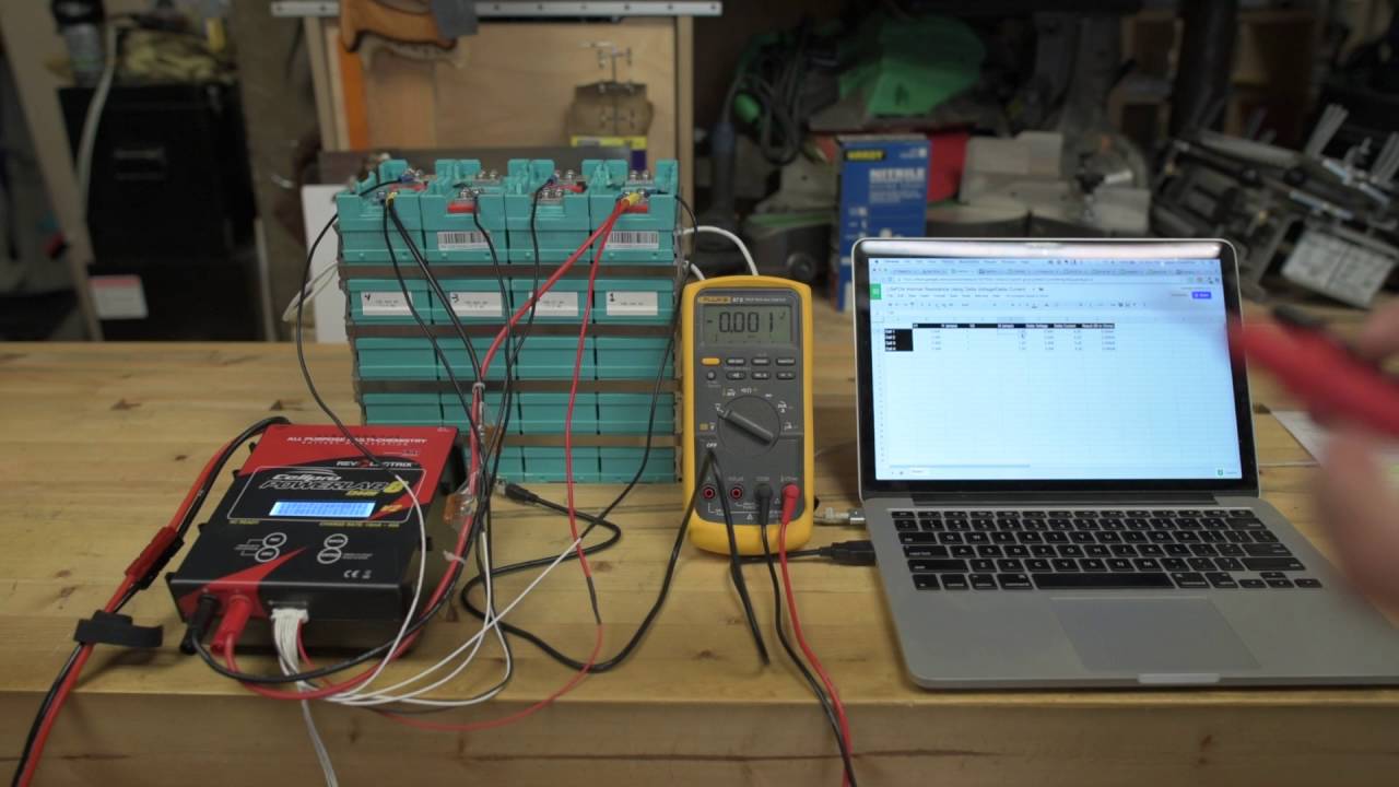

That is the cheapest you know of ???
:stuck_out_tongue_closed_eyes:
We’re very glad to have you here, acebatt1!
Yep – Items I have around the house :crazy_face:
