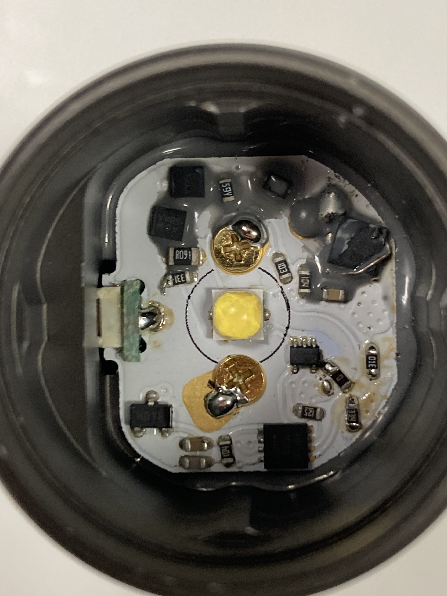

Installed 4000K 90 cri XHP35.2 HI from Kaidomain. I like the tint. I feel like the focus is a little off, because I was expecting a tighter hotspot (especially compared to the SC64w HI). But there aren’t any noticeable artifacts and the beam is generally good aside from that expectation.

New emitter reflowed
SC600 III driver XHP35.2 HI 4000K 90 cri
