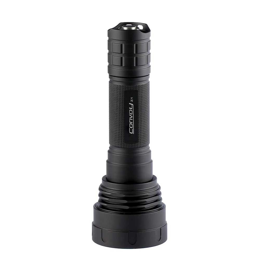

The Convoy Z1 with SFT40 is one of the nicer zoomies you can get that uses a 21700 battery. When zoomed out you will see the projection of the SFT40 led, which is not round, but octagonal, but the thing throws as far as a low-end LEP and puts out a lot of lumens. Zoomed in, it makes a nice clean wall of light.
You can choose other stock LEDs with it, but they will be square when zoomed in (unlike the SFT40), and not as bright as the SFT40.

If I wanted a zoomie with a head that size, I think I would order the Z1.

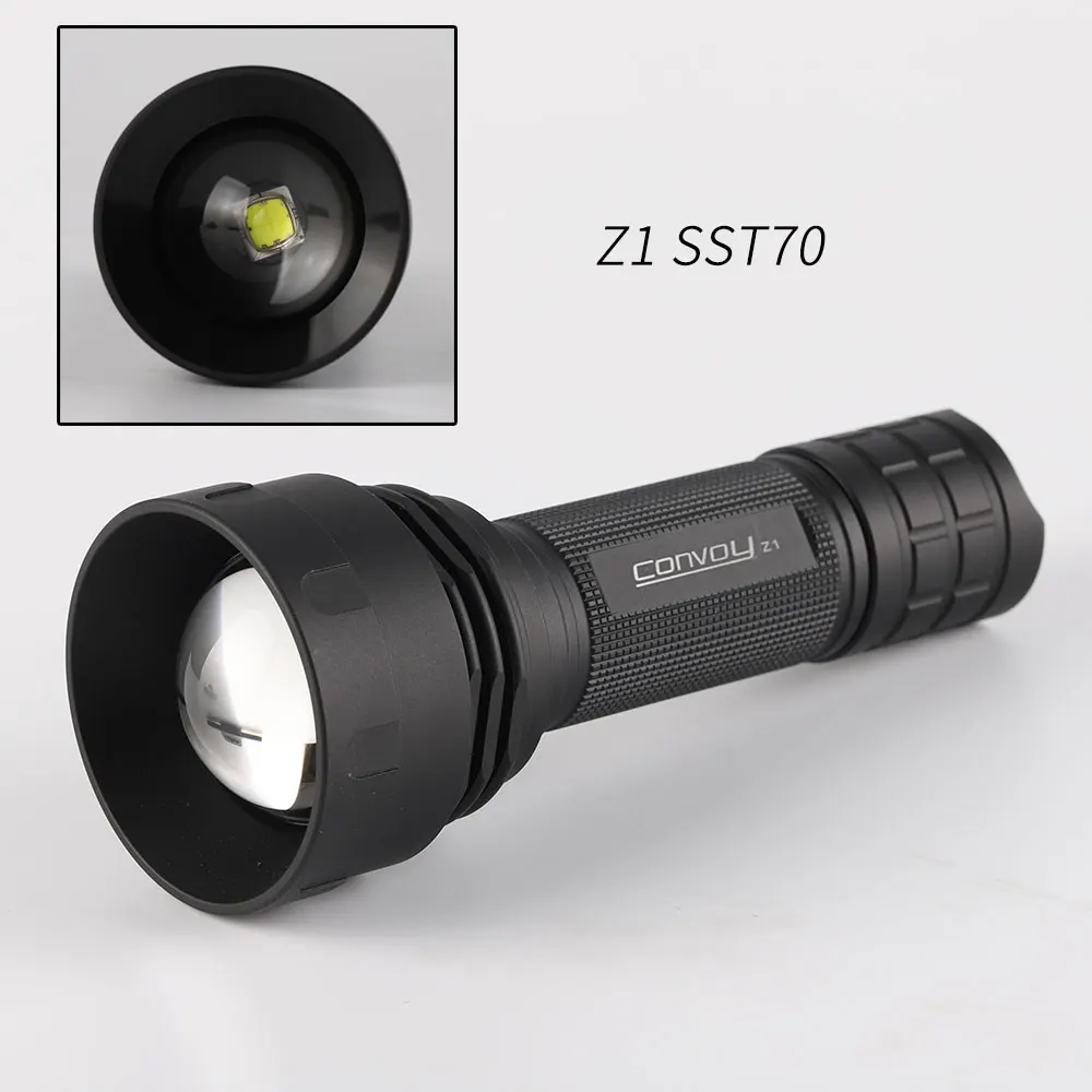

I bought one with the SST40 originally and then upgraded it to the SFT40 which is better (brighter), but also a colder light. I’ve got the 8 Amp driver to swap in but haven’t bothered. You can also get it with the Osram LED’s and SST70. Plus apparently now B35AM and 519A (in the second link.)
It’s great for long distances. I got it to try and work out if it was bats or owls in a tree about 70m from my house at night. My XHP70.2 Klarus G20L didn’t have enough throw to light them enough. Get a decent battery too, I made the mistake of buying the default Lishen with it. It’s a lot better with Samsung 40T batteries.
Originally I bought the SST70 version of the Z1. Then I kept seeing people saying good things about the SFT40 version, so I got one… and the SFT40 version was way more impressive. It just throws much better and looks nicer when focused with a much more intense hotspot. When flooding, it didn’t really lose much brightness over the SST70 version.
I did actually take the SST70 one I had and swapped in an XHP70.3-HI 5000K (90 CRI) into the thing… so far, that is my favorite version (but the SFT40 one does throw much better and of course you can get it stock). ![]()

Interesting regarding the SST70 vs SFT40. I’ve got a XHP70.3 HI sitting around on a smaller board (16mm?) (Not that the size would matter given how the LED board is retained.) I’d need a 6V driver though… Has your SFT40 version got the 8 Amp driver in it?
Mine is a modded Milwaukee metal flashlight for long runtimes.
I thought the stock SFT40 version uses the 6a driver just like the SST40 version (but I haven’t ever checked, actually)? The XHP70.3 and 6v5a driver (which was just a rebranded Convoy one) I salvaged from a Pioneman light, and I drilled out that black retaining ring so that the plastic spacer over the LED would fit through it… First one I didn’t use the plastic spacer, and… that LED started smoking and melting. Learned my lesson on the second one.
Edit: Just checked, and based on pics, my SFT40 appears to be 8a driver.
